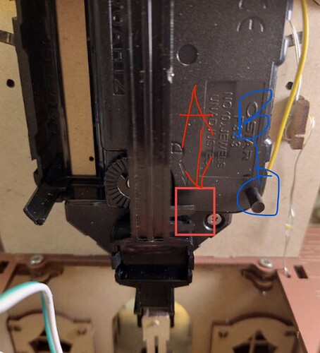

I have build the Rokr Cuckoo clock a few months ago and it was working perfectly fine. However, recently I started to notice a clock making loud clicking/tapping noise. And I have seen it happens to a few members recently. What happen is the pendulum was swinging too hard.
So this is what I meant. So let’s look at the photo below.
When the pendulum swing, part A (in red) will slightly stopped by part B (in blue). When it just swing gently you don’t really notice the noise. However, for some reason overtime it swing harder. When part A touches part B too hard it will produce the noise.
Some member have tried trimming part A or B but I was thinking this might not work for long term.
So what I did to fix it is i glue a piece of small fabric or foam to both part A and B to create cushioning for both parts when it comes into contact. And I was trying to fix this through the holes without having to take anything apart. It is a lot easier and it works really well. The pendulum now swing freely without any noise at all.
If you have this problem, you can try this.
You can even try this before assembly to make it a lot easier if you want to prevent the noise from happening rather wait until it’s all done and the noise become annoying.
I should do a before and after video that capture the difference in the noise but totally forgot about it.
I hope this tips will help you fix this issues easily without any problem and not having to wait for the replacement part.

Oh I haven’t built this but it’s definitely on my list so this will be helpful! I’m assuming the photo you have is a before photo? Unless I’m blind and I don’t see it. :laughing:
Can you add a photo of the foam attached? :blush:
That is just the before photo so people know what I am talking about. I’ll try to take the after photo so you all know what I meant.
