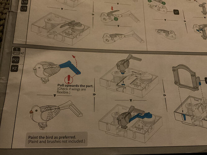

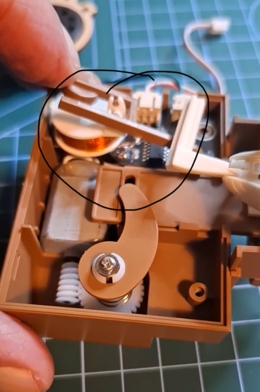

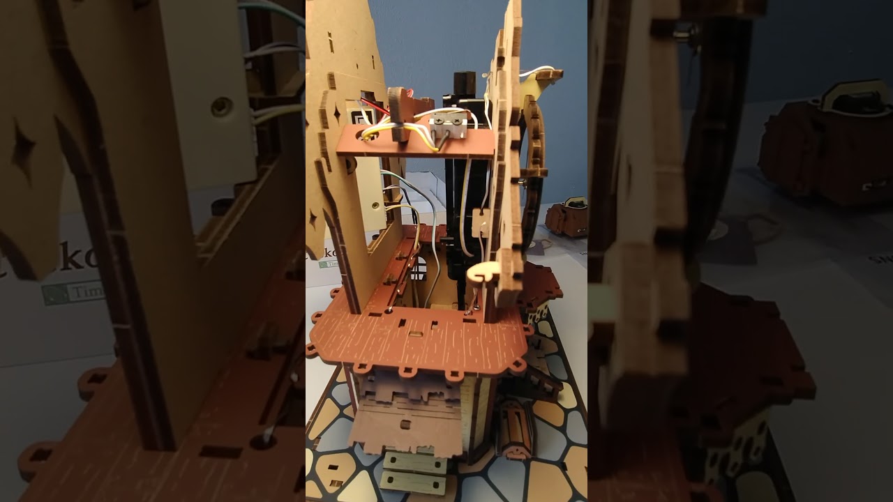

1. The Cuckoo “Sings but Won’t Come Out”: Prioritize Structural Checks
In the thread by VasileNedelcu , the user describes a common symptom: the cuckoo sings three times but fails to move out of its house, producing only a slight “click” as if attempting to move but getting stuck.
Key Troubleshooting Sequence (Essential):
:white_check_mark: Tip 1: Check Springs & Metal Connecting Rods First
As pointed out by jeanneL , the internal spring should be fully compressed and correctly installed, and the metal arms at the bottom should be properly positioned. She also recommends testing with only USB power to avoid battery interference.
She wrote:
“Make sure that spring inside was placed down securely and correctly. Check those metal arms on the bottom by windows.”
(jeanneL, Cuckoo sings, but doesn’t move from the Bird’s House)
Following this, CustomerService offered a more precise technical insight:
“The jamming is most likely caused by the metal connecting rod.”
(CustomerService, Cuckoo sings, but doesn’t move from the Bird’s House)
The official advice is to temporarily remove the metal connecting rod and test the cuckoo manually. Once smooth, reinstall it and identify the point where it jams. This method has been validated by multiple community members. :people_holding_hands:

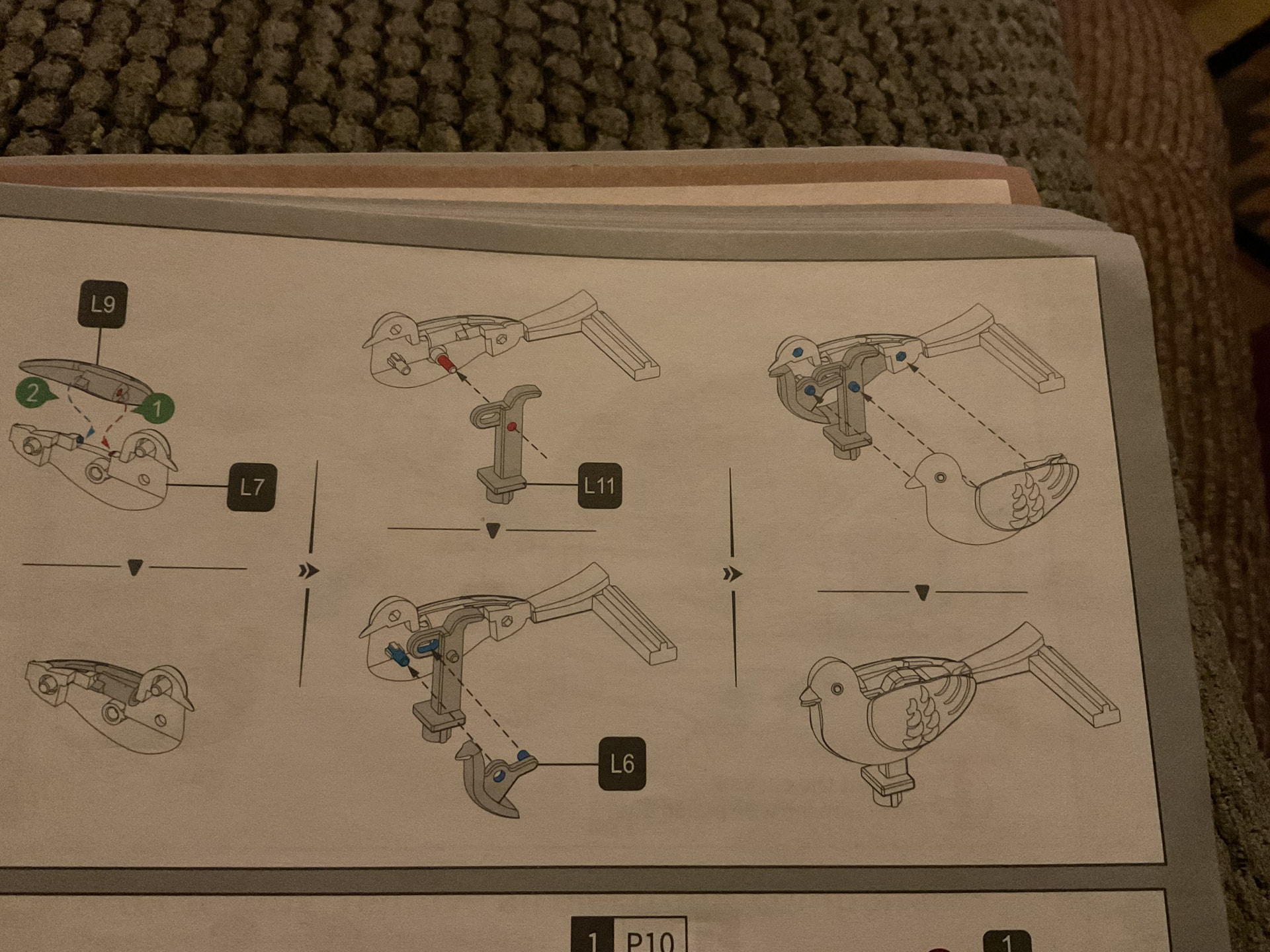

:white_check_mark: Tip 2: Align the Cuckoo Body Correctly
@jeanneL also noted that misalignment of the cuckoo body or wings showed by @ThaoNguyen not fully opening, possibly due to L6, L8, and L11 parts not seated properly, can cause slight jamming. (jeanneL, Cuckoo sings, but doesn’t move from the Bird’s House)
In other words, this is rarely an “engine power” issue, but rather a geometry problem affecting the bird’s track. @VasileNedelcu later confirmed that checking the “Inside the Nest” revealed structural misalignment as the root cause.
:white_check_mark: Tip 3: Use USB Power for Testing, Avoid Batteries
Multiple posts stress that during testing, only plug in the USB-C cable and avoid installing batteries (Tricia12, same thread). Simultaneous power from USB and batteries can lead to irregular motor behavior.
Core Conclusion: About 90% of cuckoo movement problems stem from structural assembly precision rather than electronics.

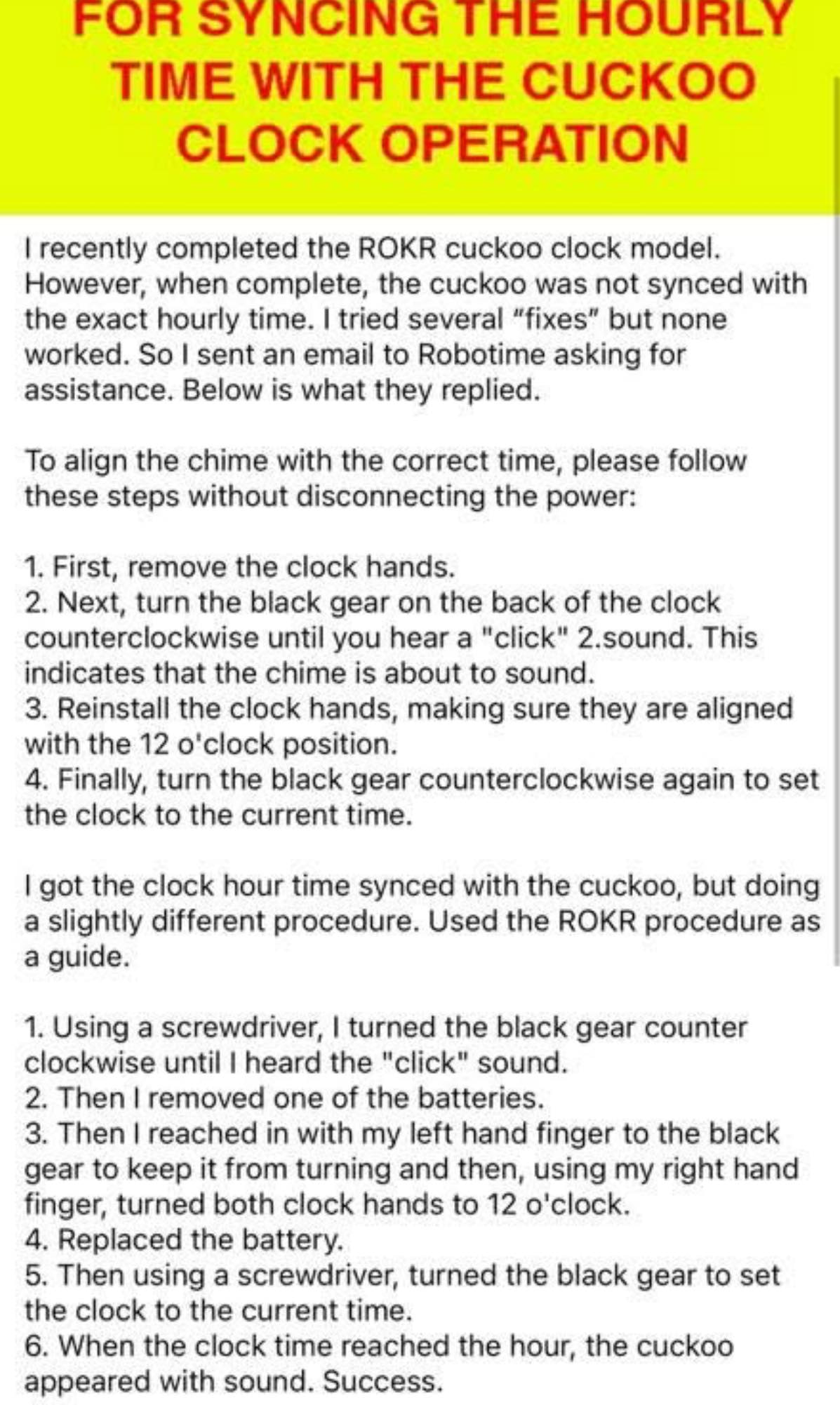

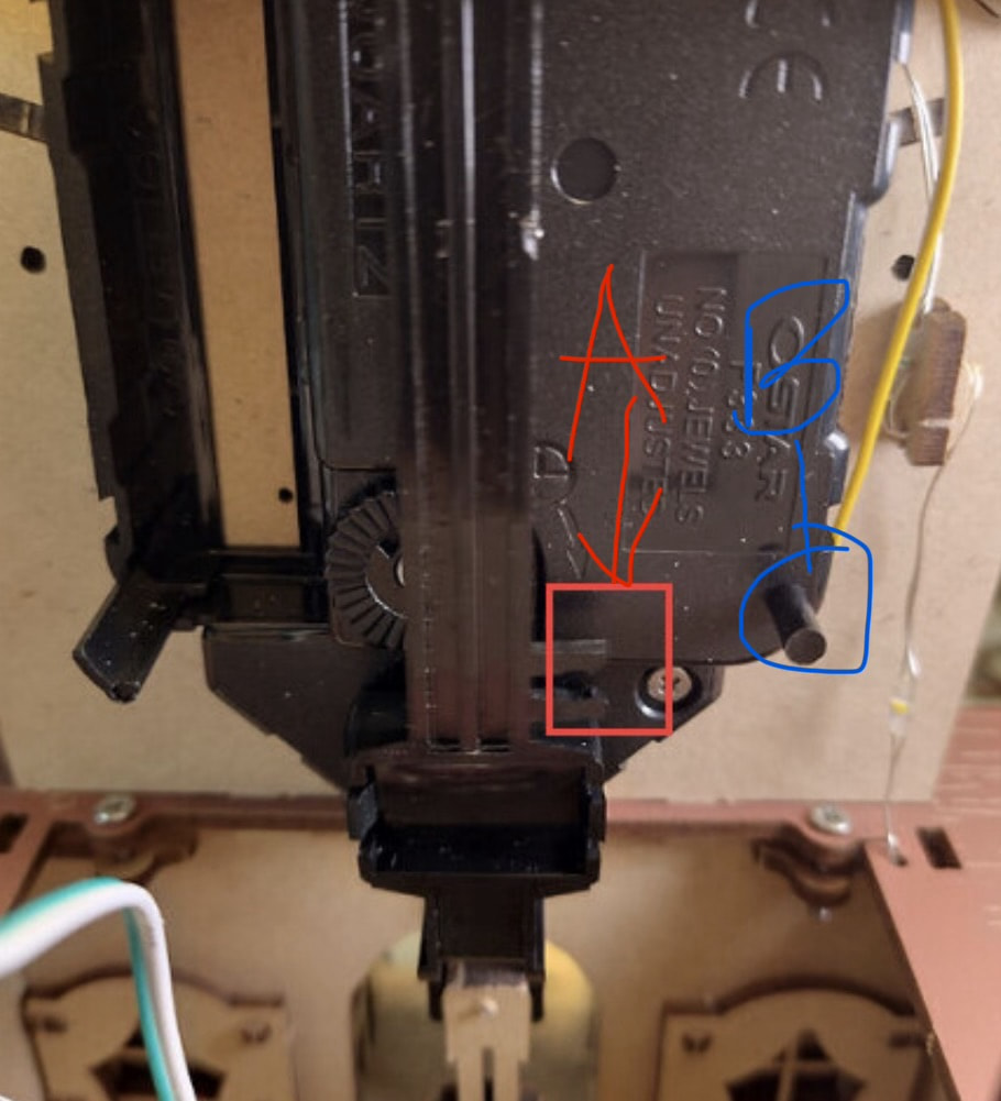

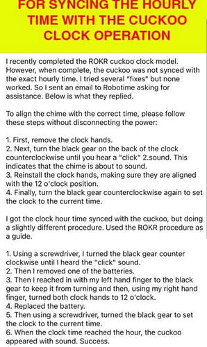

2. Hourly Chime Off: 45-Minute or Half-Hour Issues
Some crafters experienced chiming at 45 minutes @wilson_murillo_monte or at half-hour intervals @Janine_Thompson, instead of the exact hour. The official synchronization procedure focuses on finding the trigger point via the black gear and then resetting the hands.
Standard Procedure:
  • Remove hour and minute hands without disconnecting power
  • Turn the black gear on the back counterclockwise
  • Listen for the “click” (indicating the chime is about to trigger)
  • Place the hands at 12 o’clock
  • Turn the gear to the current time

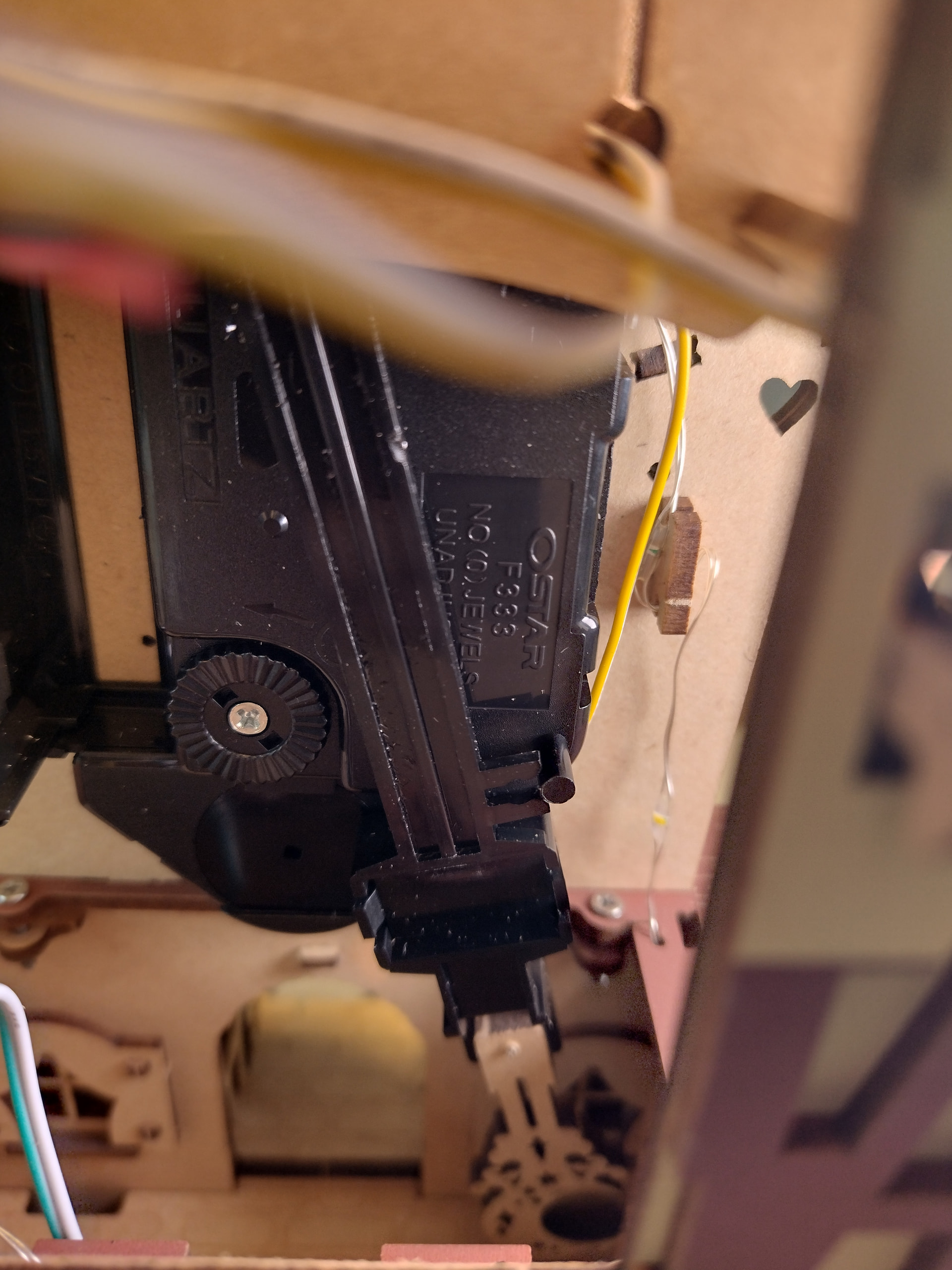

@Nita_Davis optimized this further:
This approach successfully synchronizes the clock and has received many community endorsements. :two_hearts:
These discussions have evolved beyond the instruction manual, forming a more stable community standard method .

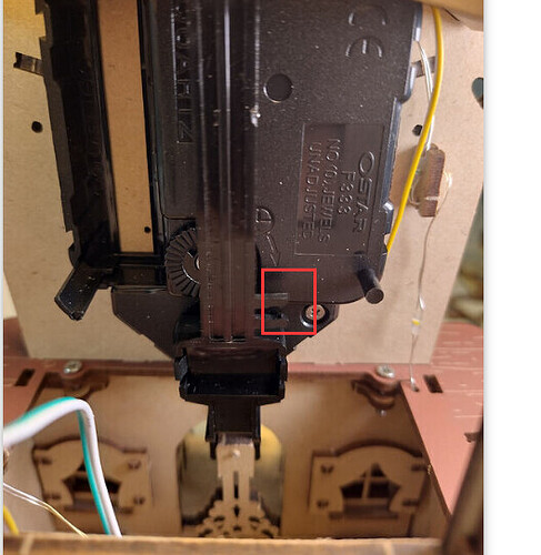

3. Pendulum Noise & Over-Swinging: Electromagnetic Energy Control
Symptom: The pendulum begins swinging gently, but after a few seconds, the amplitude increases and hits the left or right stops, producing a tapping sound.
:white_check_mark: Tip 1: Add Soft Cushioning (Highly Recommended)
@Tricia12 analyzed the collision between part A of the pendulum and the stop B, noting that over time the swing amplitude increases. Instead of trimming the stop, she added fabric or foam to create cushioning:
“I glue a piece of small fabric or foam to both part A and B to create cushioning.” (:+1: [Pro Tips] How to fix noisy pendulum from cuckoo clock)
This allows adjustment without disassembling the clock, working directly through the holes.

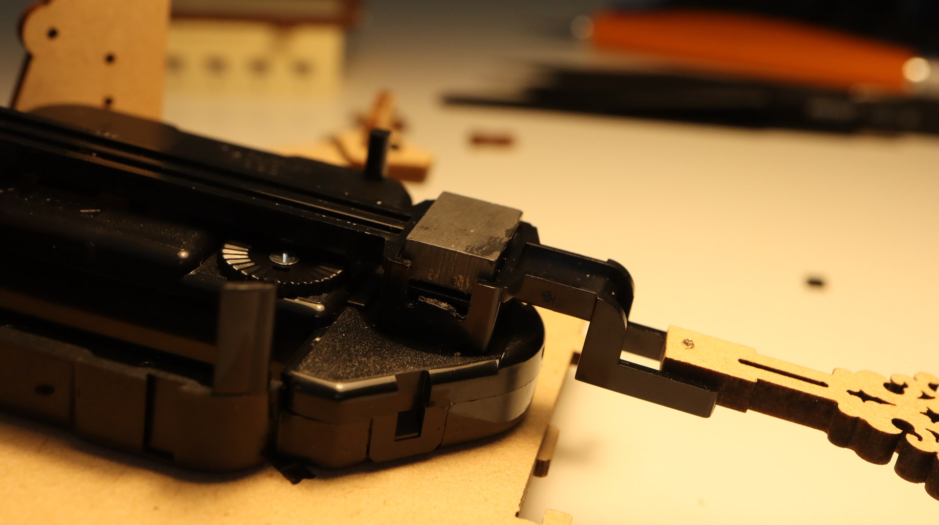

:white_check_mark: Tip 2: Adjust Magnet Position to Reduce Electromagnetic Energy
In this thread, @Rod_B suggested that the noise was not purely mechanical, but rather caused by excessive energy from the electromagnetic drive. He carefully removed the pendulum magnet, reversed its position, and increased the distance from the coil to reduce the energy input:
“Now the magnet is further away from the clock body thus less energy is transferred to magnet.”
(Rod_B, original post)
@CustomerService confirmed the issue was reported to the design department for optimization, showing that this is both a mechanical and electronic design discussion.

:white_check_mark: Tip 3: Fine-Tune Clock Orientation
@Jeff_Podraza also noticed that the clock body has a bit of rotational give, and a small clockwise or counterclockwise adjustment was enough to shift the pendulum’s trajectory, stopping it from striking the side wall and noticeably reducing the noise. (Jeff_Podraza, Cuckoo clock pendulum noisy)
:white_check_mark: Tip 4: Add Weight to Reduce Swing Amplitude
One hobbyist shared that after experimenting with different fixes, they added a small amount of weight to the pendulum. This reduced the swing amplitude and minimized the impact noise.
(Discussion reference)
While this approach can effectively limit excessive movement, it’s generally seen as a workaround rather than an ideal long-term solution, since altering the pendulum weight may affect the balance of the electromagnetic drive system.

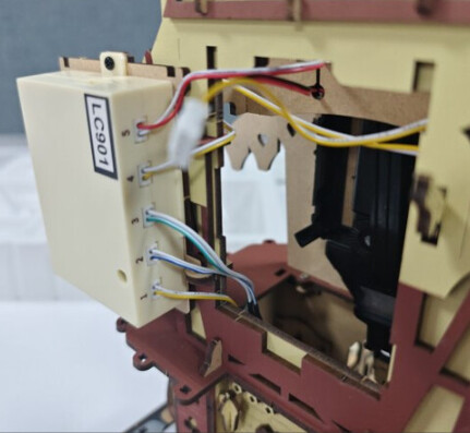

:white_check_mark: Tip 5: Check Power Configuration and Connections
If the pendulum slows down or stops intermittently, first make sure you are not using batteries and USB power at the same time, as the clock prioritizes battery power. Testing with USB only is recommended. (Oroblem with pendulum, sonra)
Customer Service also suggests unplugging and reconnecting the pendulum wire at the back to ensure a secure connection. If the issue continues, the pendulum module or battery box may need replacement.
4. Minute Hand Doesn’t Move but Second Hand Works: Movement Mechanism Issue
@rrf1982 reported that while the second hand moved perfectly, the minute hand did not advance automatically. Manually turning the back dial showed smooth transmission, indicating the mechanism was not jammed. (Cuckoo clock finished – minute hand not working)
Most issues in this category were eventually traced to the clock movement or circuit module. For example, @JVC tested a friend’s circuit board and confirmed that the fault was in their own unit.(Cuckoo clock bird wont come out).
Customer Service suggested first removing the batteries and testing with USB power only to rule out power-related interference. Follow-up replies show that replacement parts were sent efficiently and responses were prompt.

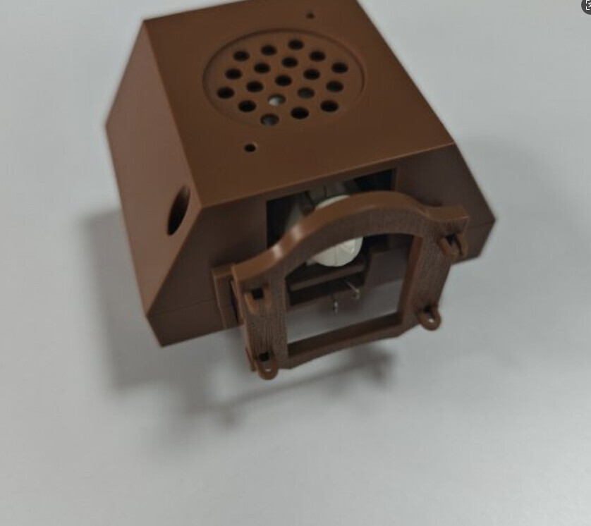

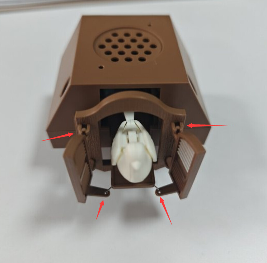

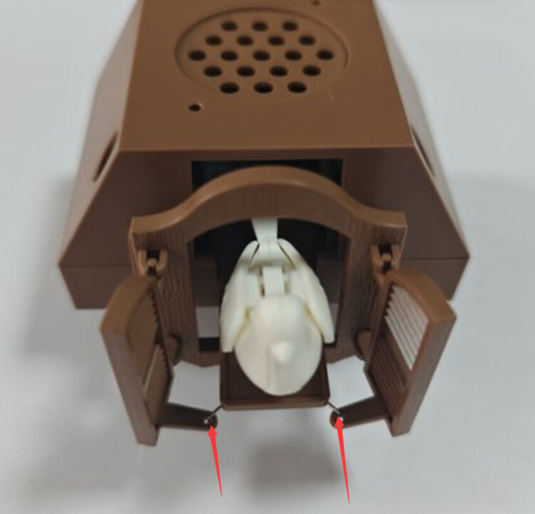

6. Bird Cage Doors Not Returning
If the cuckoo doors stop midway when closing, first check that all door parts move smoothly by hand. (“Bird Cage” thread,sonra)
  1. Remove the door panel and test the clock’s response to confirm the issue isn’t with the main mechanism.
  2. If the clock works normally, the problem is with the door rods.
  3. Reinstall the door body, then manually open and close the doors several times to ensure the connecting rods are properly seated.
  4. Make sure each rod can move freely on its own without pushing or pulling the other.
Once aligned, the doors should operate smoothly, allowing the cuckoo to enter and exit without obstruction.
