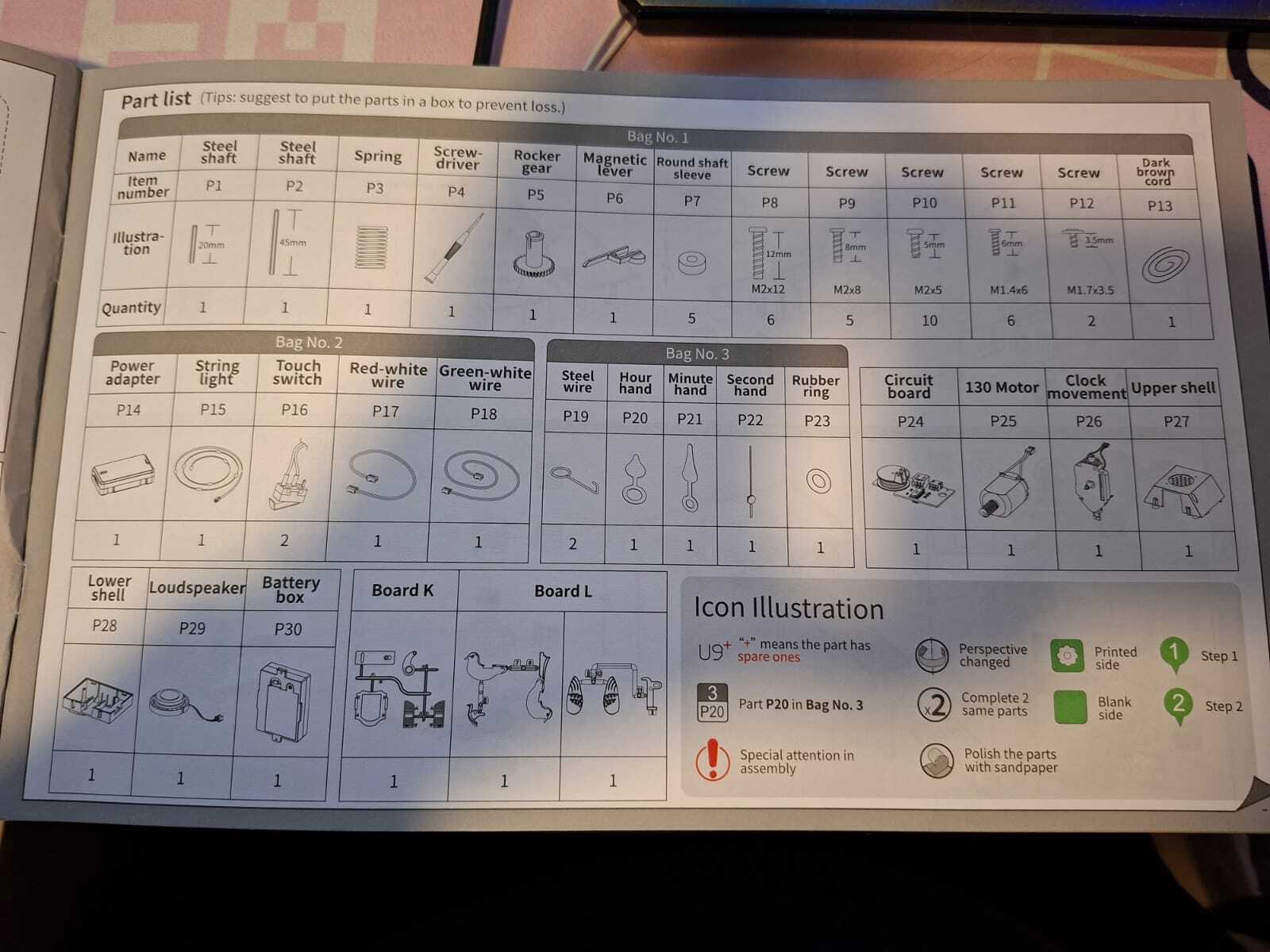

Hi @KMG! I built the Cuckoo Clock recently and right now I’m not sure which piece you’re referring to. I’ve been checking my instructions and I didn’t have any rectangular “weight.” In fact, on the pendulum mechanism there’s only the crescent-shaped piece attached at the end with a screw.
Could you share a photo so I can see which piece you mean? That way I can get a clearer idea and try to help figure out what it might be.
That was all I could see as well. Now I did find a small rectangular magnet. Unsure where it goes as I found it after I was cleaning up fro: clock. Was never sure what it went to. But someone had posted a picture of it and was asking questions about it.
Yes, that’s the item I mean, and I discovered it is magnetic. I can’t think why it should be magnetic, but because I assume that a part included in the kit must have a purpose, and it’s the same size as the compartment near the bottom of the pendulum, I have to assume it fits there. So, I’ve glued it in place with a tiny dab of superglue. I’m pretty sure the pendulum is merely aesthetic so it shouldn’t really make a difference, apart from giving the pendulum a tiny bit more mass, so making its movement smoother. There is the option on the last page of the instructions to lock the pendulum off to one side, instead of leaving it free to swing, so this also suggests that the pendulum is just for effect. I’ve nearly finished the clock, so I’ll find out later. The cuckoo and lights etc worked fine at the ‘test’ stage, so hopefully it’s all good. I’ve only got the little attic window to go. The clock itself looks fantastic!
I discovered the magnet later after clock is built. But maybe that is why I cannot get cuckoo to go at the hour. I have reset and it is late. I will have to dig through a bit. If I find out somewhere that it is important, I will let ya know!
