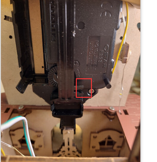

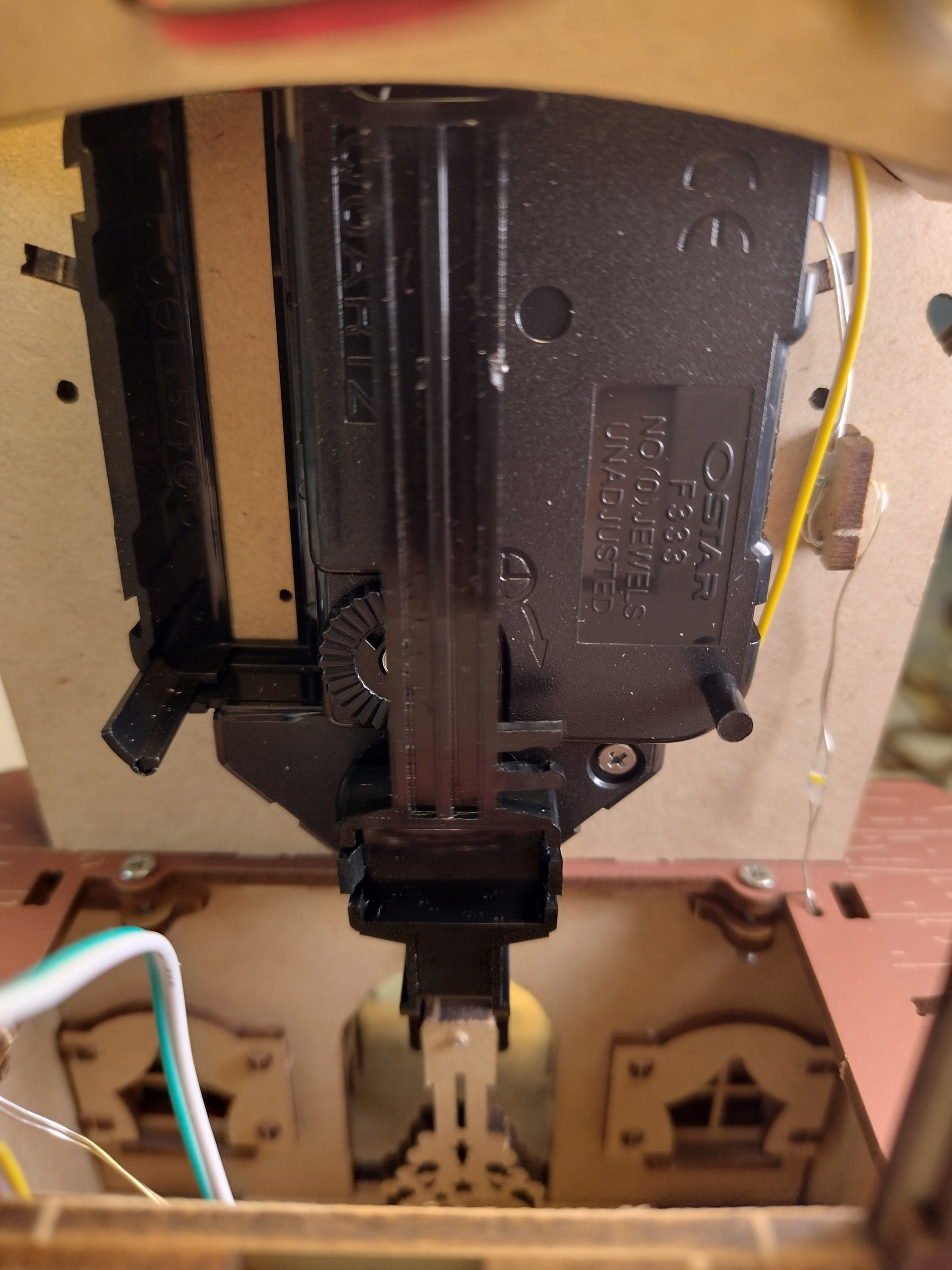

I have included some photos of installation.
The model is perfectly level.
The second image shows where the pendulum hits the l.h stop.
Just to add, as the pendulum starts it swings cleanly but over a period of a few seconds the swing becomes wider and then collides with the l.h stop. Without power the pendulum swings evenly without issue. When powered it appears the pendulum becomes over excited by the electromechanical action.

Hello! You can try trimming this part with a pair of pliers.
I have have trimmed over half of that peice off and knocking returned but took a bit longer to start.
If I remove all of that peice I wont be able to disable or dock the pendulum and no guarantee that this will fix problem.
I decided to remove that peice completely.
Now the pendulum can fully sweep to the l.h side without hitting.

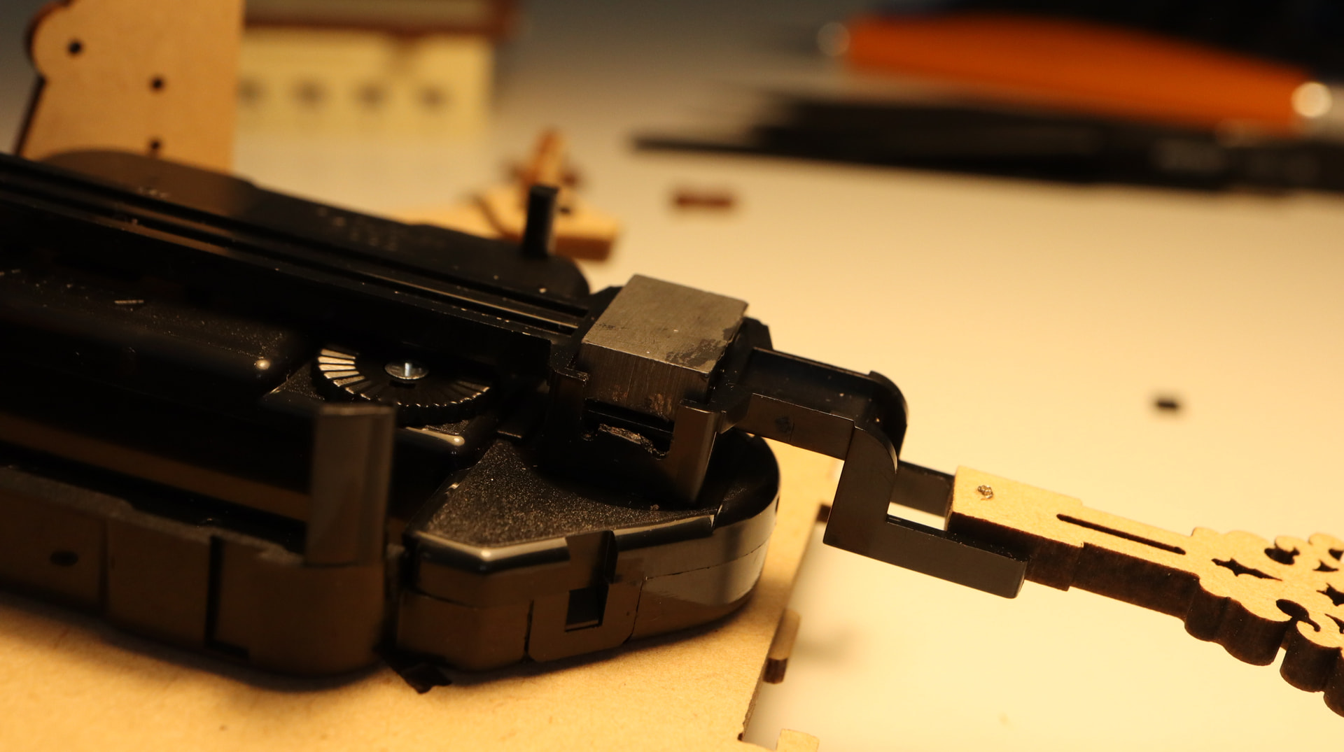

I carefully removed the magnet and it’s plastic cover and reversed the assembly as shown in attached image. All parts secured by epoxy glue. Now the magnet is further away from the clock body thus less energy is transfered to magnet. Just enough to keep pendulum swinging.
Now the arc of the pendulum is reduced and doesn’t hit the side stops anymore. Not a perfect solution but now I have a quiet although partially finished cuckoo clock.

That was what I experienced. My solution was as shown in the image above.
Now my pendulum swings gently within it’s correct arc.
It was quite difficult to remove the pendulum magnet as is it glued into the recess at the base of pendulum. I had to do this with the clock mounted inside. But much easier to refit.
