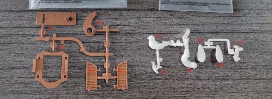

I have just started building the ROKR Cuckoo Clock. I got to the point of testing the cuckoo and it makes the sounds and tries to push out the bird. However, the actuataor for the doors slips. It looks like the cog that connect to the motor spindle is fine. However, the spring doesn’t seem to be strong enough and the actuator just slips rather than pushing the bird out and opening the doors. Has anyone else had this problem?
I did build the cuckoo clock and had no real issue. I do remeber someone saying that you need to really push that into place by the spring. I think it was on page 3. I dont know if that will help. @Robotime any other ideas?
Thanks. I didn’t have the spring over the ring on K3. I have now done thjat and it works better. Most of the time it pops out but occasionally it doesn’t. Sometimes the doors don’t fully shut. Is that to be expected?
Mine seem to but I will take a closer look
In the end I put a small thin piece of self sticking rubber under the spring on part P5 above the cog. This stopped the spring from slipping at the bottom and now the bird works perfectly.
