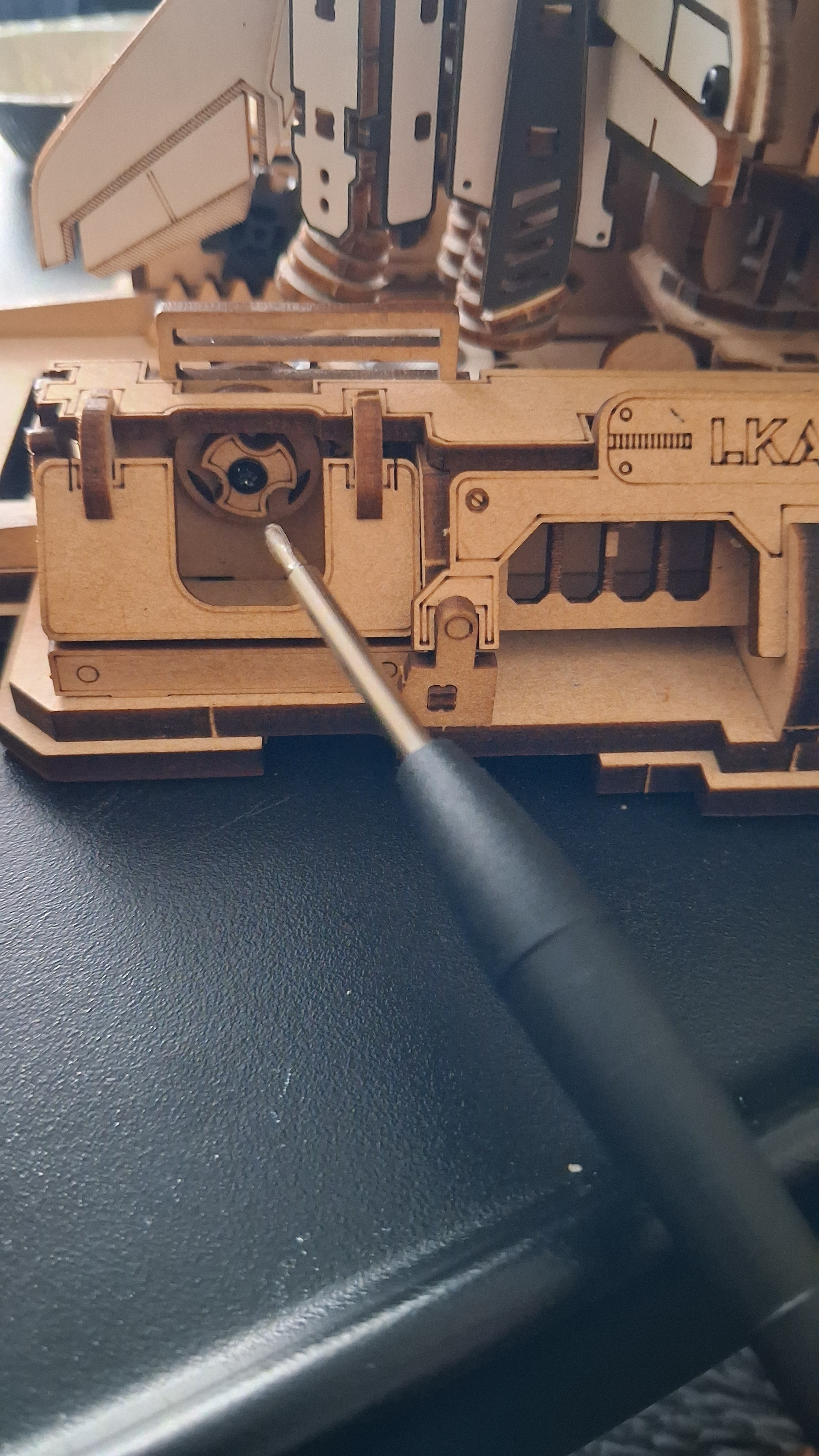

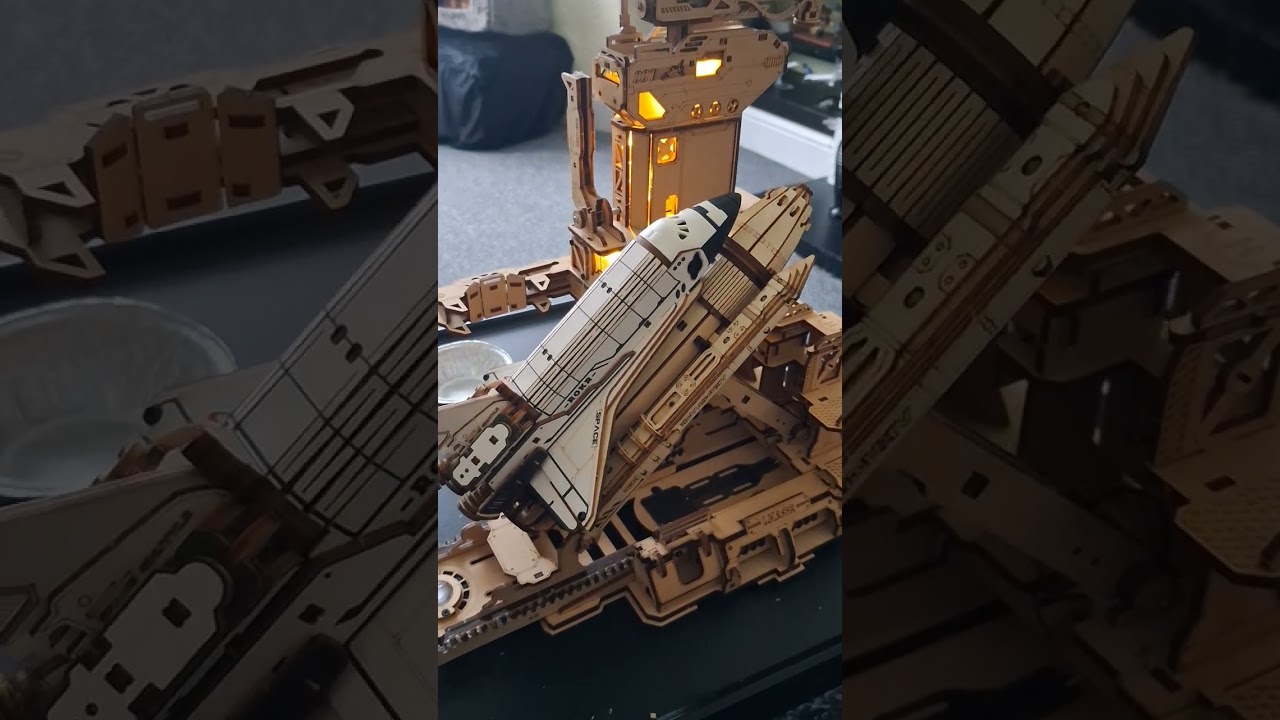

My space shuttle gets stuck and stops. It’s like the slider bit is to wide.
Did it work fine when testing it during building it? I haven’t seen this error before so no idea what is happening here.
I can tell that you waxed the gear ‘teeth’ but did you also wax the sides of those pieces where wood rubs against wood?

Hello! Based on the video you provided, it seems that the plastic gears may also need a little lubrication.
Thanks everyone for your help I figured it out in the end. This screw needed losesening by half a turn now it works perfectly.ive really enjoyed building it,i will definitely be getting more models in the future.
