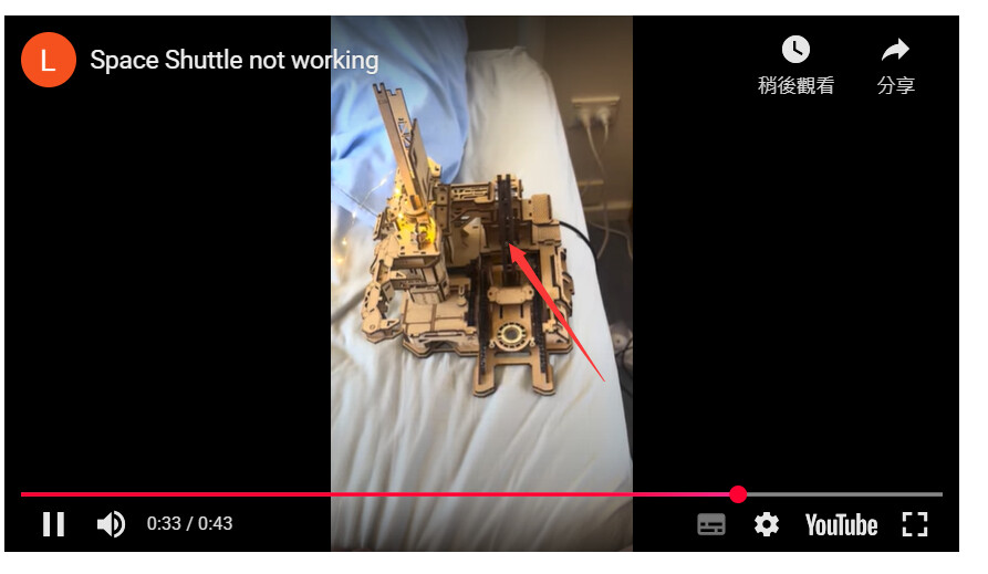

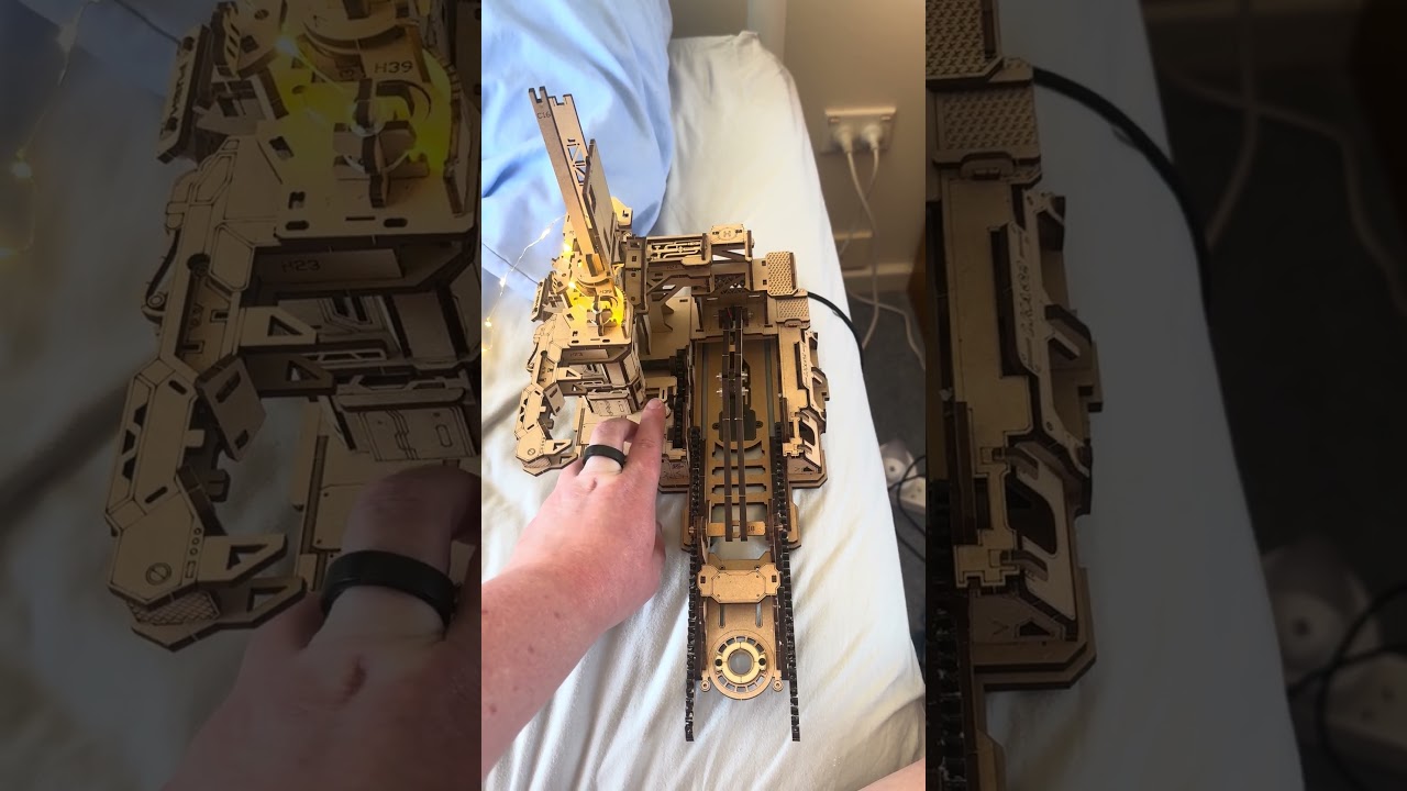

when I first did my 2nd power test I thought it all worked perfectly - until I got further on and nothing worked anymore. So I stripped it back and realised that while the shuttle part extends and retracts, the arm goes out but never returns, and the tall bit against the lever never resets. I can do it manually but not if I want to continue building..
Any ideas how to fix this?
Try inserting part C14 during the test. Let me know if that does not help. Also, video shows nothing.
No the arm up the top of the tower that swings out.

Install part c14 on top of the part that slides out. It pushes the switch behind it and then the arm comes back.
Hello! C14 must be installed to trigger the T3 switch and then stop the operation. You have not installed C14 .

Thank you everyone!! The C14 piece did the trick!!
