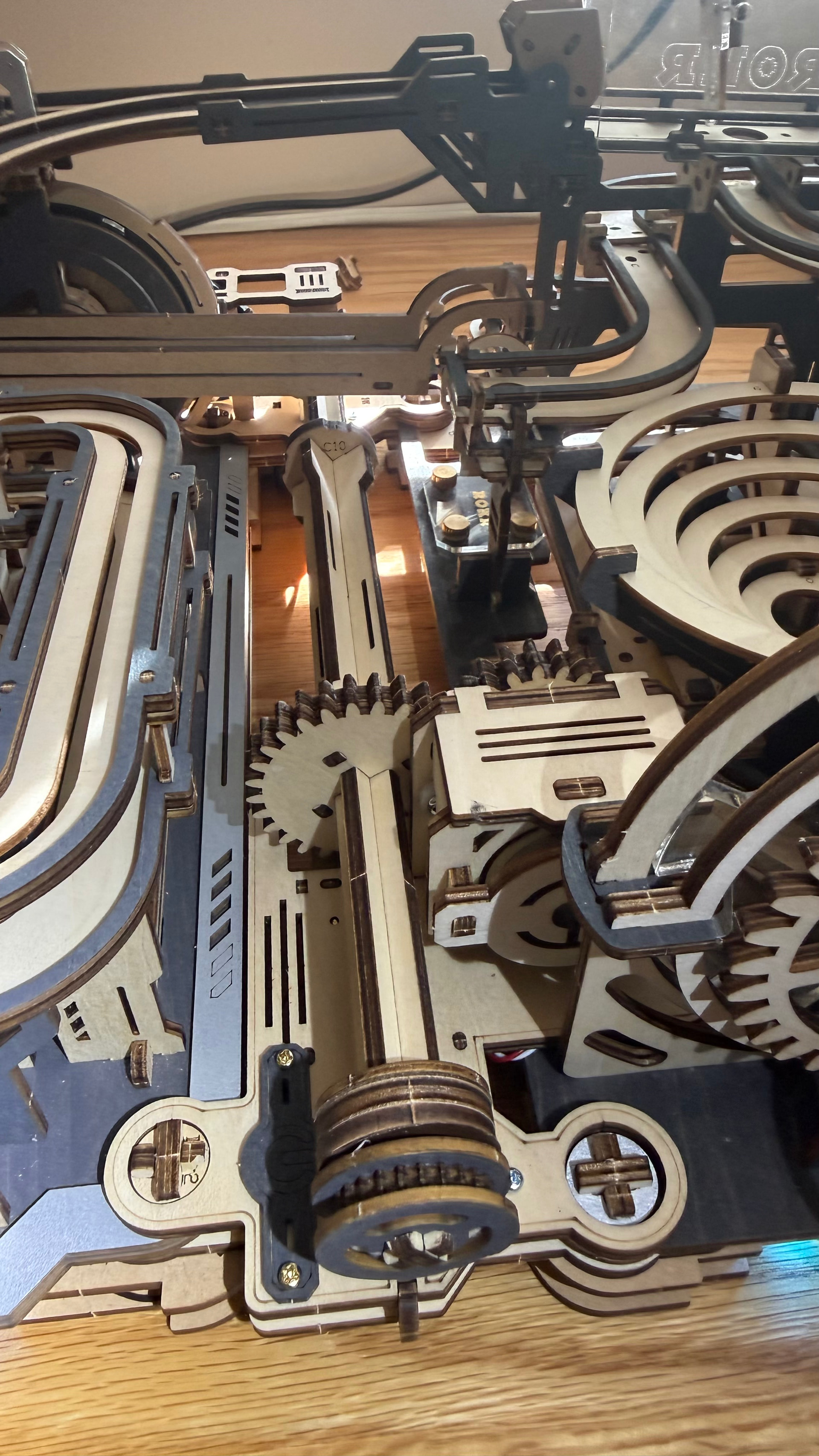

Thanks for the tip! I just removed both belts. In the picture, there’s a belt at the nearer end and back at the other end too. Both are off. The gears are still engaged, but the two belts are off. I can turn the whole assembly with my fingers, though it feels stiff because it’s working to turn several wheels and I realize that when I turn the gears manually, I’m working to turn the lifeless motor. In any event, following your advice, the belts are off but the motor still does not run. Only the lights go on. Thanks for any additional help you might have.
