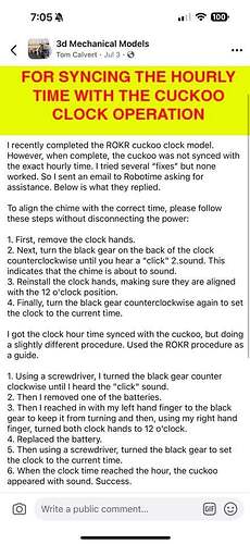

I hope this might help.
My problem is that the click doesnt cause the cuckoo to chime at all.
