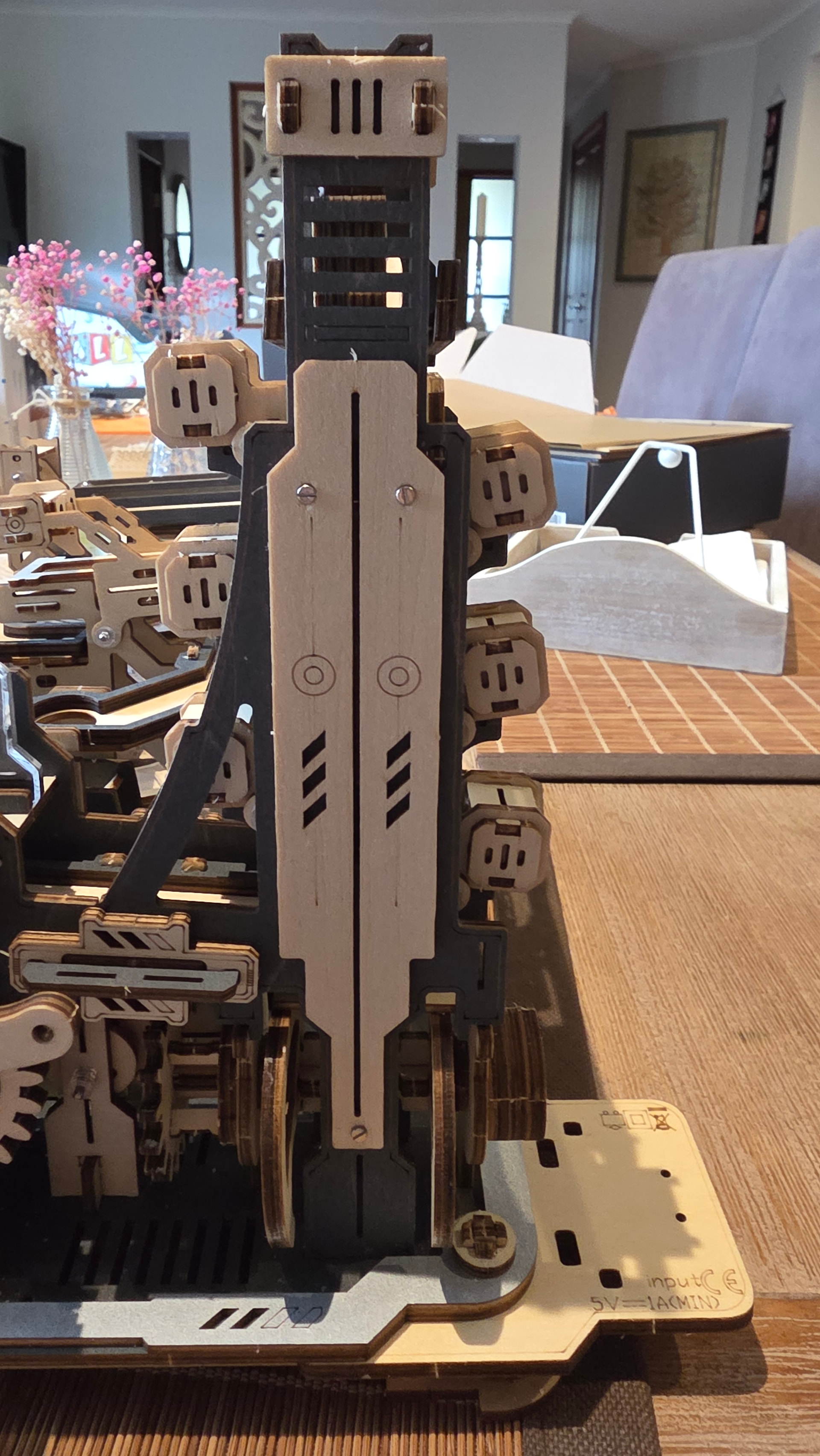

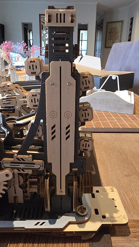

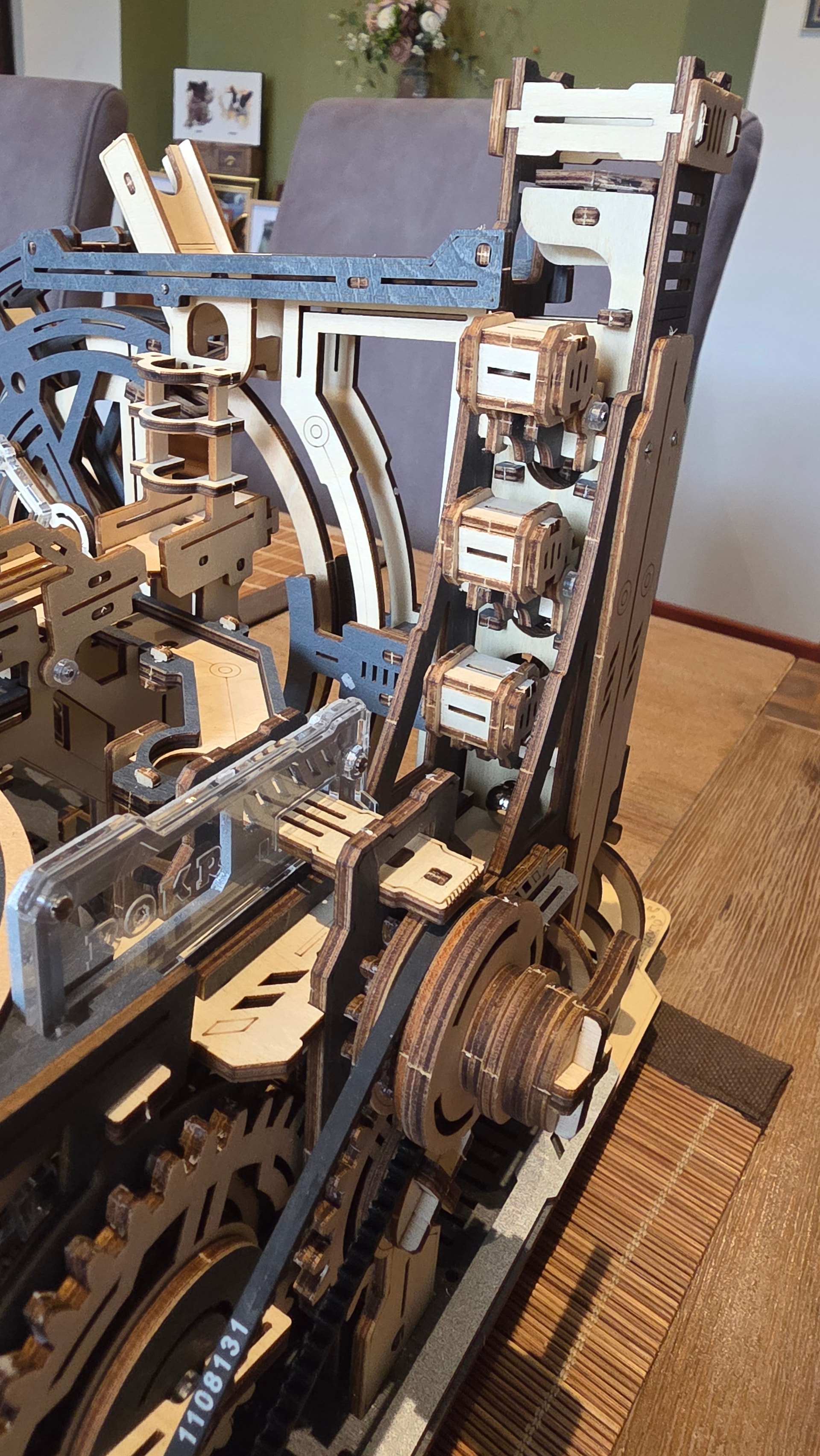

Like a few others here, I am having an issue with the lift mechanism in the Spaceport. I have linked it together with Marble City but even before that, it wasn’t lifting the balls to the top.
What appears to be happening is the balls go into the hole but then as the lift moves up, they get pushed out again so they don’t seem to progress.
If I tilt the little carriages back that hold the ball then they will move to the next level but without that, they all just get jammed.
And like everyone else has shared, the lift is much slower once linked.

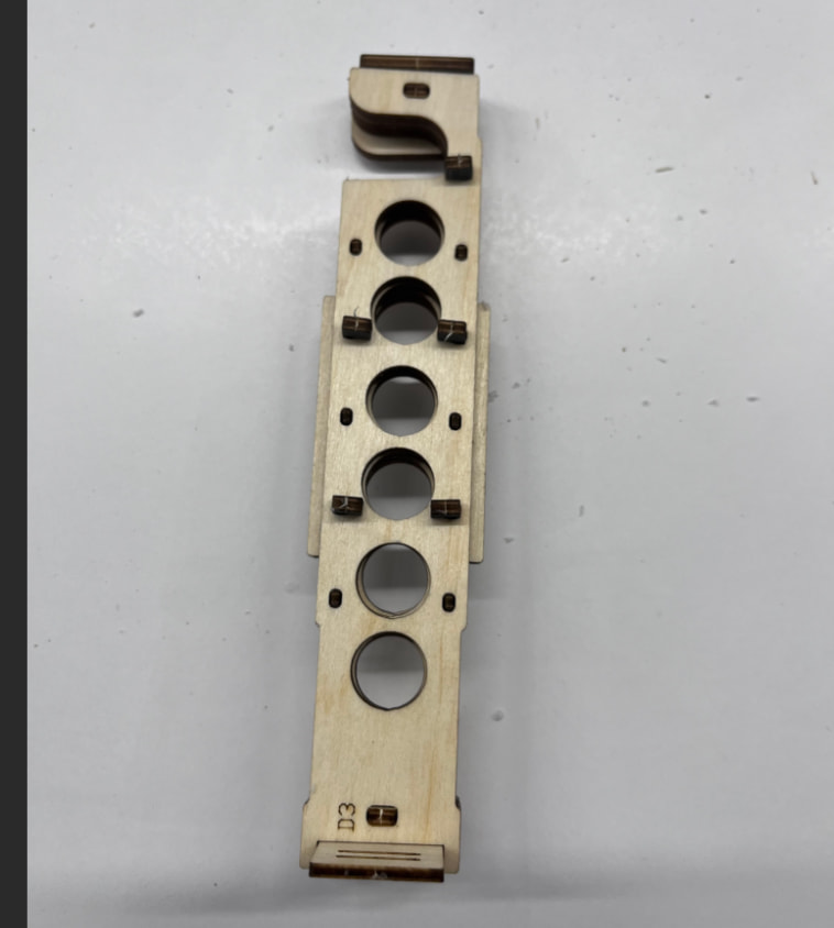

Thanks. Is there something different I need to do? It seems I’ve followed the instructions correctly. I noticed in other threads about the same issue, new part were offered as it was stated that the design had been improved.

Hello, we have optimized this component. We would like to send you replacement parts for the original ones. This usually resolves jamming issues with ball entry and exit.
