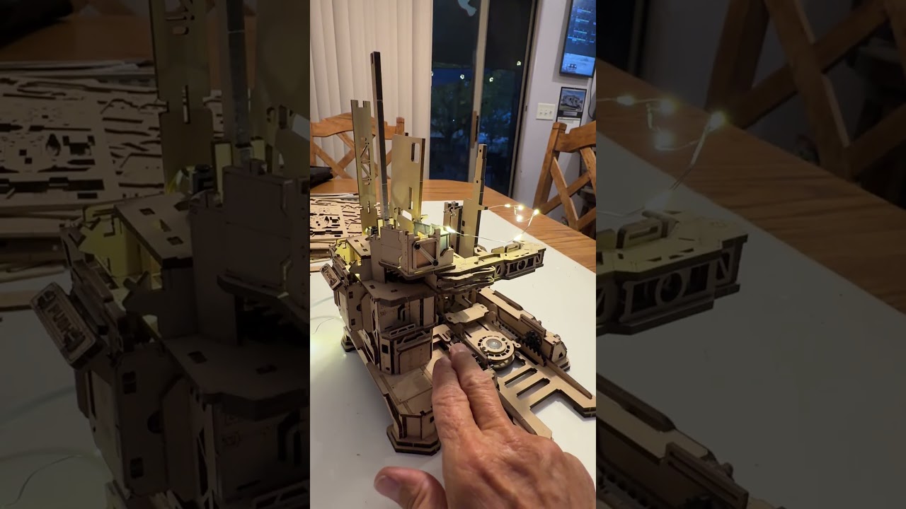

I’m at test 2 and everything is almost working perfectly except you have to unplug the power between every cycle. Even shutting it off doesn’t help. It has to be unplugged for about 5 seconds then when it’s plugged back in it will cycle perfectly. Also the lights don’t flash when it’s retracting. Any ideas?

Here is the video.

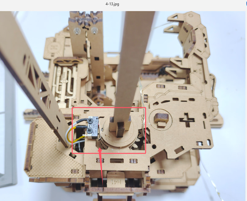

We believe this issue may be caused by the switch indicated by the arrow in the image below not being pressed properly.
We recommend finding the spare H40 part on the K board and replacing the original H40 with it, or bending the metal piece of the switch slightly to ensure that the H40 part can press the switch properly.

Thank you. Replacing the H40 part did the trick. Now I can continue the build.
