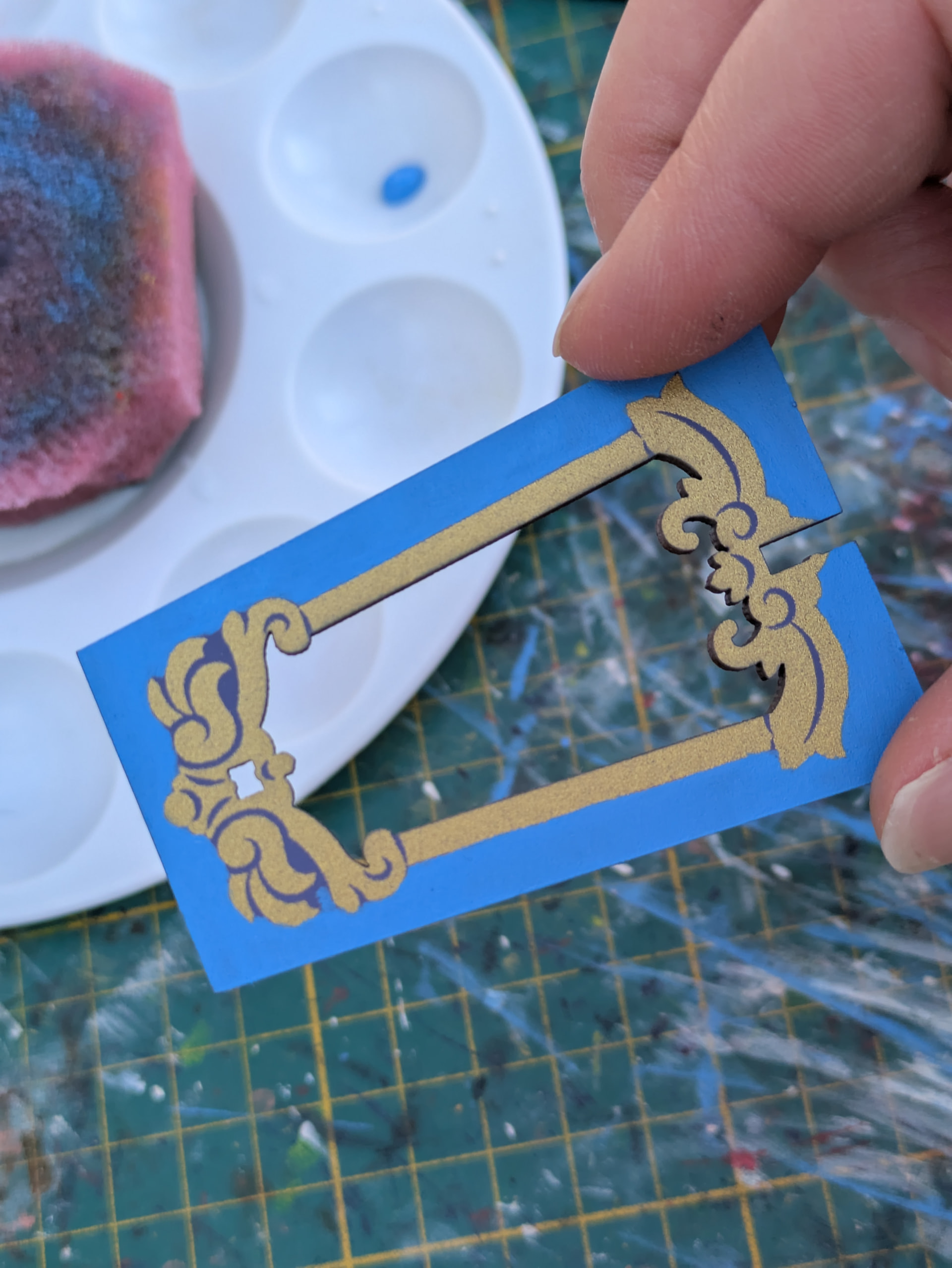

I’m often asked how I paint small details so neatly. Here I explain step by step how I work.
  1. I take my paint tray and thoroughly wet the sponge.
  2. I start with the large surfaces. I slightly dampen my brush with the sponge so the paint spreads better and there are fewer streaks. I always paint in one direction and try to blend the thicker paint strokes as much as possible. I use a flat brush so I can paint neatly along the edges.
    https://youtube.com/shorts/aUb0Il2U7W4?si=nR-bXScOcOf4AG3V
  3. I apply another coat if the first one isn’t opaque enough. As you can see in the video, I re-moisten my brush each time I pick up paint while applying the second coat. This softens the paint slightly and allows me to achieve the smoothest finish.
    https://youtube.com/shorts/SDoRXw-09_0?si=Tu_Lv78xYqmDoyxi
  4. Now I’m starting with the small lines between the details. I’m painting them with a very thin brush. I’m still always painting in one direction. Make sure there’s enough paint on the brush and moisten it regularly to keep the paint soft. If I make a mistake, I’ll leave it as is for now; I’ll touch it up later.
    https://youtube.com/shorts/Z6jo2qVxXK0?si=hiS08K-fF_ytQhHi
  5. Now everything is painted, and the edges can be touched up. Any spots where I went a bit too far, I’ll touch up with a precision knife. I’ll very carefully and gently scratch away the paint. This will make the edges smooth.
    https://youtube.com/shorts/WuGpepd1cLE?si=MYvmyJCXkQgpYsXG
  6. Now that the front is completely painted, it’s time to paint the edges. I’m using markers for this.
    https://youtube.com/shorts/WuGpepd1cLE?si=vlpIpD_iHjDRhpgy
Tip; the gold marker didn’t work very well anymore. This might be because the tip has dried out a bit. Remove the tip from the marker and place it in a bowl of hot tap water (Don’t forget to cover the marker with the cap). After soaking for 5 minutes, you can rinse it under warm water. I always squeeze the tip a bit to make it completely flexible. Dry the tip in a paper towel and place it back in the marker. Shake it well a few times, and the tip will refill with paint. The marker is working properly again.
