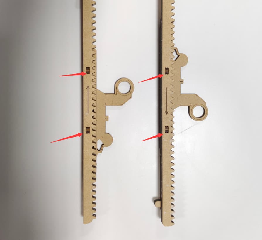

Hello, please apply grease to the inner surface of F9. Ensure the illustrated component is fully seated; otherwise, excessive friction may occur.

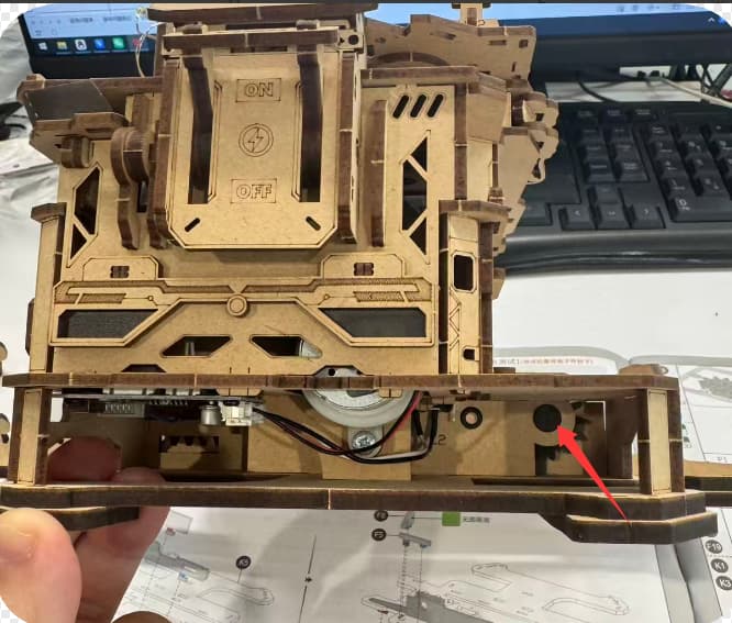

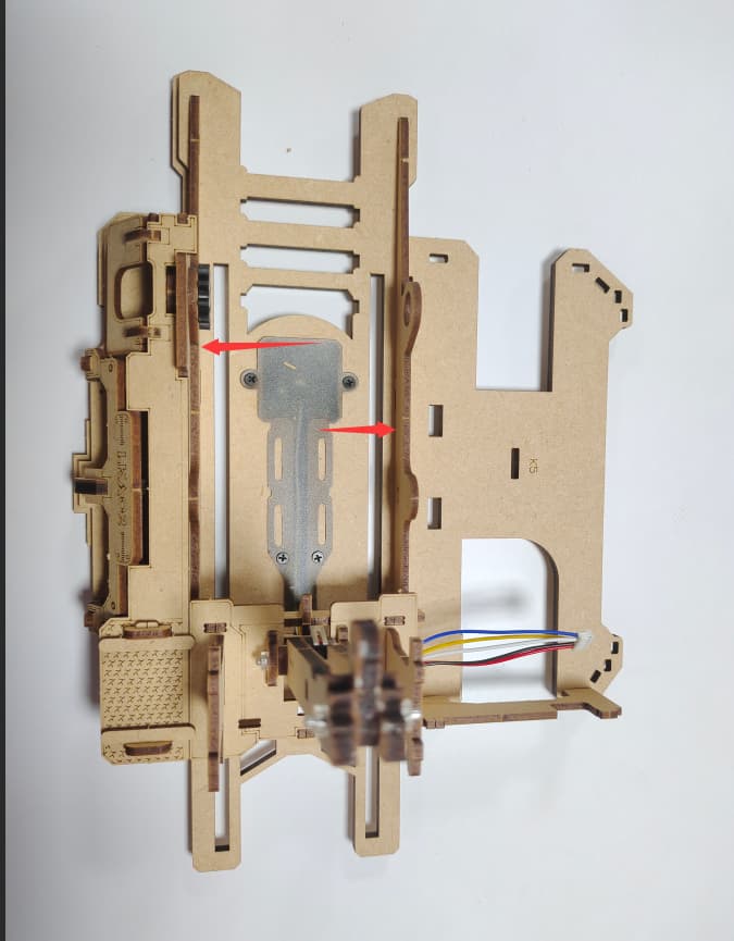

Regarding the jamming issue you reported, we have also conducted tests. The solution we found is to partially disassemble the back section, remove the Z3 gear, and then manually pull the track to test the effect.
  • If a wooden part feels stuck, try gently sanding and applying wax to both sides. Also, make sure F9 is properly in place.
  • If the wooden parts move smoothly but the gears are sticking, check that the Z3 and Z4 gears are aligned and meshing vertically. During adjustment, leave the screws a bit loose at first, and gradually tighten them once everything runs smoothly.
Thanks for the tips. In the meanwhile i sanded and waxed the hole where z4 goes through. I had the issue in the start when only z4 was placed. I had already mounted the other cogs before your reply. I took out z3 and z4 and again sanded it all and didnt put the screw to tight. Hopefully it will be enough. The resistance is still there a bit. Hope the engines can pull the schuttle trough the resistance
