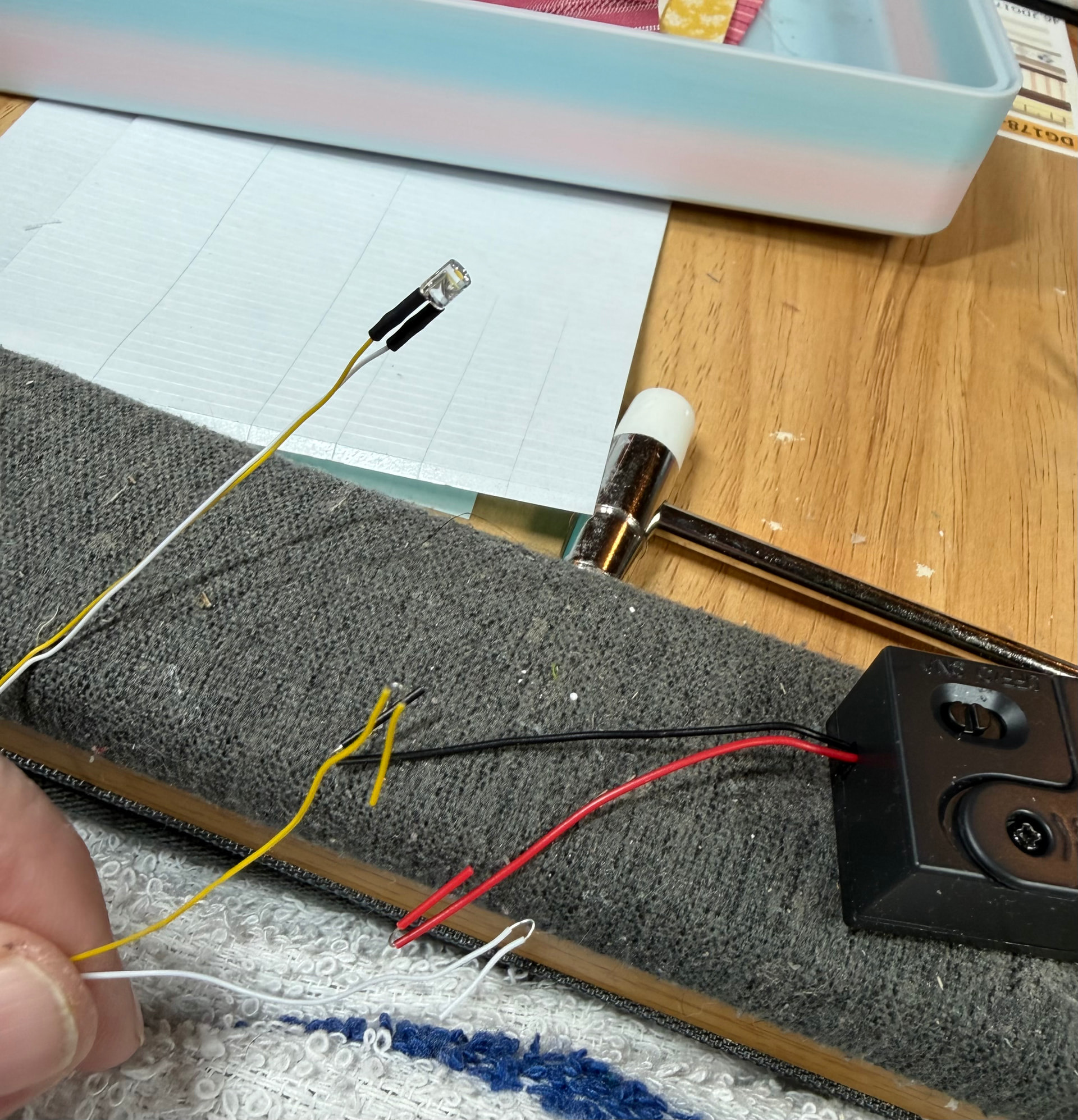

Here is a little tip I use all the time when I want to test my LED lights before committing to anything.
If you look at the end of your LED wire and your battery box wire, you will notice that the insulation has been cut back and pulled apart slightly, leaving a small section of bare copper exposed. That stripped end is actually really useful for a quick connection test.
What I do is bend that bare section into a slight hook shape. Then I hook the LED wire and the battery box wire over each other and keep just a little tension on them so they stay in contact. That is it! No twisting, no tangling, no making the ends stiff and hard to thread through the tiny holes in your kit later.
I am including two photos so you can see exactly what this looks like. It takes a second to set up and has saved me so much frustration. If a light is not working, I want to know before I have routed everything through the walls of my build.

Well, if you twist them together just for the test, it sometimes can be difficult to get those twist straightened out to fit through really tiny holes when you’re wiring it. Usually the reason why they don’t have the wires connected to the box is because of that.

The important message is really when needing to do be sure to test along the way so can correct any issues before entire kit is put together.
