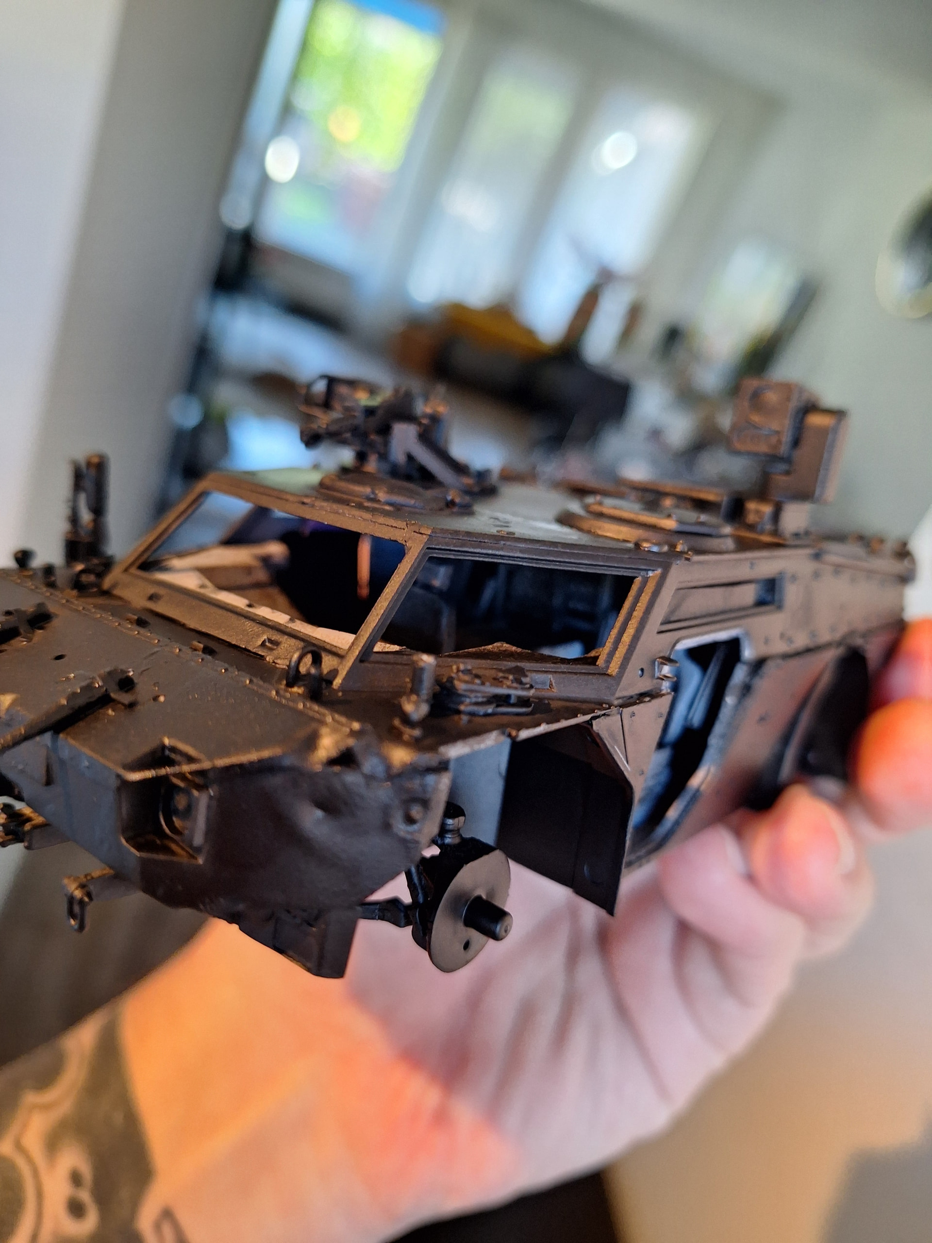

Today i had a day off and my daughter has a holiday at the moment. So she worked on her fake nails and i worked on the tank.

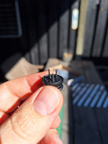

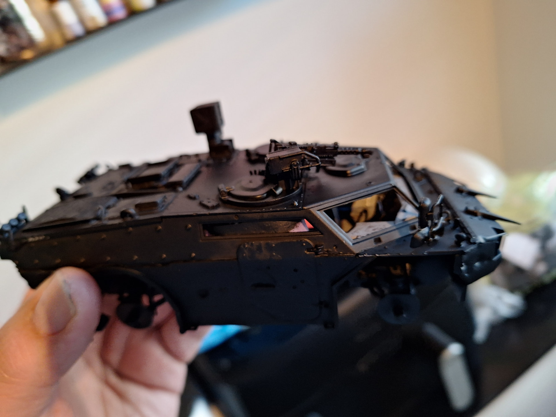

I finally found a way to add spikes. I sprayed black paint on toothpicks and cut the top off and glued them on the rims.

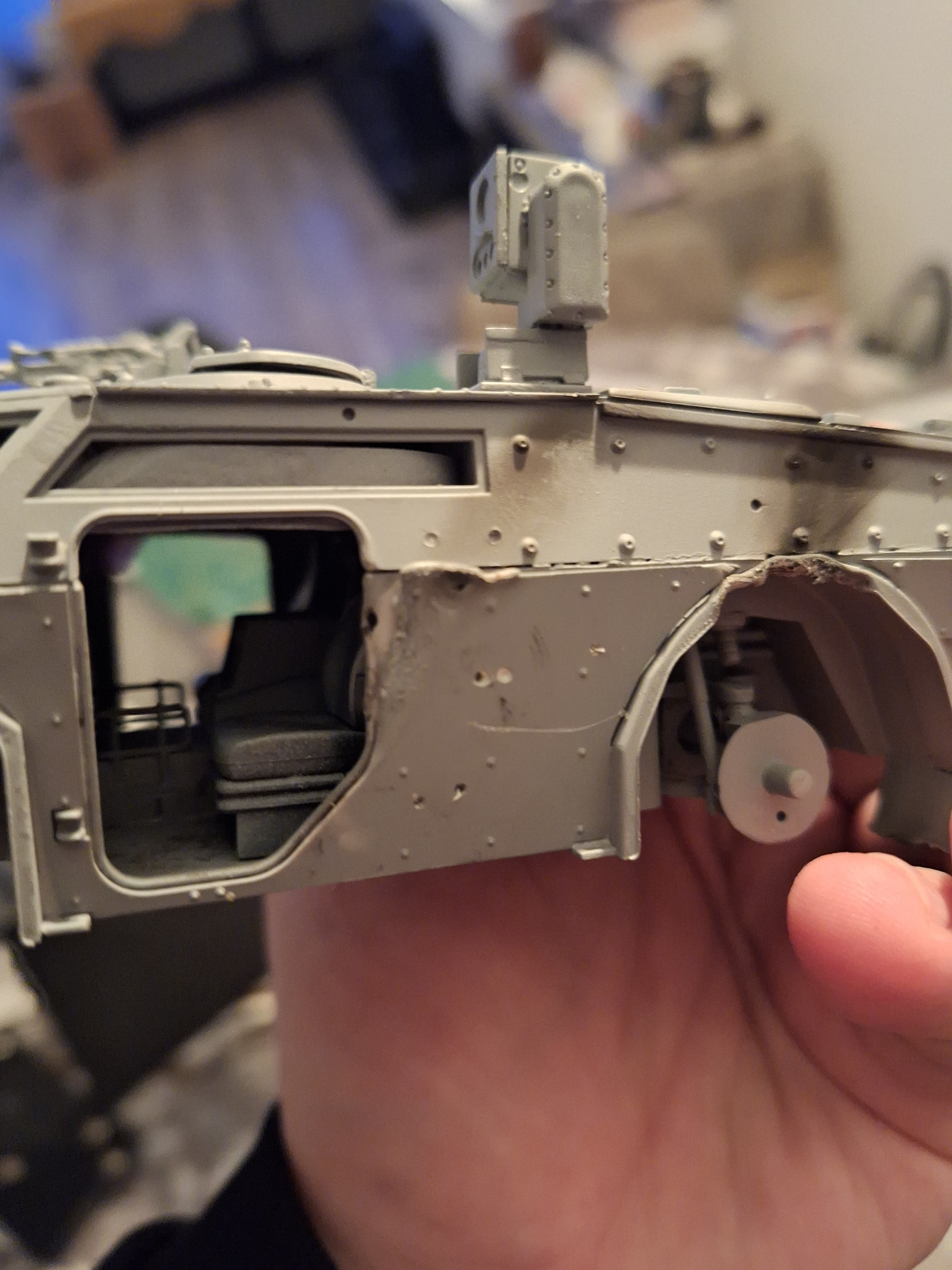

I added bulletholes and damage to the body.

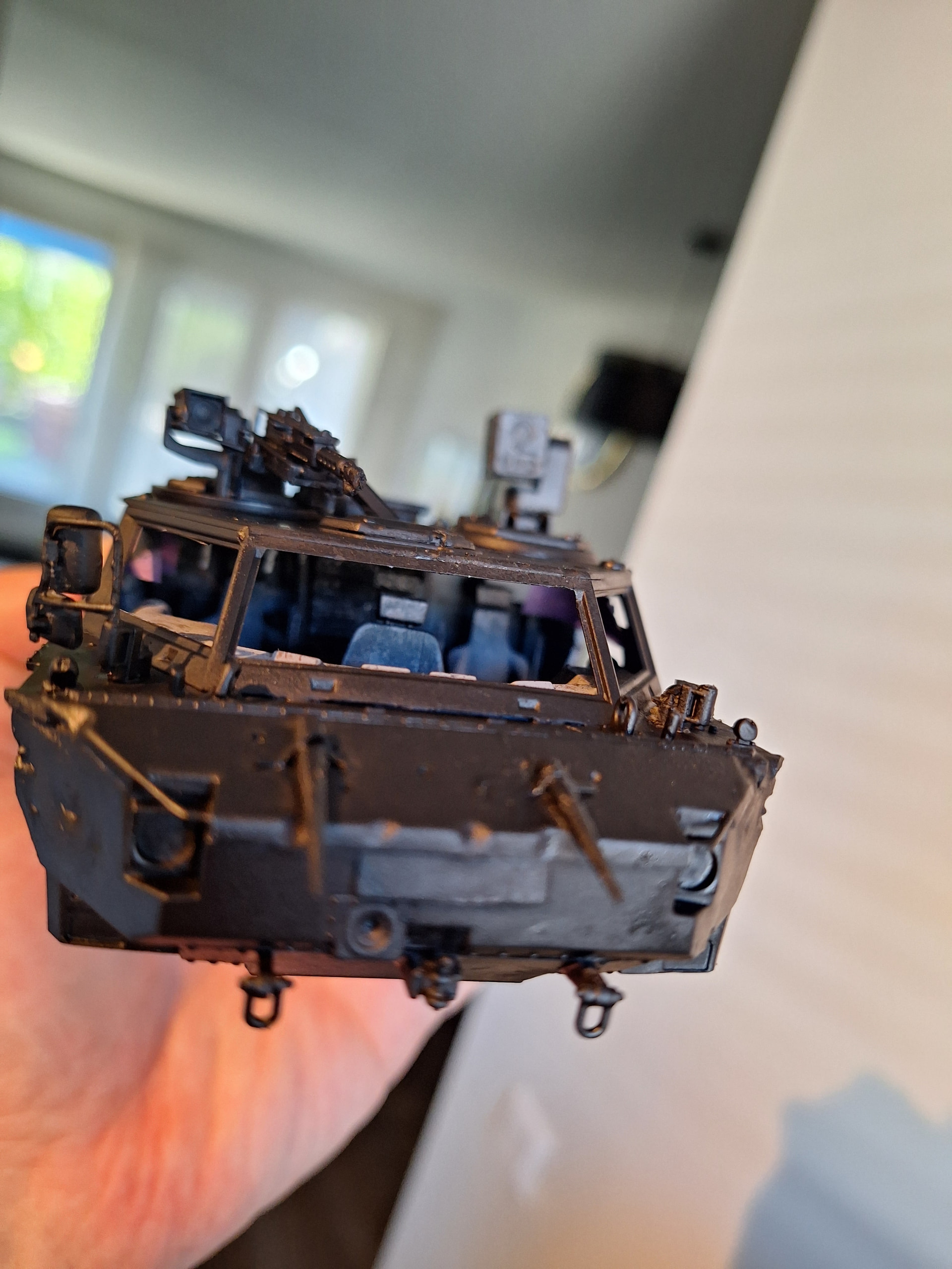

Insprayed the body with matt black paint.
Now we have to wait for the rust paint to arrive. I will not be using the black oxide i checked multiple youtube video’s and none of them had the desired effect.
I love how it’s turning out, I can’t wait to see it with the rust.

Thats an amazing way to make spikes! And its looking amazing

It should be arriving today. Next week I’m on holiday so it will have to wait.
hoohoohooo. This is really looking awesome Jerry! What a great idea for the spikes. Looking forward to see the rust and how whatever you ended up choosing, turns out.
Wooooow Jerry it’s looking good! :smiling_face_with_sunglasses: I love the spikes and bullet holes, it’s giving Mad Max vibes!
I’ve probably missed a lot of posts so did you end up choosing the iron oxide? :thinking:
I’m loving your progress! You are so talented with painting it so realistically. Can’t wait to see the final product.
Nope. I watched all youtube video’s i could find about it and none reached the effect promised. I bought 2 types of rust and 1 light dirt. Im gonna brush the rust on thick and then tap it with a bit of sponce with thinner on it to get an broken up rust effect on the model and dust for the wheels and fenders.
