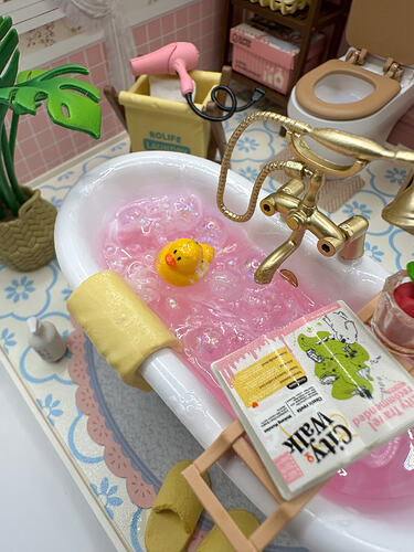

Inspired by my last post Finished Pop Bubble Bathroom, I’d like to share how I made the bath water and bubbles.

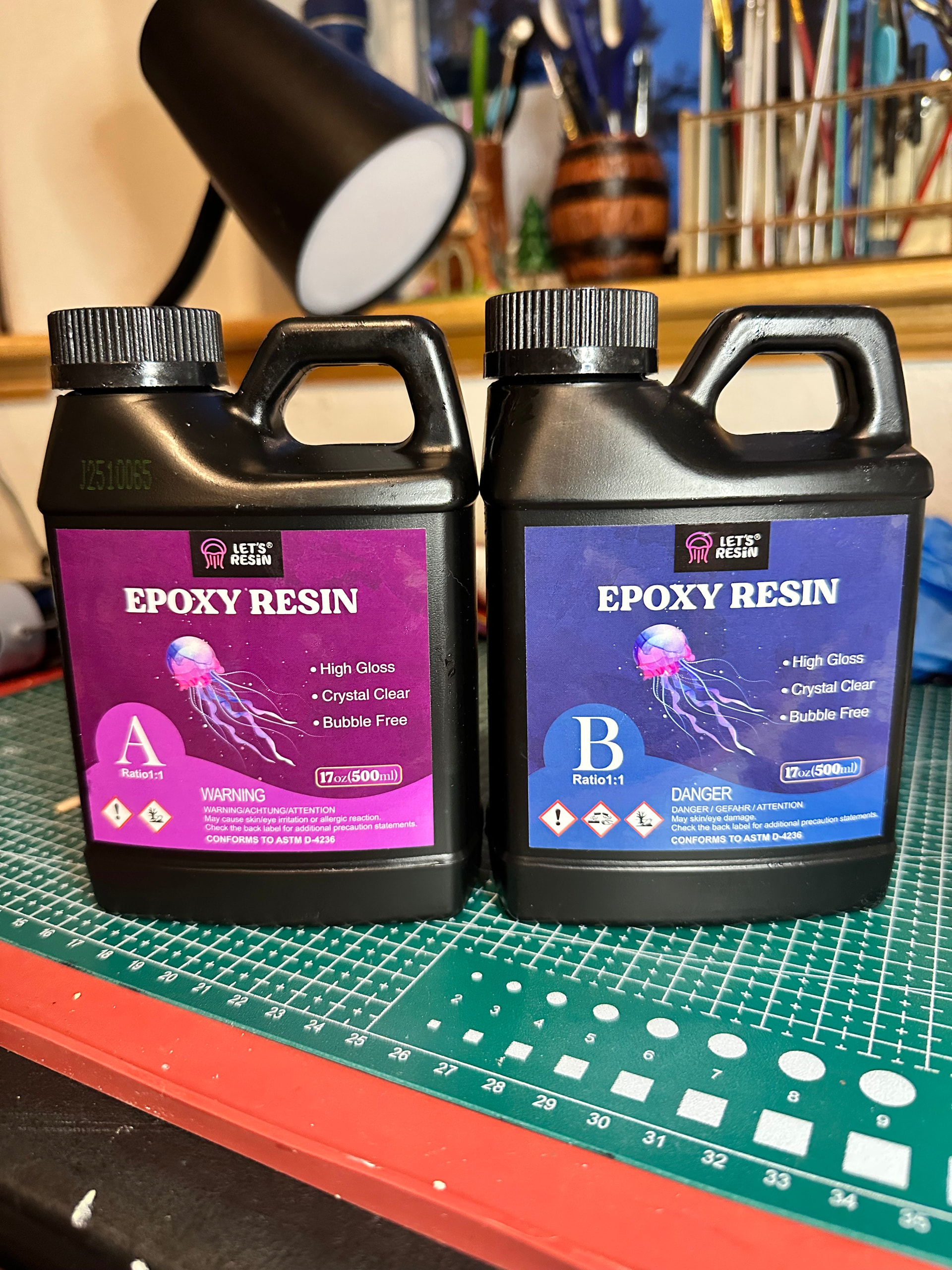

  1. Safety First! I use nitrile gloves and respirator mask, and I do this in a well-ventilated room. I use Epoxy resin parts A and B. I use Let’s Resin brand.

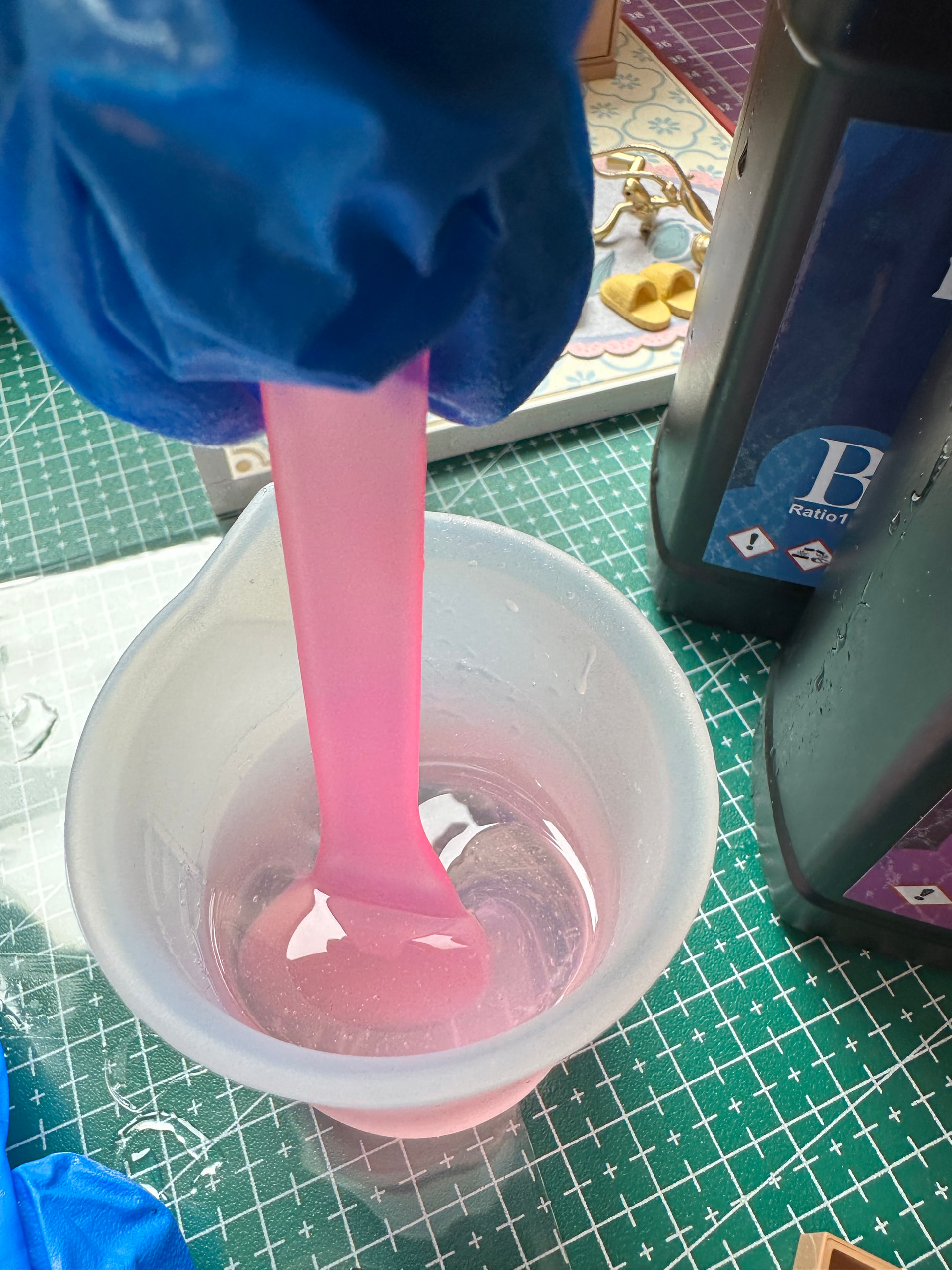

  1. Mix parts A (resin) and B (hardener) in 1:1 ratio. I hand-mix with silicone spoon or stirring stick for 2-3 minutes in a steady, medium speed (see video how fast I stir) until the consistency becomes clearer and less milky. Stirring at a moderate pace ensures that the mixture doesn’t get frothy and unusable, and avoids air bubbles and flash curing (fast cure caused by friction between resin and hardener).
  2. I added two drops of color pigment (I chose pink) and kept mixing until the color is even.
Then I poured the resin into the tub.

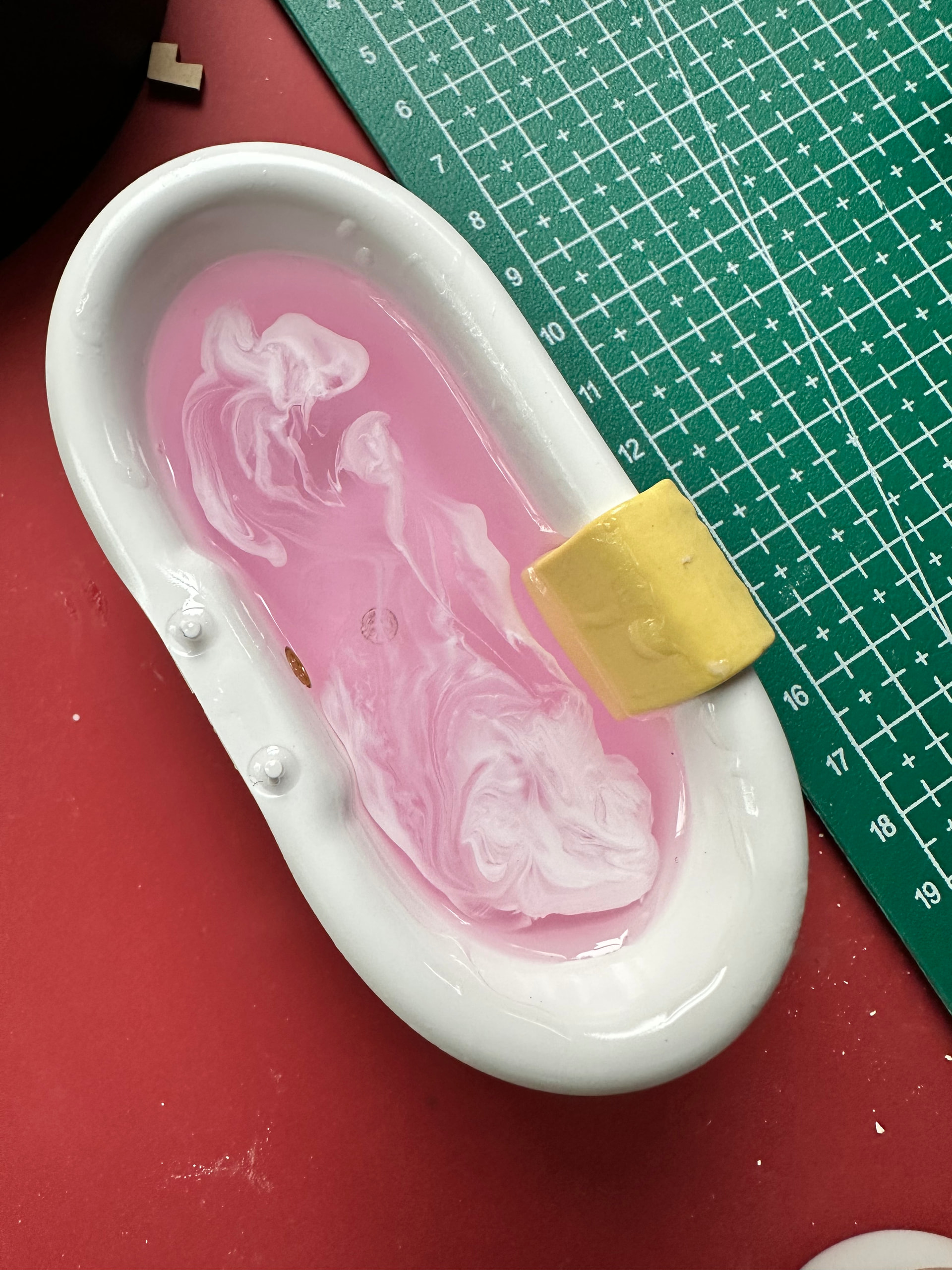

  1. I mixed a bit of white epoxy pigment to add a bit of sud-sy effect.

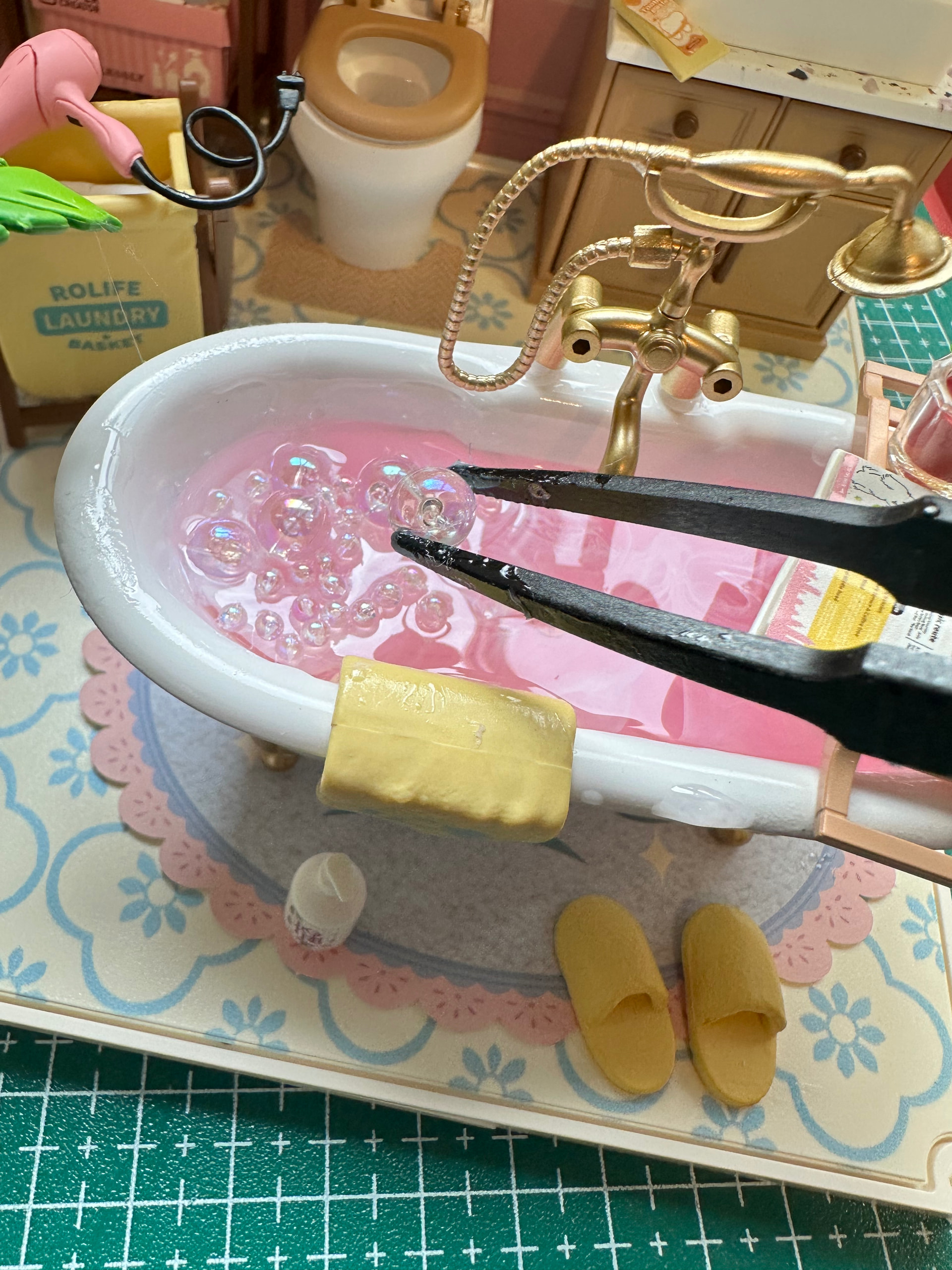

  1. I waited until the resin becomes more viscous but not hard. In this case I waited for about 3 hours but it really depends on how much resin you use. Once it’s viscous, I added iridescent beads and rubber ducky, being careful that they won’t sink down. If they sink down, wait again until it reaches the right amount of viscosity.

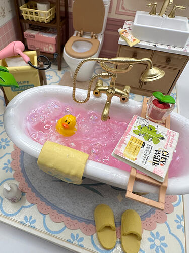

  2. Wait to be fully cured (hard) which may range from 8-12 hrs.
    Voila! You’re finished!
