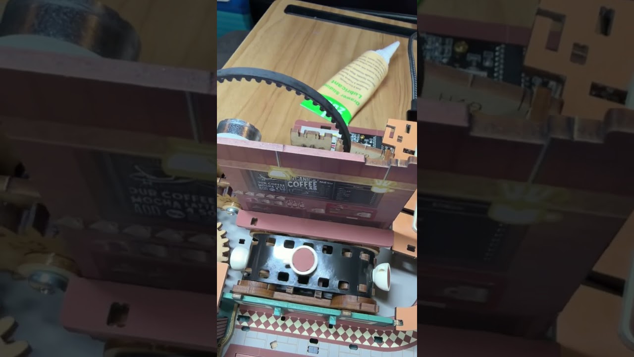

I just literally completed the model as far as you have and my one did make a bit of a noise but not as near as loud as your one is :grimacing: And it’s the conveyor belt that’s causing it.
See if you skip to 01:29:06 in this video, I’m explaining what I did that reduced the noise a bit for me :blush: https://youtu.be/Sk4vVyLIYTk

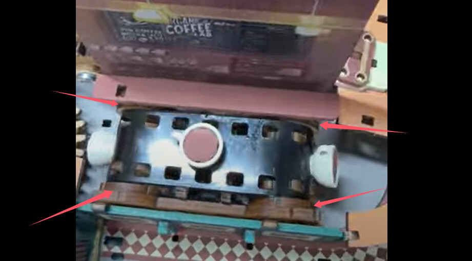

Hello,
Please try to gently push the four parts indicated by the arrows below to both sides respectively.
This will reduce the friction between the edge of the conveyor belt and these four parts, thereby reducing the noise.
Thank you so much for taking the time to make that video - I really enjoyed watching it and appreciate you sharing your process! The wax tip is great, and I actually did try something similar with wood lubricant earlier.
After you posted, Rolife customer service also responded with a diagram showing where to gently adjust four small circular parts away from the conveyor belt edges, and that ended up making the biggest difference for the noise!

Thank you so much for the diagram and instructions! Adjusting those four circular parts away from the conveyor belt edges made a huge difference - the noise is much quieter now. https://youtu.be/vjJ39pbTYW8
