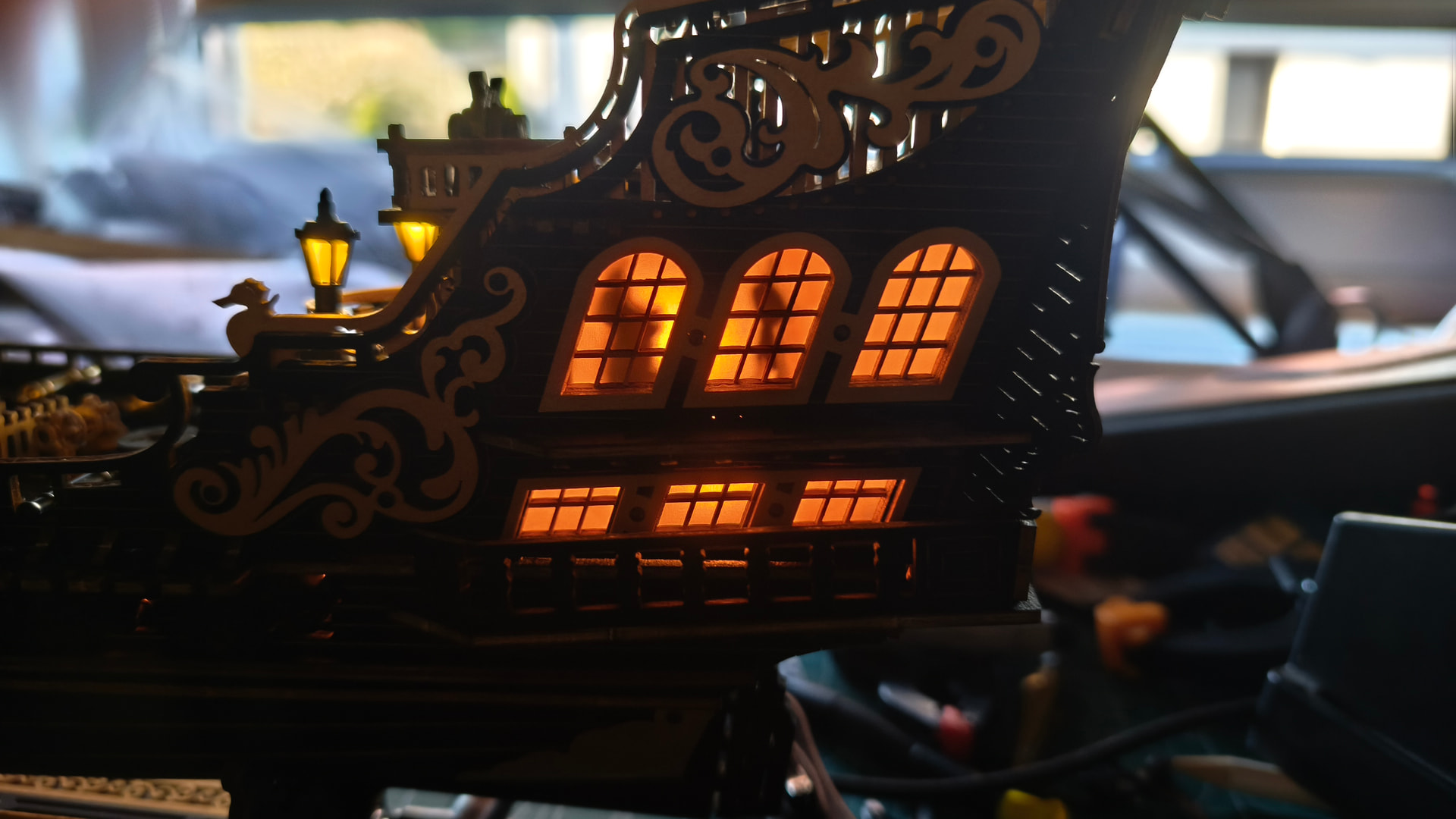

I’m not good in painting like some pro designers here but Im good in electronic that’s why I focus more on lights :slight_smile:

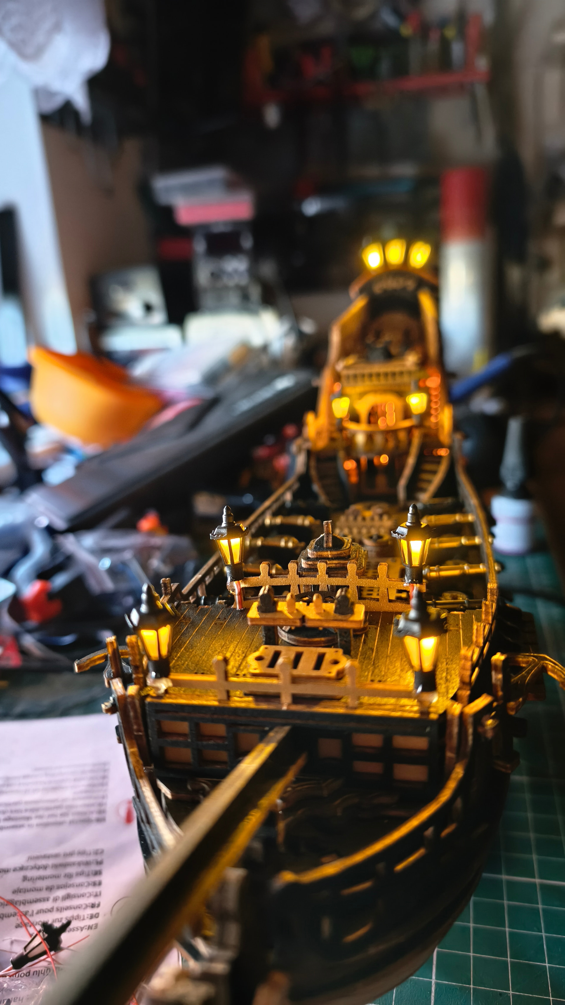

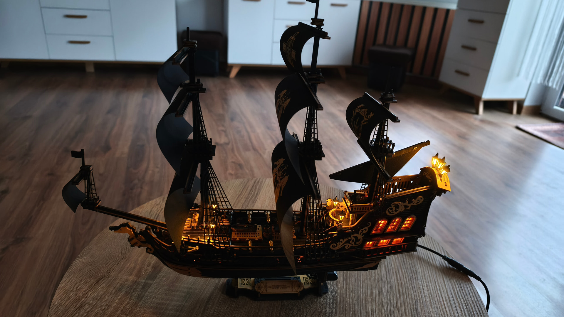

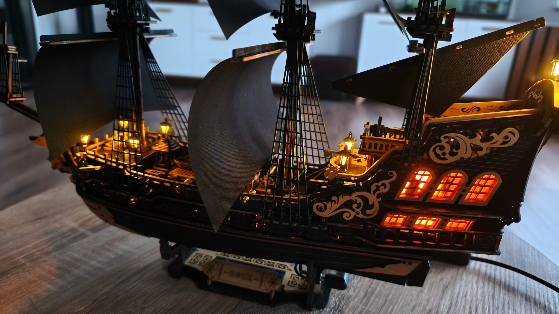

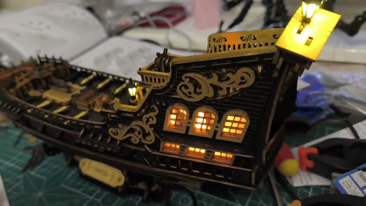

I added 150:1 street lanterns on deck and 100:1 lanterns on back of ship to give it more lights.
Under deck I have 3 small flame simulating lights and 2 bigger fire lights inside back of ship.
Fire simulating lights are optional and can be turn on by opening cannons with bot where I use limit switch with roller that is activated by central part of cannons motion.
Here is a link to video from testing lights:
Right now ship wait for display case and will be My pride :slight_smile:

I use dc power supply 5v 1A and for lanterns resistor value is best to check minimum and see what work best for You.
Deck lights use 330 Ohm resistors same as back ones but if I would know 100:1 lanterns are brighter than I would use higher resistor like 480 Ohm to dim it a bit.
Candle fire simulation lights work on 5v so they are connected without resistor thru that limit switch under deck.
I have 5.5x2.1mm socket in ship base and from there I have short extension with a switch to cut off power from ship and longer extension with power supply after so I can select length of cable.
