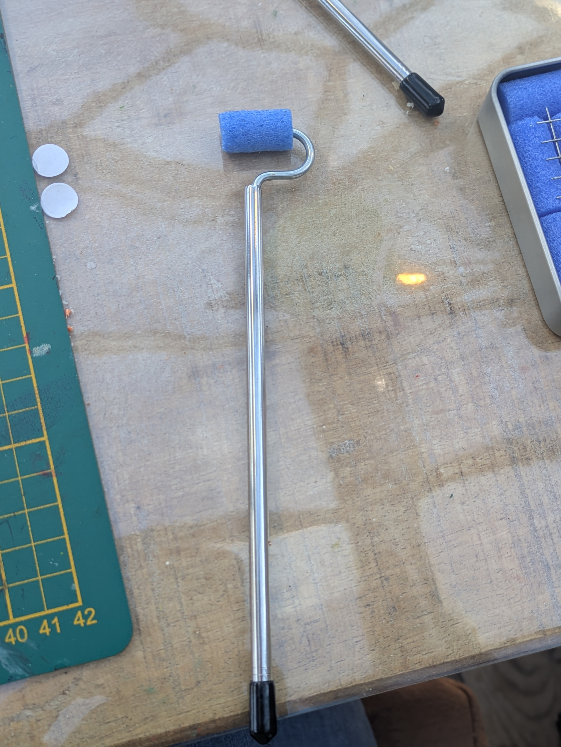

If you are going to use acrylic paint, I advise using one that isn’t too cheap, because it doesn’t cover well and you get color differences. I use Amsterdam acrylic paint myself, but I don’t know if it is available worldwide. @Nita_Davis uses paint from Apple Barrel and it also covers well. You don’t need to apply a primer, you can paint directly with acrylic paint. I bought mini rollers which work well for large surfaces.

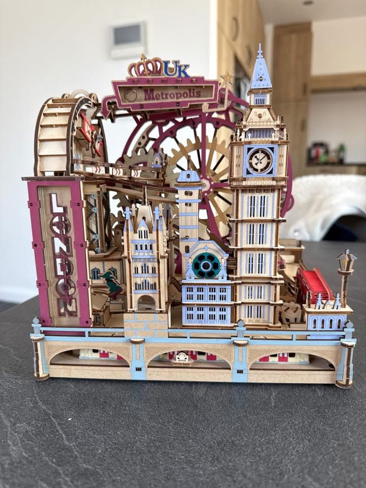

Here is my version of pinball
@Liset has given great advice. Her pinball machine is absolutely stunning!
Thank you @Nita_Davis :hugs:
You’re so very welcome. I am still in awe every time I see this work of art. :heart_eyes: @Liset

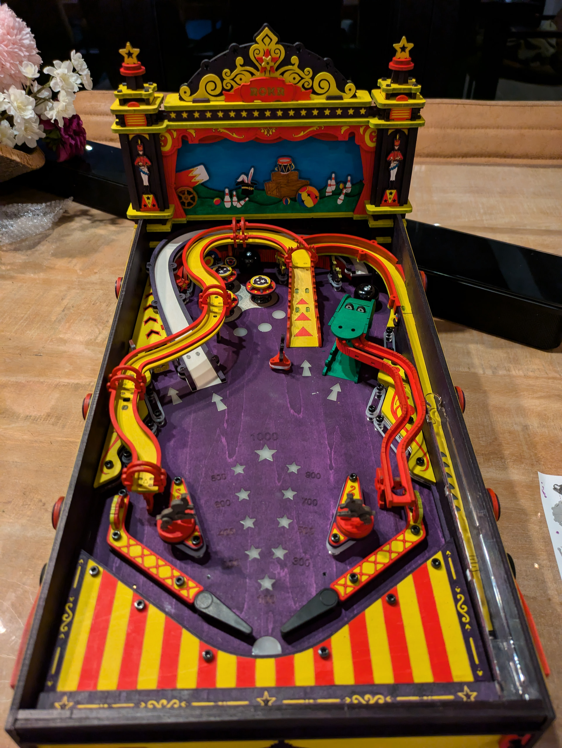

I painted everything on the pinball and it works perfectly. As you can see in the photo, I thinned the paint a bit more on the base plate. The ball rolls smoothly and the buttons work smoothly too. It’s a good tip to apply the paint in multiple layers and not as one thick layer. I always do this too to prevent brush strokes.
I think it looks quite unique @Minus_88
I will need that roller. Your pinball looks amazing.
