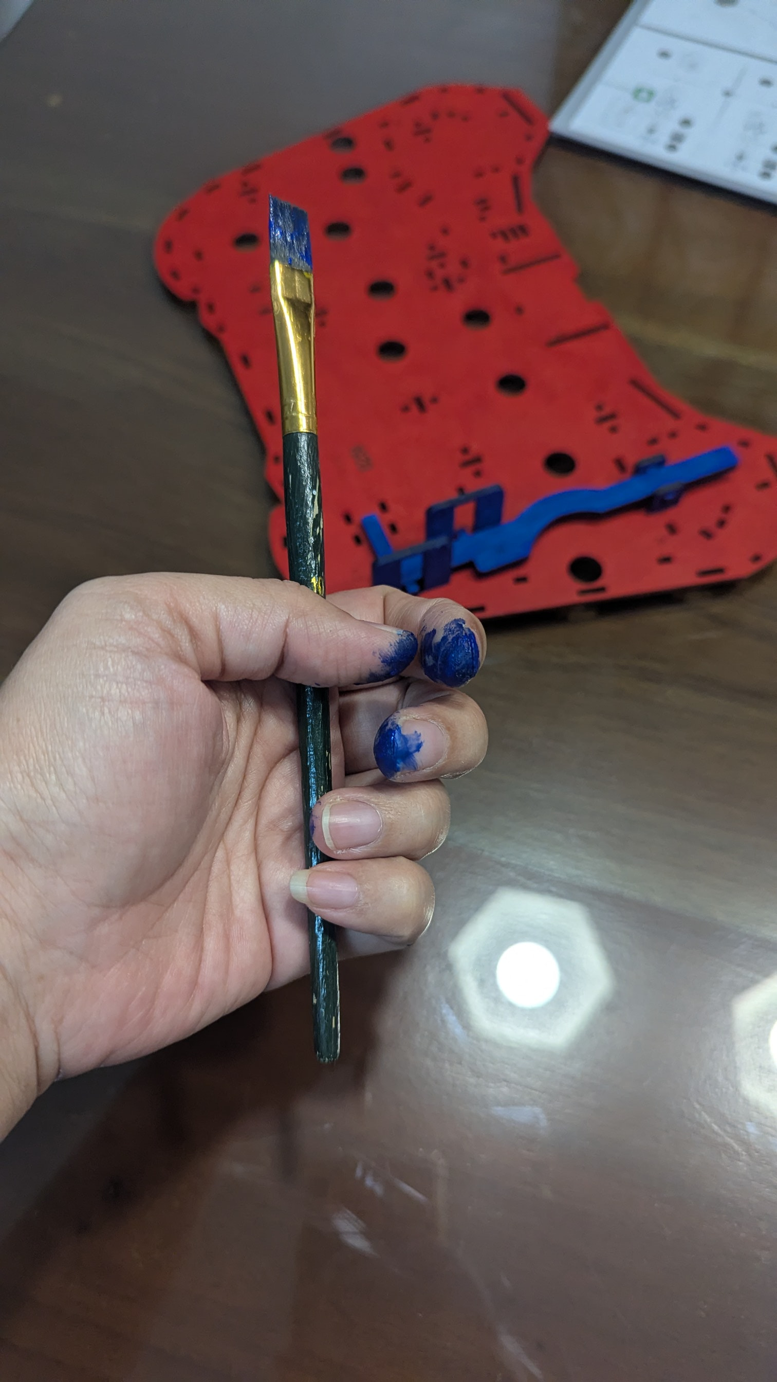

:pushpin: How do you keep your painted pieces out to dry? I painted them over a paper but I noticed that the paper sticks on the pieces. Should I paint over plastic instead?
:pushpin: I noticed that the paint on the edges/sides are a darker shade. Should it be sanded until the wood shade lightens before I paint them?
Feel free to drop any tips you think that can help on my journey please. I would really appreciate it.
For now, my hands are all colored up :joy:

I’m definitely not a paint expert but I balance my items on the edge of a paper plate. Because it is slightly curved on the corners, only the edges of the item touch anything.
I would lay them on wax paper so they don’t stick. I sand the edges to get the burrs off, but some colors will stick take multiple coats on edges for coverage. Avoid yellow. That is the hardest one I have found to cover properly. I have the little magnetic parts holder now for drying…but parchment paper will work fine.

The colors look great already! I always paint everything on my cutting mat. It’s best to paint the edges first with a marker and then apply a single coat with a brush and acrylic paint. This ensures good coverage and a consistent color throughout. You don’t need to sand it down.

Oh dear…I would suggest priming those edges with the best covering white you can find…I would add a drop of black to white and use that. Yellow covers fine on bare wood…but not those edges.

I paint on a cutting mat/carboard/baking paper depending on how I feel. The edges are harder to work with, I find they also absorb a lot more paint. So I sometimes paint them with some white first before moving on. IT TAKES FOREVER. :smiling_face_with_tear:

If you’re using a paint, I recommend to paint white as your primary base of the color before you apply the color that you want it to be. For the edge, I don’t sand it. I just apply white color to make the color more noticeable. I make the paint dry for several minutes and apply minimal water to acrylic so it’s not rought to apply.
