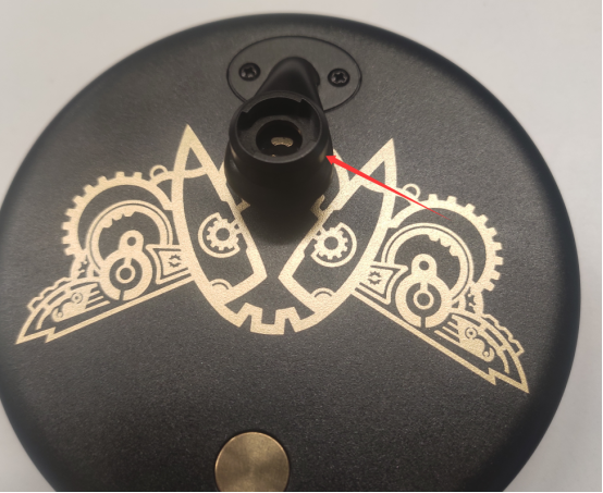

③ Check the assembly direction of the base power switch.

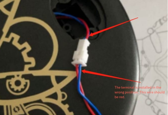

④ Check the wires of the power switch : red wire corresponds to red one and blue wire corresponds to blue one.

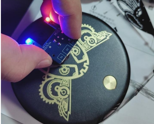

- Test method: hold the circuit board in hand to touch the base copper piece directly, then press down and turn on the switch. After the light is on, insert the electronic components in turn to test parts response.

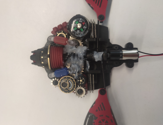

- All parts are normal, but the product is stuck and does not rotate.

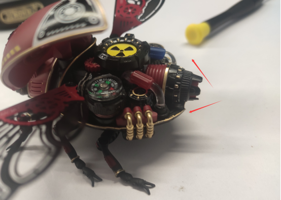

① Lubricate all the gears.
② Lightly press or lift up the position of the tail to check if the screws at the bottom of the tail are tightened too much.
