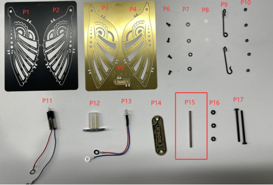

- If the size of P15 is too longer, it is a mixture. Please contact customer service to re-issue the part.

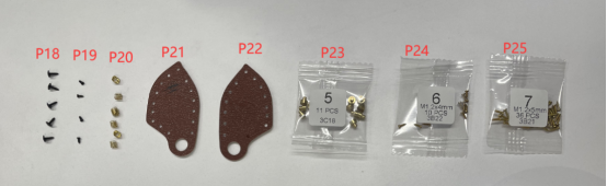

- Two springs P20 may be inserted together to form one. Please check carefully.

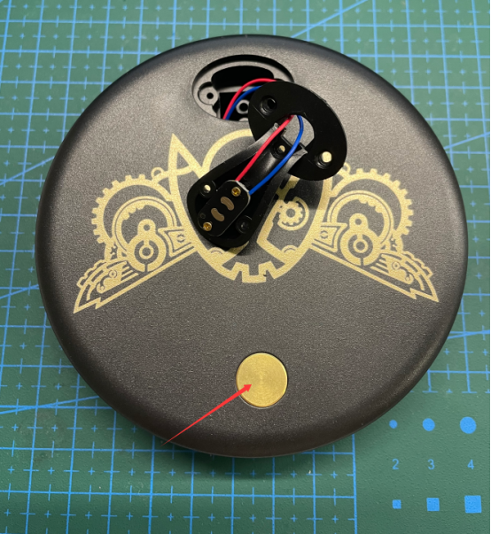

③ The touch switch is not clicked:

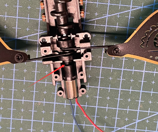

- The light is on but the product does not rotate.

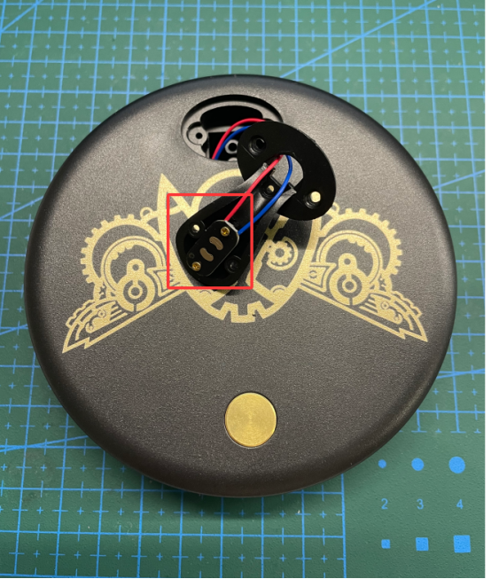

① Check if the power switch is assembled in the opposite direction.

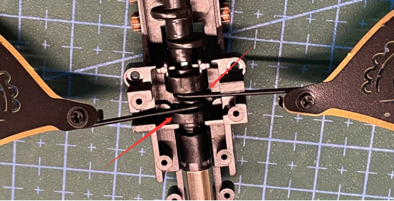

② Check if the motor and F1 are inserted half-circle to half-circle. The normal state is very loose but the abnormal state is very tight.
③ Check if the wing linkage is assembled incorrectly.
