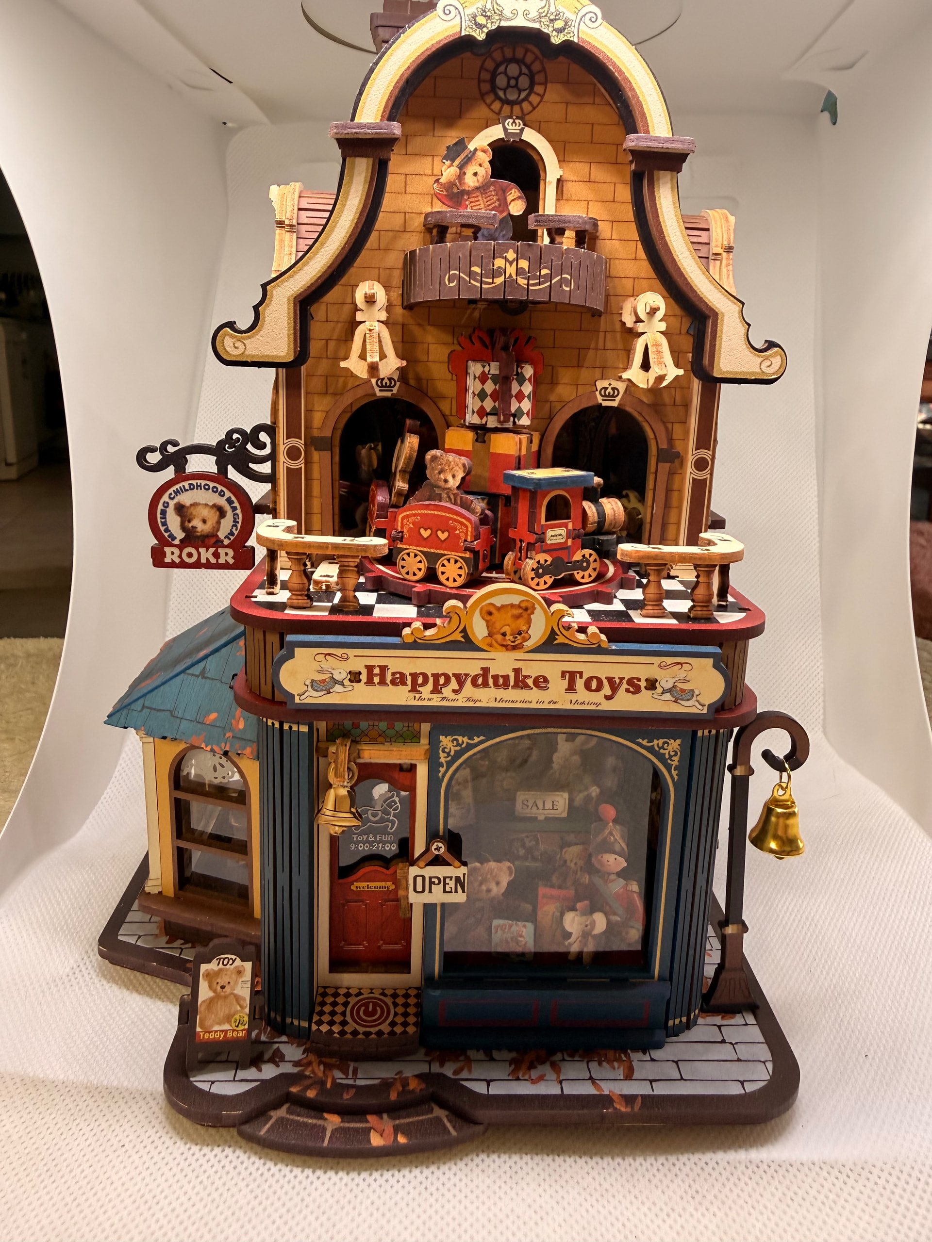

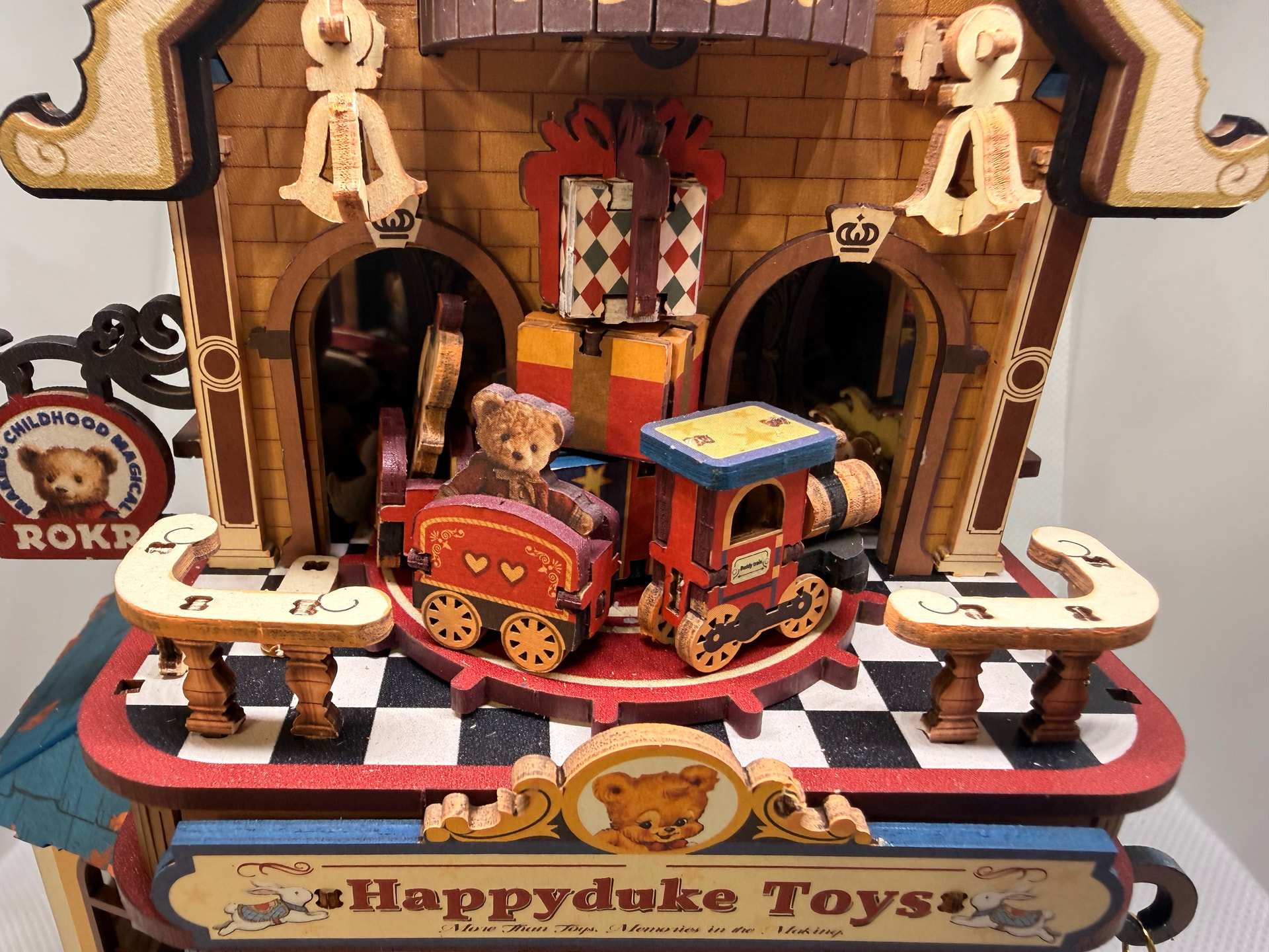

I did it!! My first ROKR mechanical build. And I’m really happy with it.

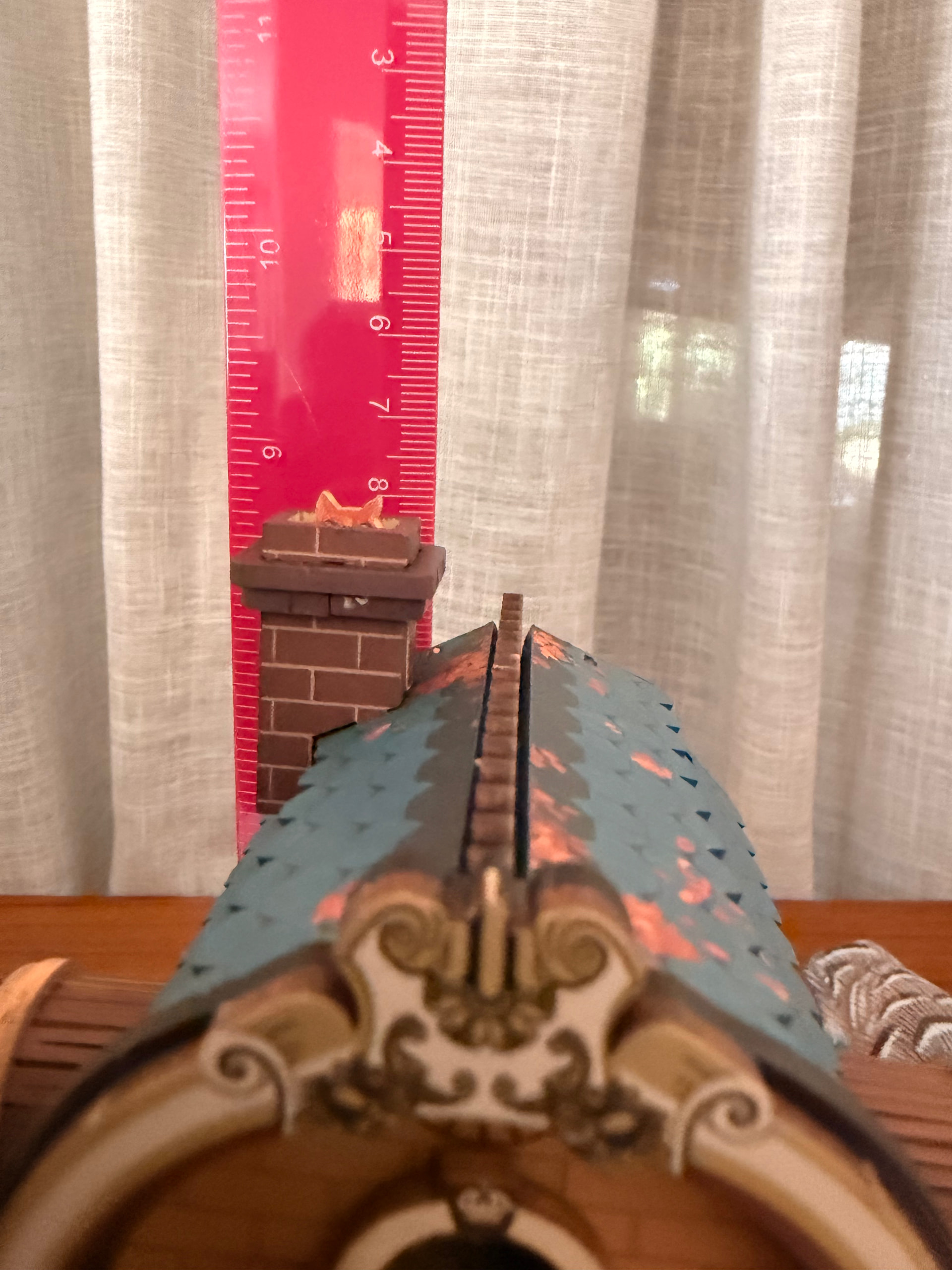

Standing at about 8.5 inches (22cm) tall, it is much smaller than I expected. The toys inside are all 2D. The board is solid and care needs to be taken when removing pieces to avoid a small amount of splintering. As I was painting the edges, I was able to cover most of these issues.

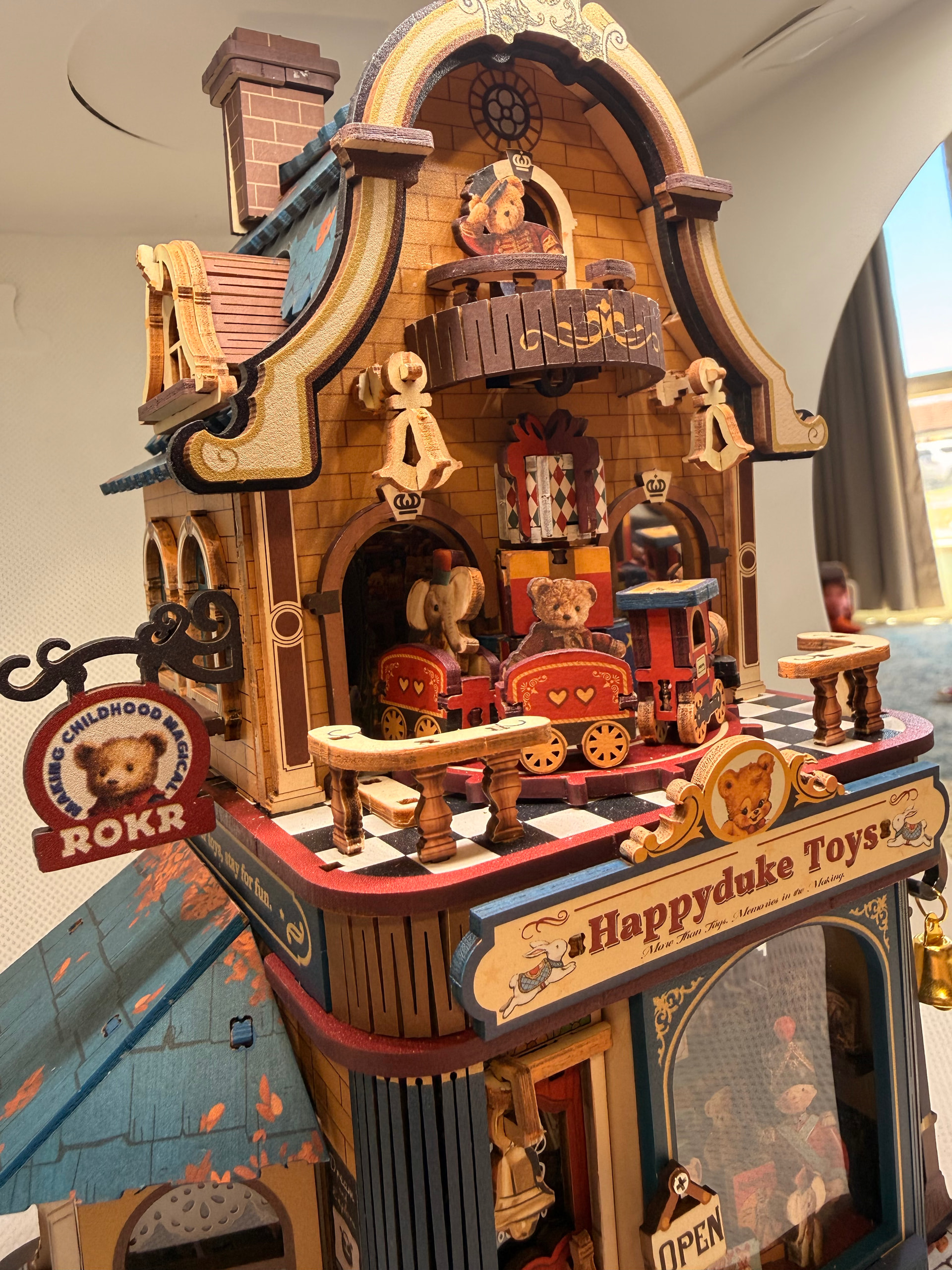

I had a bit of a slip up when putting in the cat (I out it in back to front ) but luckily realised my mistake before I had gone too far ahead. Also, it’s not mentioned in the instructions but I later waxed inside the chimney to ensure smooth movement of the cat.
I had a moment where I didn’t read the instructions too well and put two of the roof pieces in the wrong place making it hard to place the chimney. I was able to remove the pieces and reassemble them in the correct order. If I had followed the instructions, it would have been easier as there is no glue in the instructions, however, I found that the pieces on the roof fitted better with a bit of glue.
Overall, this was a pretty straightforward build as long as you follow the instructions ha ha
