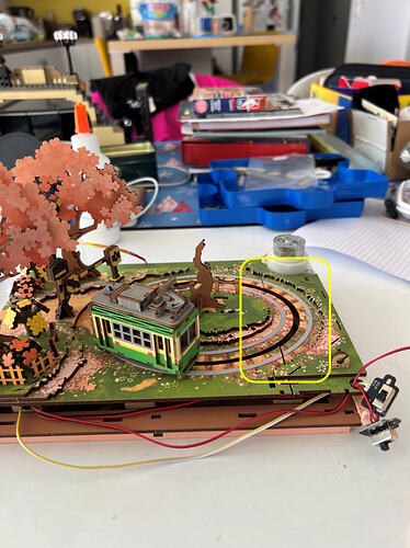

Hi @Robotime! Yesterday, I have disassembled the kit (happily I haven’t closed it yet). It’s quite easy to remove pieces in fact even decorated with the trees on plates :face_exhaling:. So I have checked what could have happened.
  1. First, no short circuit happened for my tram happily. The toothed wheel of the motor didn’t fit well with the others. Ok.
  2. I have checked if any pieces described in the notice were missing in my assembly. No problem.
  3. I have paid attention to insert well the metallic tubes under the train between the wooden rails. No problem as well.
  4. But when I have switched on the system, my tram always touch a little the flowery decoration at the outline.
What to do :face_with_monocle:?
  • Either I’ll check if I had built well my tramway (so it means disassemble again the kit),
  • Check if the metallic tubes under the tram haven’t moved when positioning the circular flowery in the middle.
  • If I don’t find a solution, I’ll remove the excess of flowery decoration by polishing it again,
  • Or, if only I could, I would cut the side of the outline, but how? I can still ask advices to a carpenter I know to cut the outline on the right. At least, I could add flowers myself and It wouldn’t be visible since it will be hidden by the front of the TV on the right.
To conclude: Either I made a mistake (more convincing argument), or I am part of the unlucky crafters :cry: (maybe???).

Hi @CustomerService and @Robotime, I have finally solved my problem!
Thanks to @Sasa for the advices on your topic :blush:.

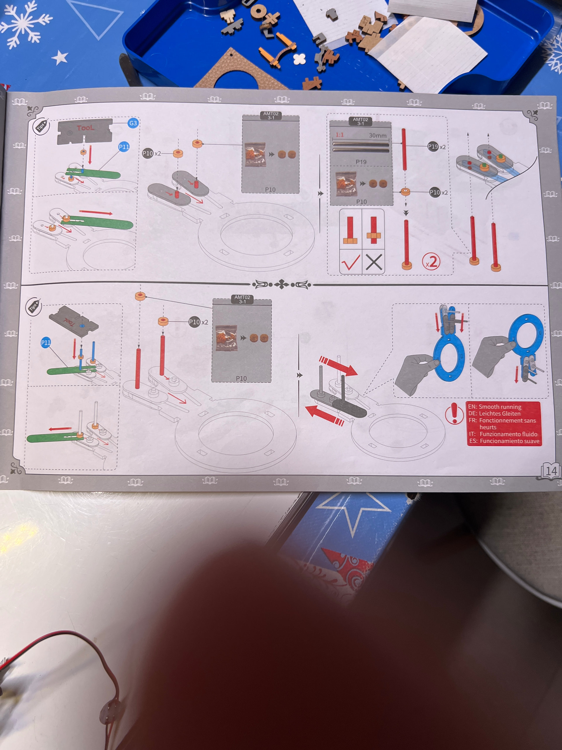

I have probably push too strongly the little yellow rings on the metal bars. This time, I have paid attention to:
  1. use the Tool properly (I don’t remember if I have badly using it),
  2. and to use the little plastic item in the Tips p.14. When I have removed it, there was a little space which I believe help my tram to roll above the flowery decoration. I think that I had pushed too much the metal bars, which could explain why my tram damaged the outline.

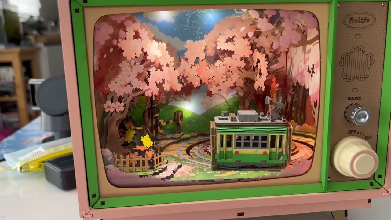

I have at last been able to build my Sakura dream tour. My husband helped me to make the tram rolling properly and not leaning.
It’s not perfect but defaults can’t be seen.
