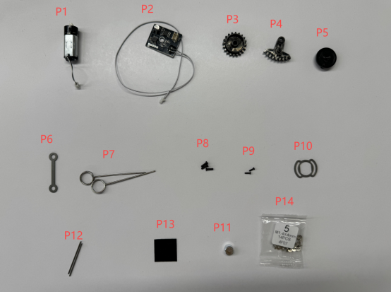

  2. The motor and circuit board number of the lift module is MRL01-P1 P2. Please don’t make any mistake when you fill in replacement parts form.

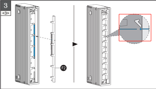

(2) If the gears F1 and F2 are not aligned with the gears P3 and P4, please disassemble and reassemble, ensuring F1 and F2 are assembled properly before removing P7.

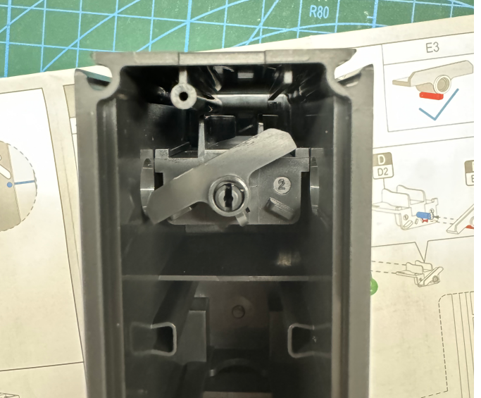

2.The ball is stuck in the lift module.

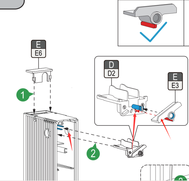

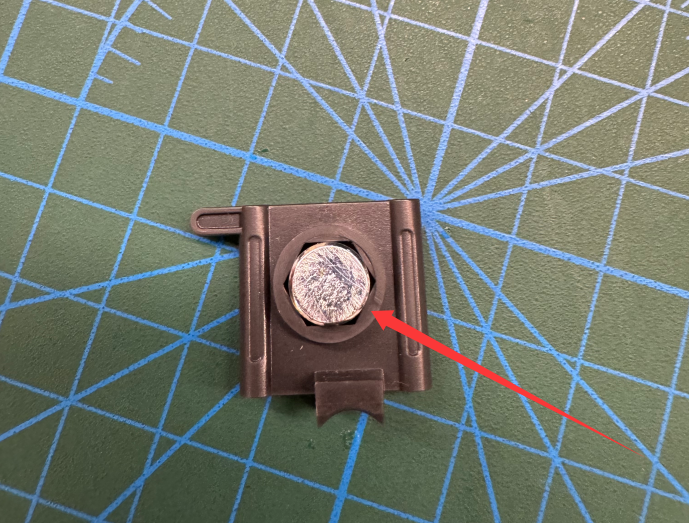

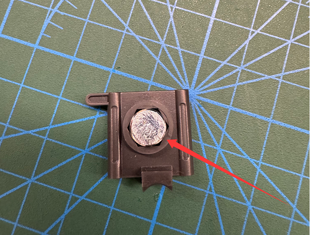

① The ball is stuck in the upper part of the lift module:
The front and back of E3 are reversed:
The opening of E3 is assembled in the opposite direction:
② The ball is stuck in the lower part of the lift module: P11 is missing.
