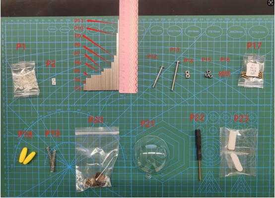

- P1 is a transparent shaft sleeve.

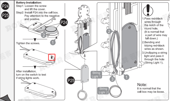

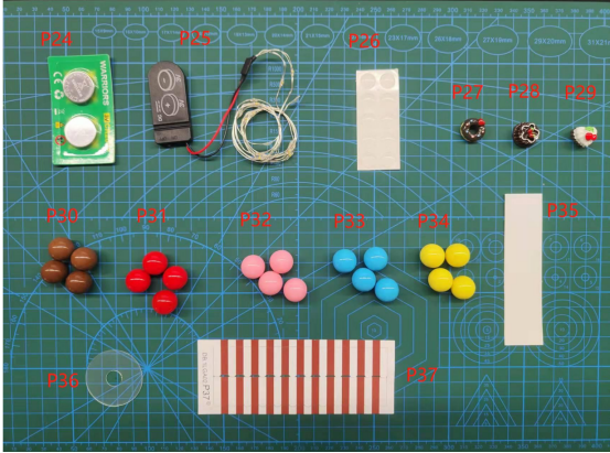

- Assemble batteries. Remove only one screw on the battery box.

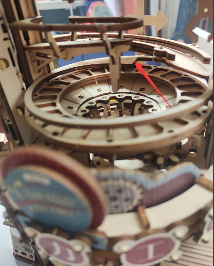

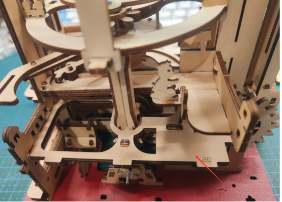

- The ball won’t roll off automatically.

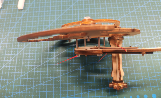

- The ball is stuck in this position as shown: check the up and down position of the two boards and the distance of the shaft sleeve on the steel shaft.
- After assembling D2, test for smoothness of rotation.
- If the overall rotation is not smooth, disassemble it to wax the gear meshing area and the inner side of the bearing as shown.
