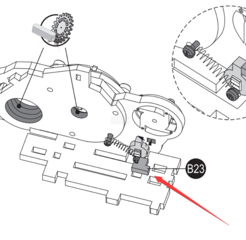

  1. Side bracket cannot be lowered
    ① Check if B23 is installed

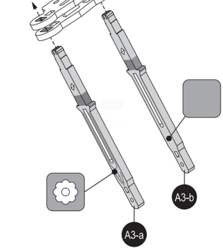

  2. A3-a, A3-b do not fit in
    ① Check if A3-a and A3-b are installed upside down
