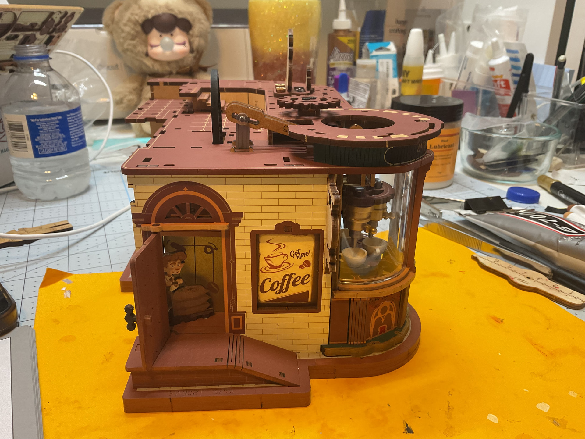

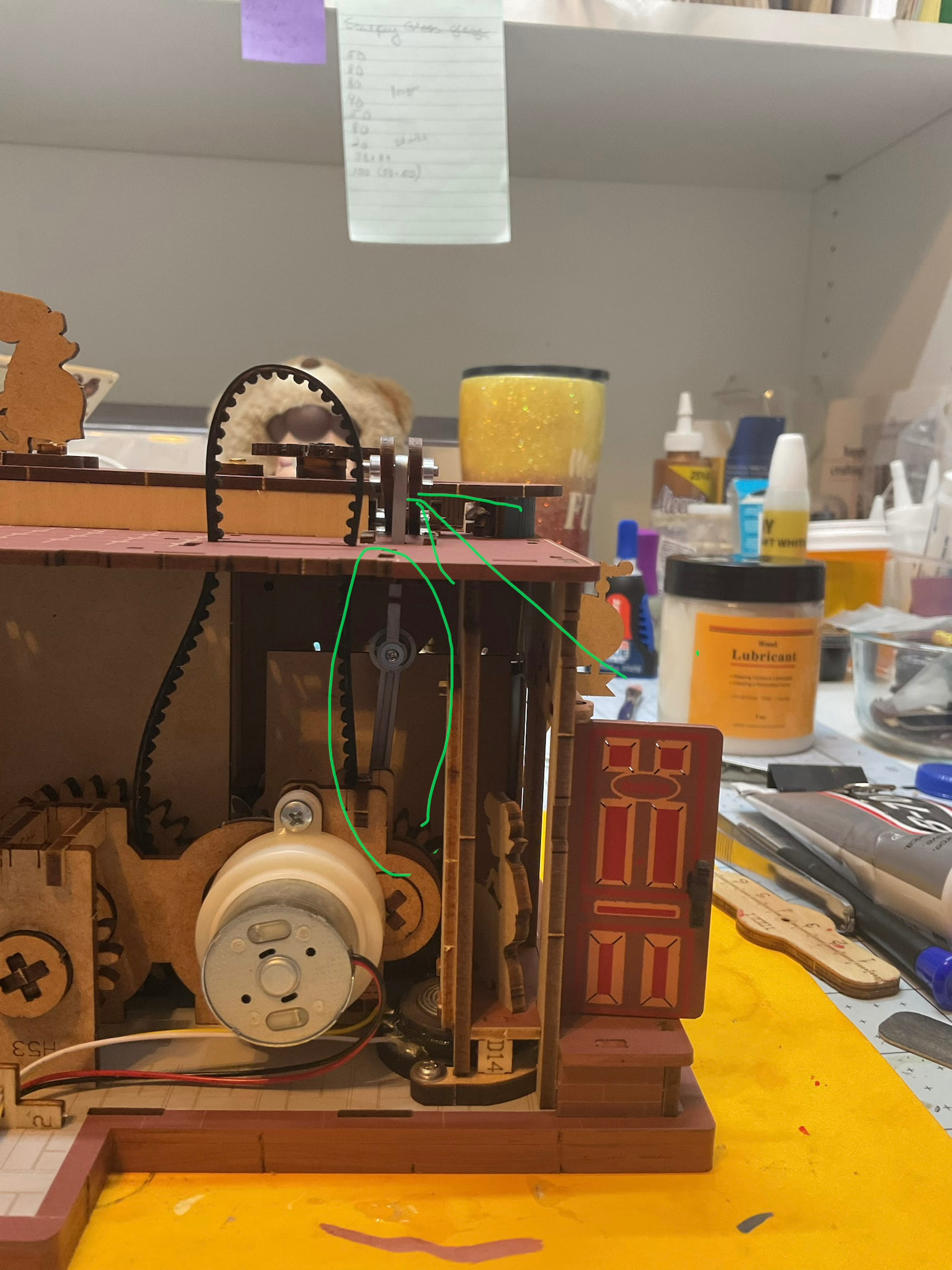

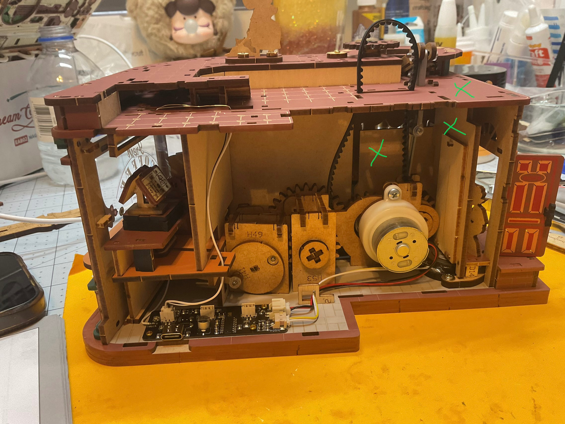

As the day progressed, things improved. Monday started out a bit rough but I got my act together. Here are some more tips as building progresses. As I stated in my last update, be sure the grey handle is facing the right direction when you screw it on to gear. and hang on to it during initial few tests or it will get stuck in big gear. (piece - X 3, page 7).
Moving ahead, when securing walls J9 and K4, be sure of location of that same grey handle set up.
When placing 2nd floor be sure you insert that grey piece through floor.
otherwise you have to unsnap that floor. It locks into some fragile pieces and you do not want to break those! Luckily I had success there!

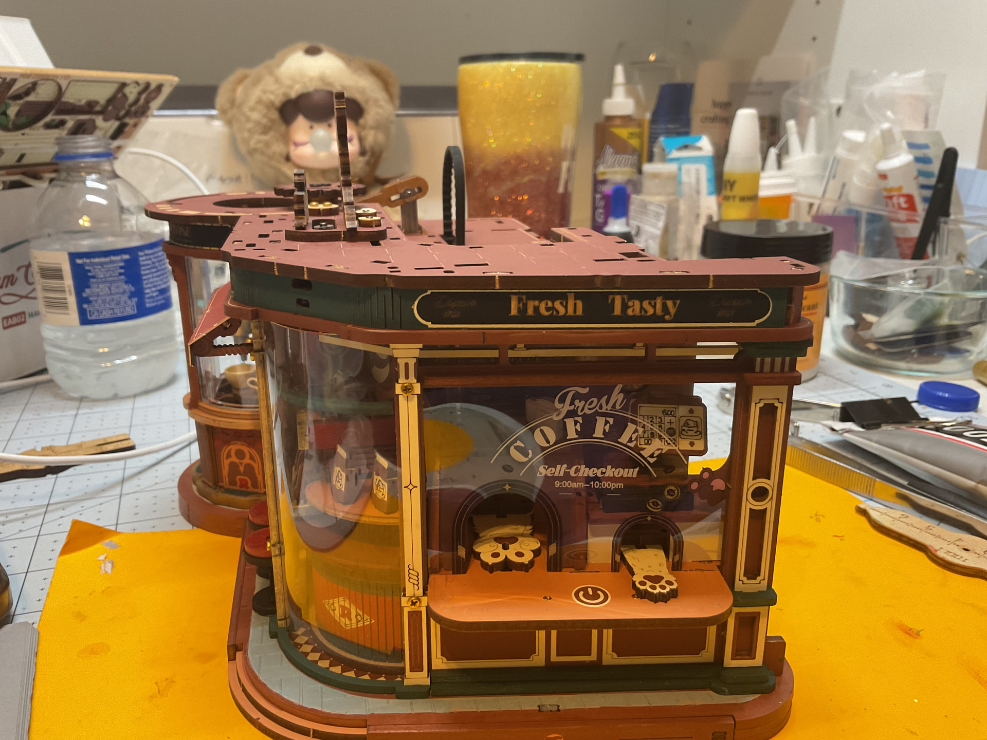

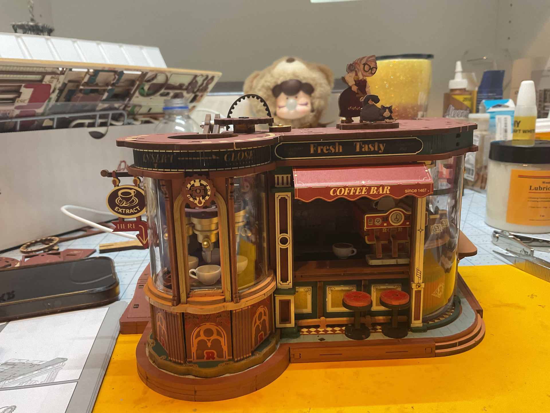

Here is my progress as of Monday afternoon!
