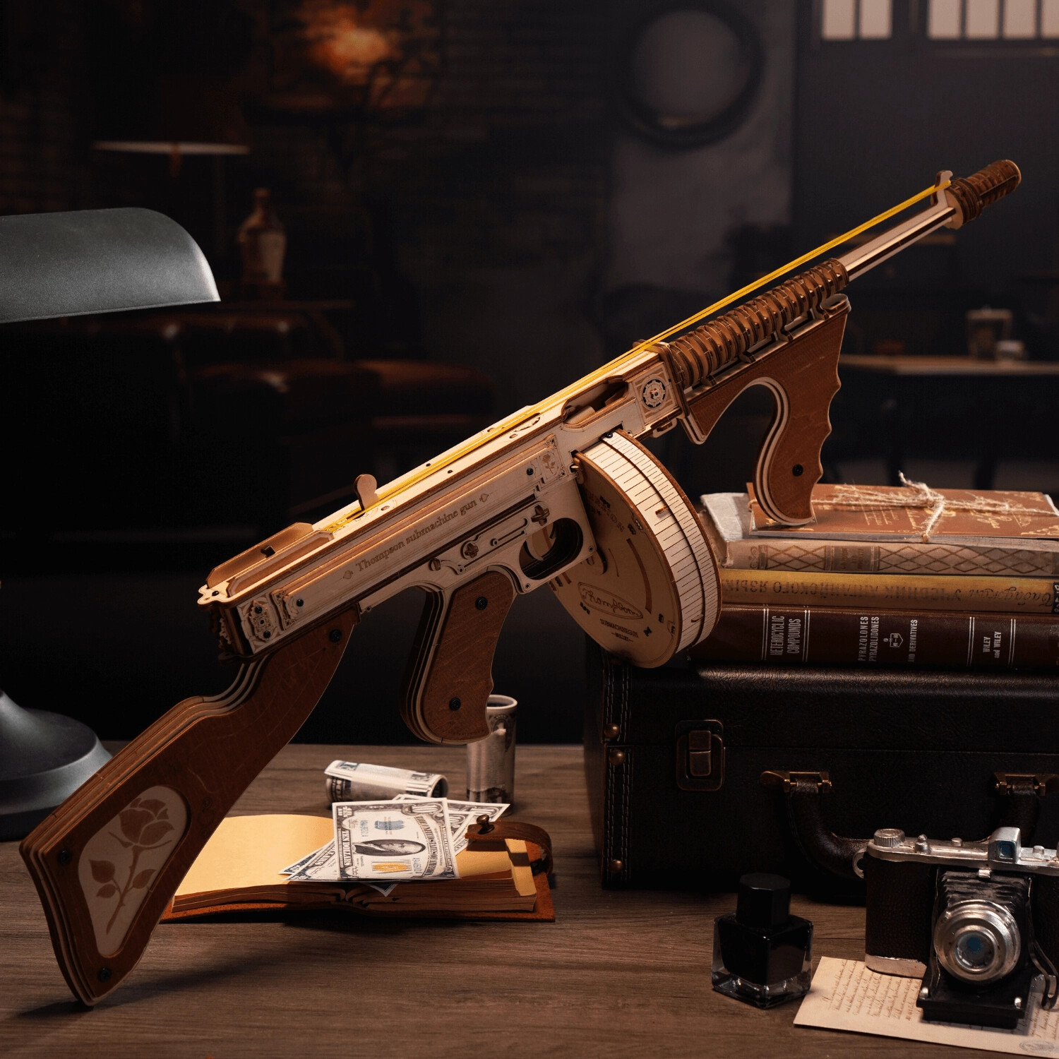

Submachine Gun-LQB01
Unable to fire after assembly
1.Rubber band aging: Try replacing the rubber band.
2.Rubber band cannot be fired: Pull the trigger and the upper slide.
If the upper part cannot be pulled at all:
①Part A16 is unhooked, and re-hook it.
②H19 is loose. Press it well or or it is too loose.
Solution: Replace Part H19.
Press it well again.
3.The rubber band cannot be fired (or get stuck when sliding forward ):
①Check the waxing of the front and back sides of the four J2 to see if they are waxed completely (try after removing J2, if it works, improve by waxing).
②Check if Screw P13 is tightened too much, causing friction on the inside.
Solution: Loosen the screw.
4.Could fire before, but now cannot:
(1)No response when pulling the trigger:
①A16 is unhooked, and re-hook it.
Solution: Replace Part H19.Press it well again.
(2)The hook cannot be fixed.
①Screw P12 is tightened too much, causing the spring to break.
Solution: Replace the damaged parts and loosen the screw.
②Wear and tear on I13 and I11.
Solution: Replace the wooden boards.
5.Shells(Round wooden sticks) are stuck:Check if Part A8 is assembled reversely.
