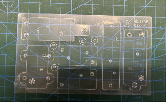

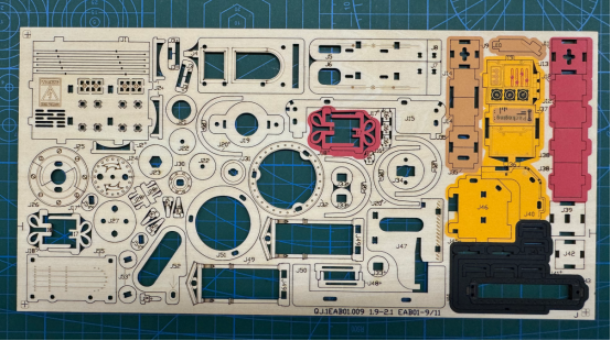

Problems of Parts
  1. Board R.
  1. Board J.

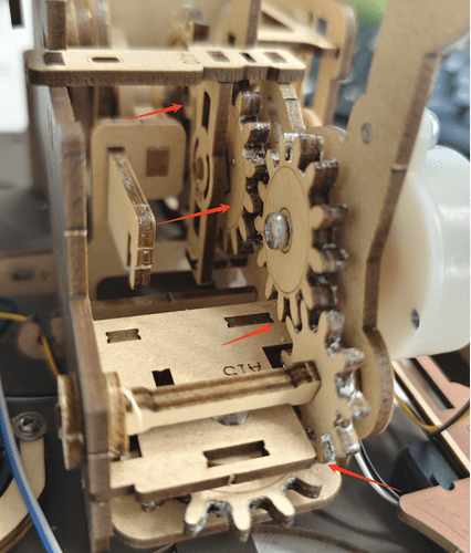

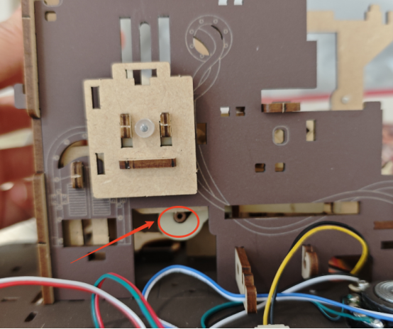

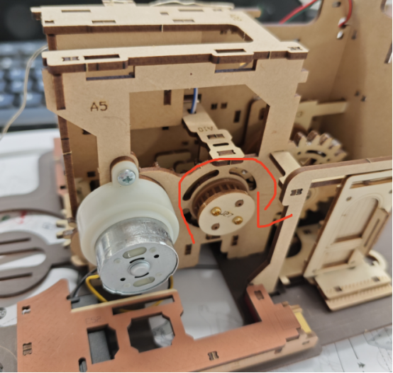

  1. The motor does not rotate / The gear does not rotate / Rotation is stuck.
① Blocking protection program: the first time to run the gear set is too dry will trigger the program, please click to restart.
② check if the terminals are inserted reversely, wrongly or tightly (pinch the head of the terminals, and shake to disassemble in order to prevent wire breakage.)
③ Check if the gear is waxed sufficiently.
④ Check if H3 is waxed, and use a screwdriver to pick and check if it is stuck.
⑤ Check if the position of the upward mechanism is above the brown plastic column.
⑥ Check if the gear in front of the motor is stuck, click to start and turn J27 clockwise.

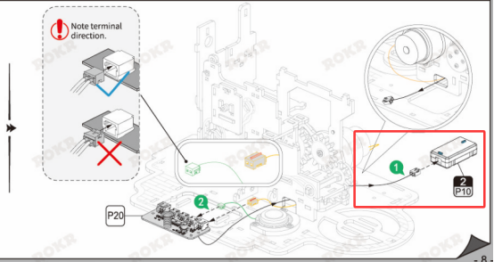

  1. No reaction.
① Check if the terminal cable is inserted into P10.
② Any parts malfunction: contact customer service to re-issue the parts.
