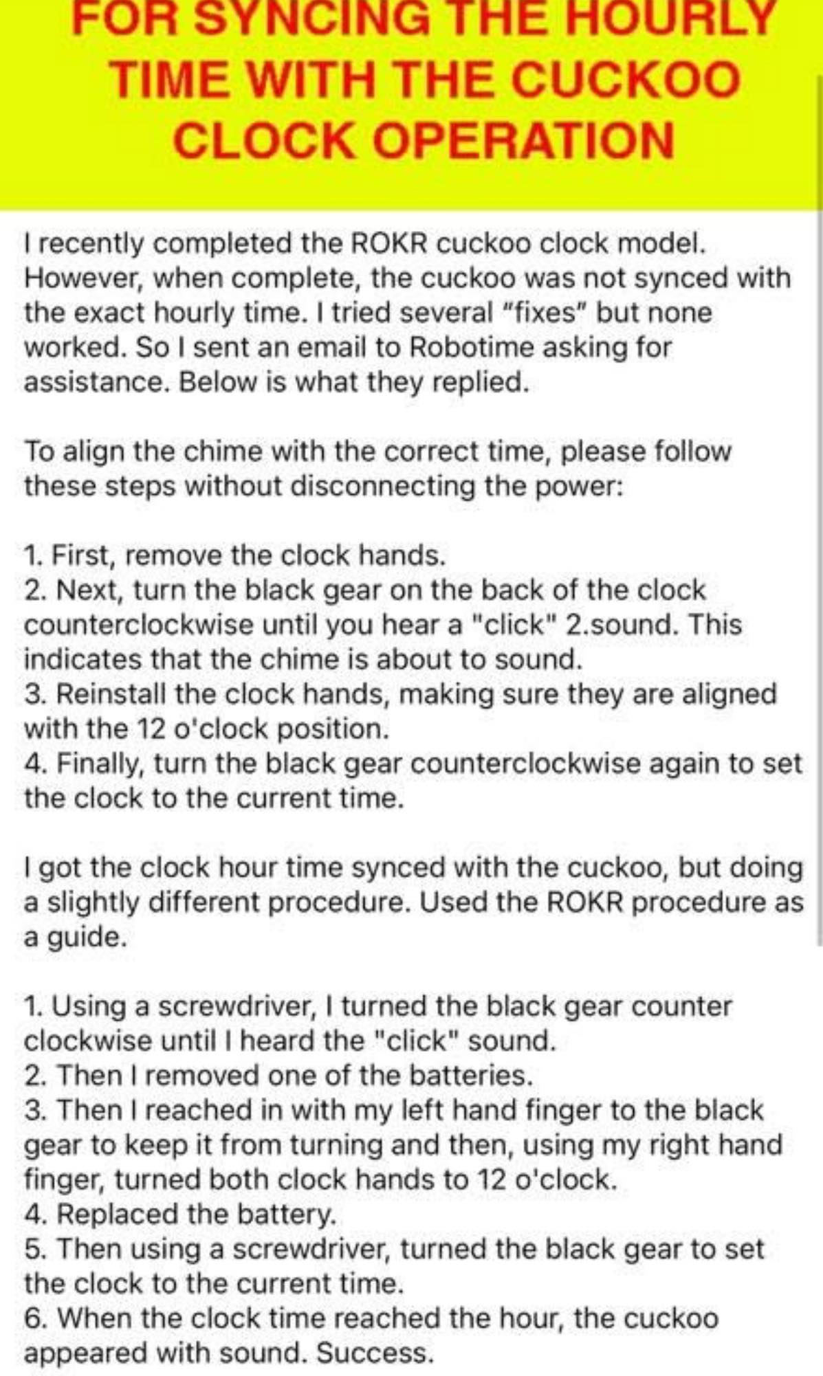

Hi guys, I just had the best time assembling the cucko clock, everything was perfect until started chiming at 45 min, not o’clock. I guess I did something wrong on testing everything at very beginning.
Any idea how do I get to fix this now the whole clock is finished?? I need to have the hour no the cuarter :sweat_smile:
Here you go. Hope this helps. Several have used this method with great success. Welcome! @wilson_murillo_monte
