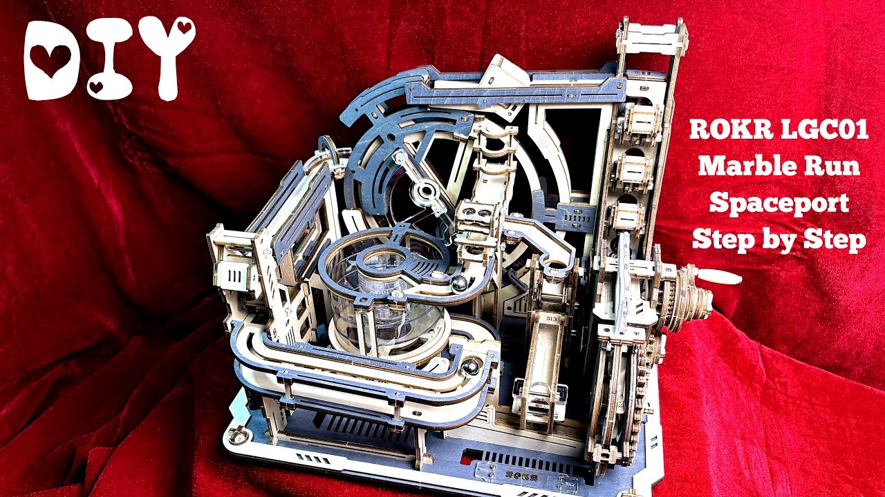

do you mean the order of the vertical plates?
I doubled checked those when building and crossed checked against working examples on youtube videos like:
This looks the same.
Any details on what do you think does not fit properly?
I didn’t see it directly, so I’m not sure. You have a tutorial video; try comparing it. I think there was a misalignment, which is why the ball didn’t go in.
