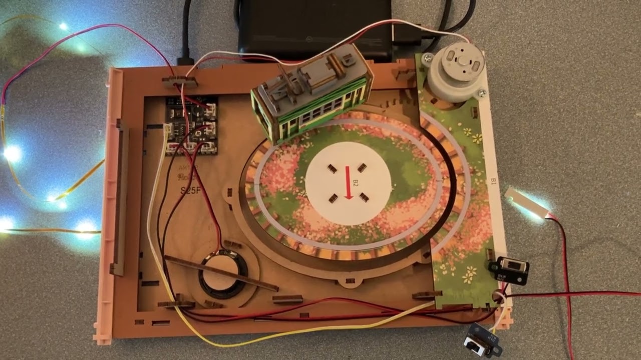

This test shows the motor and speakers operating. It took some adjustment to get the tramcar running smoothly on the track. I needed to raise the back edge from getting caught on the scenery.

Great work! The top of my tram was catching on some petals and inahd to adjust that part a bit!
Yes. I am experiencing the similar issues. I will probably have to remove the top arm extender piece from the tram because of it getting caught. I’ve been really careful to keep it running freely.
I’m not sure if I’m missing something or if it always catchy like that for everyone.
I think I might have put some petals a little low. The top piece also seems like it’s lose so I’m going to glue it on and see if that helps and try and trim the leaves where it catches. It only ‘just’ hits for mine and not even every time.
I know my pedals are in the correct spot. The main issue is that the tram wobbles(not sure why,probably because I raised it up so it wouldn’t hit stuff on the floor)and that causes it to get the extensor arm caught really bad.
Without the extensor arm it is clearing everything.
That sounds like its probably the reason, my tram wobbles a little too but not badly. I will try and remember to take a video of mine tomorrow!

Nice to see it is working well. Can you fix the tram car from moving side to side or it that supposed to be like that?

I’m not sure. I’ve been trying to adjust it. If I put it too low it gets caught on the ground and if I put it too high it gets caught on the trees.
Some of the scenery seems like it is made to catch on the tram. I wonder if they were tying to make it look like the tram is going over bumps for realism.
Have you seen YouTube video’s of others to see if it is supposed to be like this.
I could try looking at videos of other builds. I definitely want it to be right before I enclose the whole thing.
