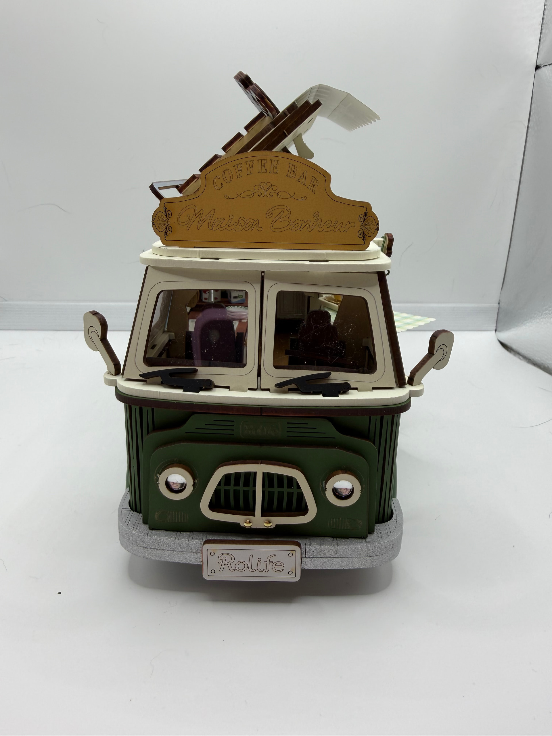

Leo’s Coffee Truck is officially finished, and I have to say, this kit absolutely charmed me from start to finish. The design is solid, the theme is delightful, and there are so many thoughtful details packed in. I especially appreciate the different cup designs—and the fact that they included a tiny espresso to go inside one of them. That attention to detail is fantastic. The small details like the napkin to wrap the croissant in show real care went into this design. The wheels actually move, the USB-only power setup means no battery hassle, and I really enjoyed building this one from start to finish.
That said, like any build, I learned a few things along the way. Here are some tips and tricks that might help if you’re building this one:

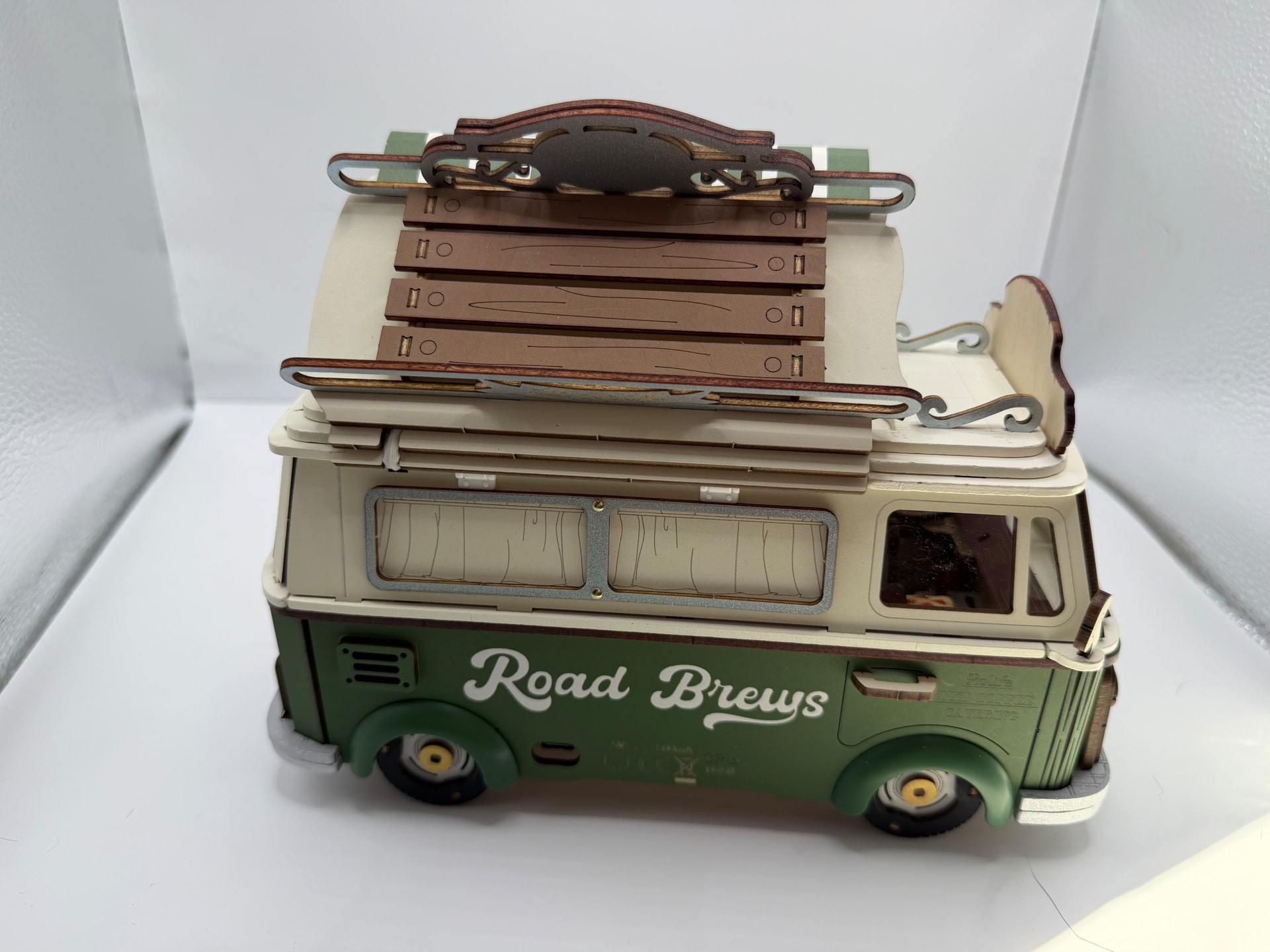

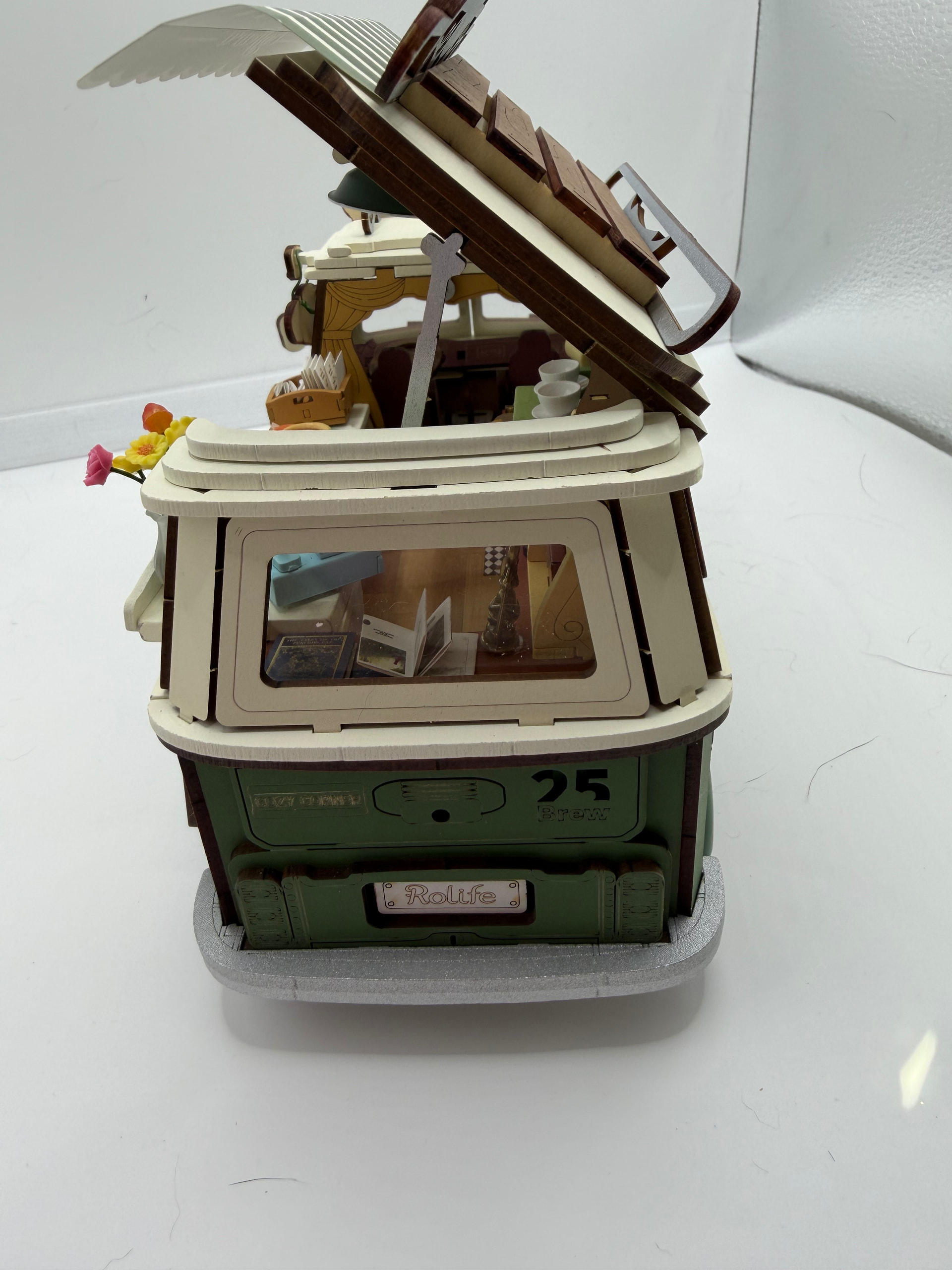

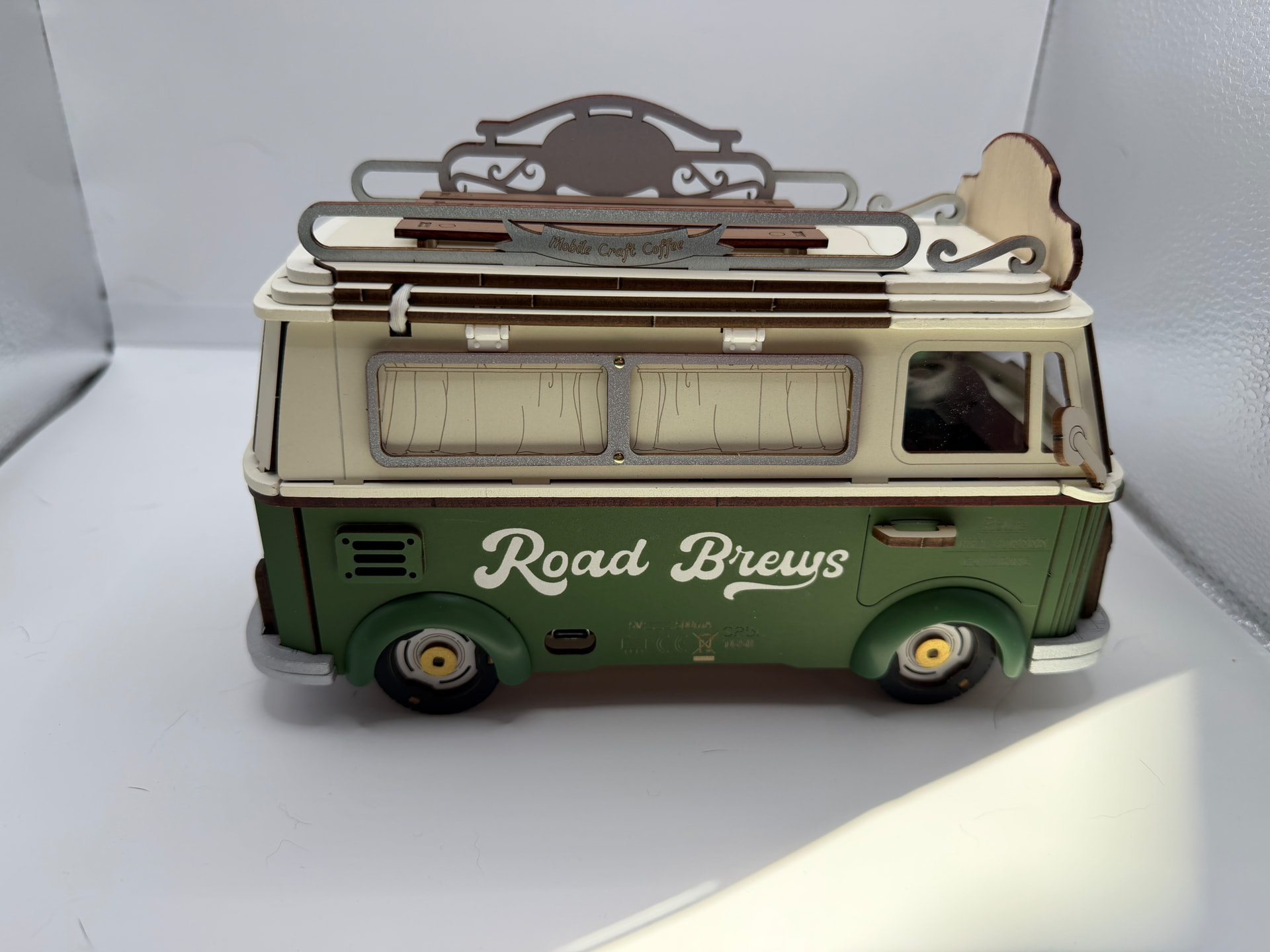

Gluing strategy matters: I wish I’d known upfront which pieces needed to stay functional versus which could be permanently glued. The truck is designed to fold up and close, so after my initial close-down, I figured out which pieces needed to be modified or moved to make it work properly. My advice: plan ahead for the closing mechanism and test your fit before gluing everything in place. It’ll save you from having to troubleshoot later.

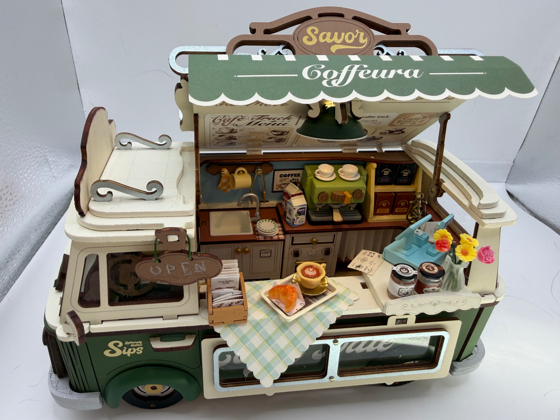

Keep the counter setup flexible: There are two parts to the counter—the cash register part that slides in and out, and the stationary part with the tablecloth. The items sitting on the counter need to come off in order to close it, so I attached them to the paper tablecloth instead. I didn’t tape the tablecloth fully down, just a tiny bit to keep it from moving around, so I can still lift the whole thing up as one unit. This way, I can remove everything that needs to move without having to take individual pieces off. It keeps things more stable and makes the whole closing-and-opening action way easier to manage.
That plastic light trimming tool is clever: In step 22, you’re building a little wooden tool that uses one of the pieces you previously worked with for pushing rivets. It looks like you’re assembling a light fixture at first, but really it’s designed to trim the top off the light cover evenly. I used scissors and ended up bending the plastic and making the cut wonky. A knife would’ve given me a much cleaner result, and I’d recommend following the instructions carefully on this step so you understand what it’s for.
Plan for how you’ll display it: Small pieces kept falling off as I repositioned it for photos. Decide upfront whether you’re going to make it a display piece that stays in one spot or if it’s going to travel, and glue and tape accordingly. That way you’ll know what to secure and what to keep loose.
All in all, I’m really happy with Leo’s Coffee Truck. It’s got personality, charm, and that perfect café-on-wheels vibe. Have you built this one yet or want to? I’d love to hear!
