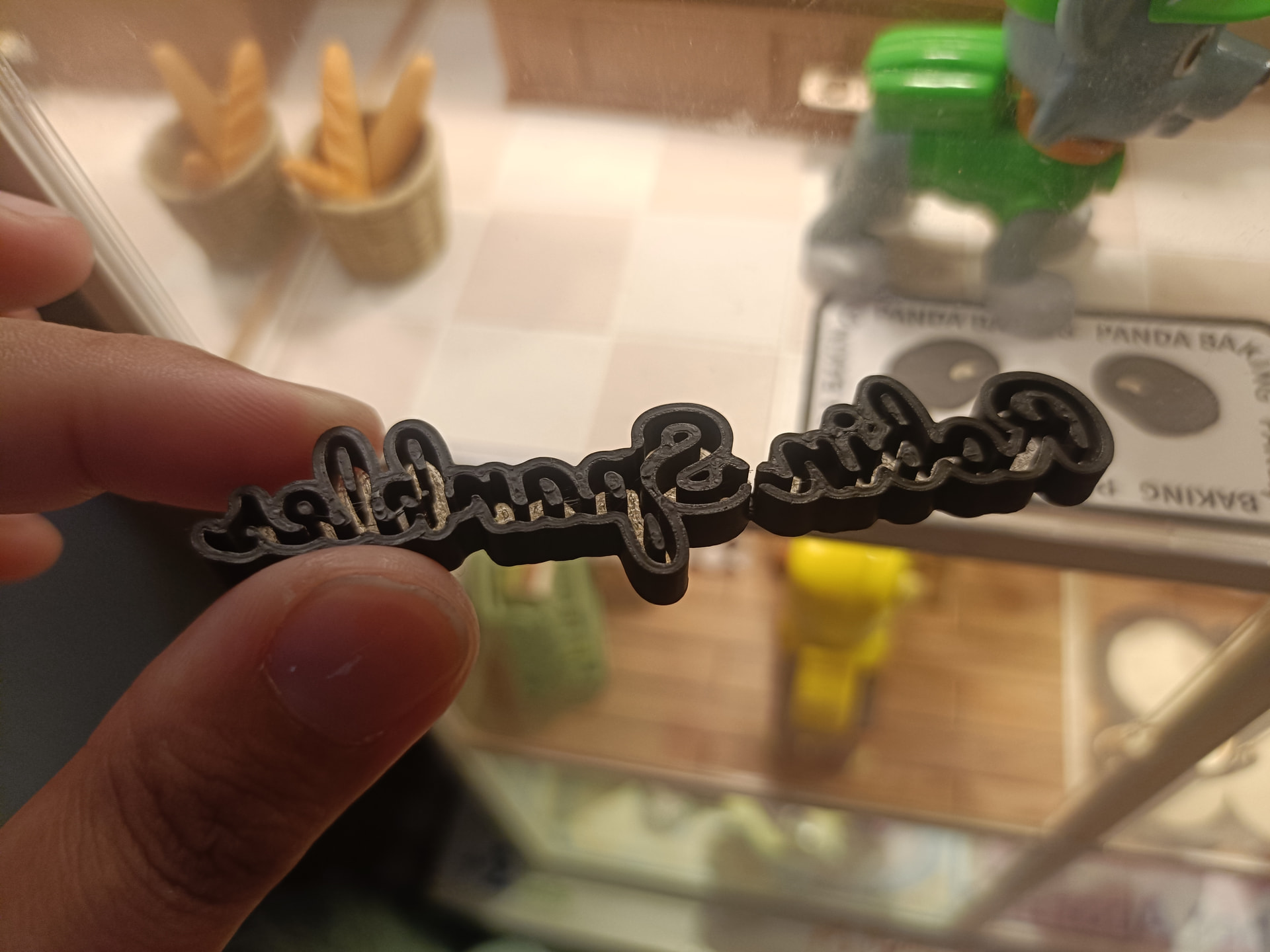

What I thought of is a neon sign with my daughter’s name on it. I 3D-printed this small neon sign and have already bought a 1mm thin but long LED COB light for it in electric pink color. :star_struck:

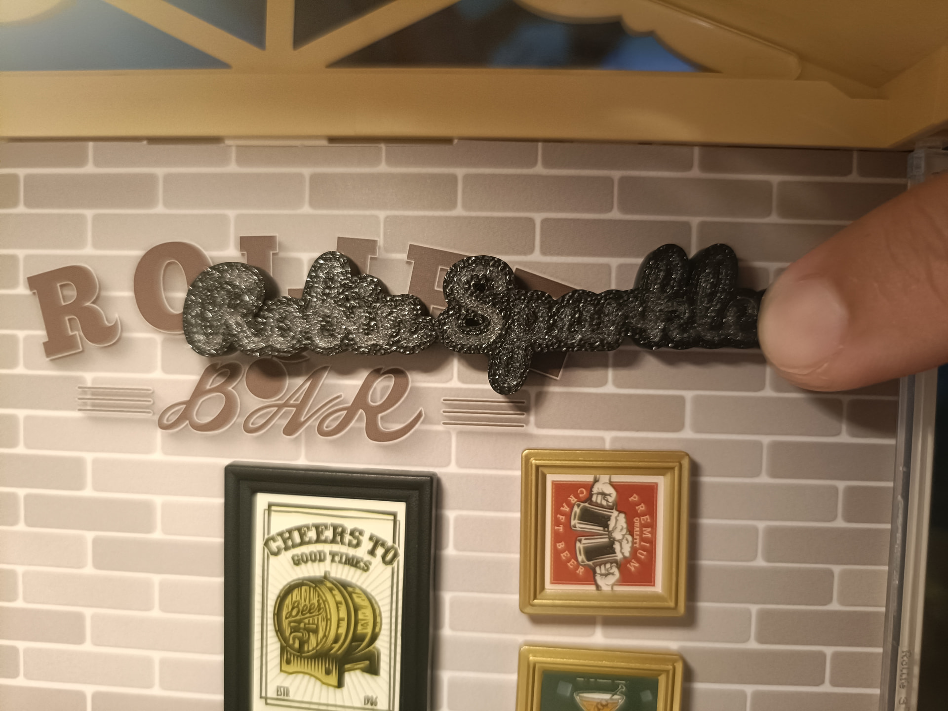

Thank you! After I figured out how to put the lights properly, I will then print a back panel for this signage. I will add 2 pegs on the panel that can connect to the wall of the Super Creator kit just like how the vanity mirror is attached to the the wall like:

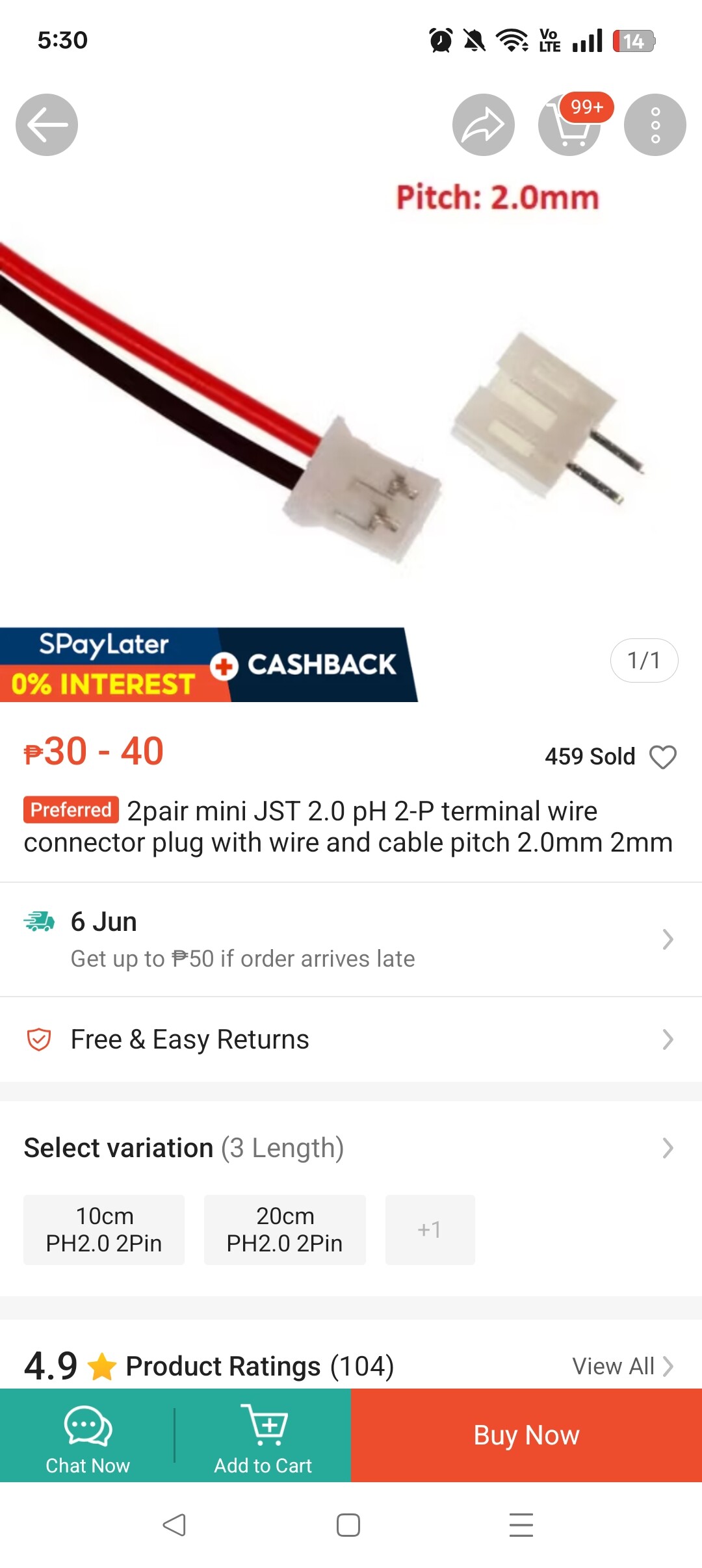

Hello @Martins_Assembly_H ! Actually the 1mm COB LED strips I am seeing online can be bought with a USB end but what I wanted to do is connect the 1mm cob led to a wire with a preconnected JST male connector at the end. Basically, I want to be able to plug it in the back of the power switch included in the Super Creator kits (the aircon units at the back) so that I do not need to plug this mini neon sign in a separate USB port.
What I do not know is:
The size of the said JST male connector so that I can buy a wire with a pre connected JST male connector at the end.

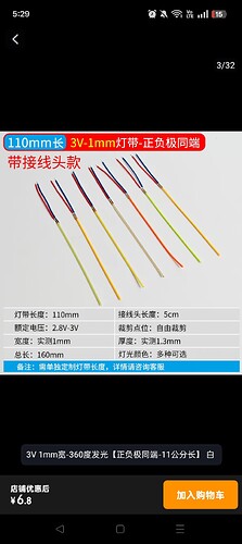

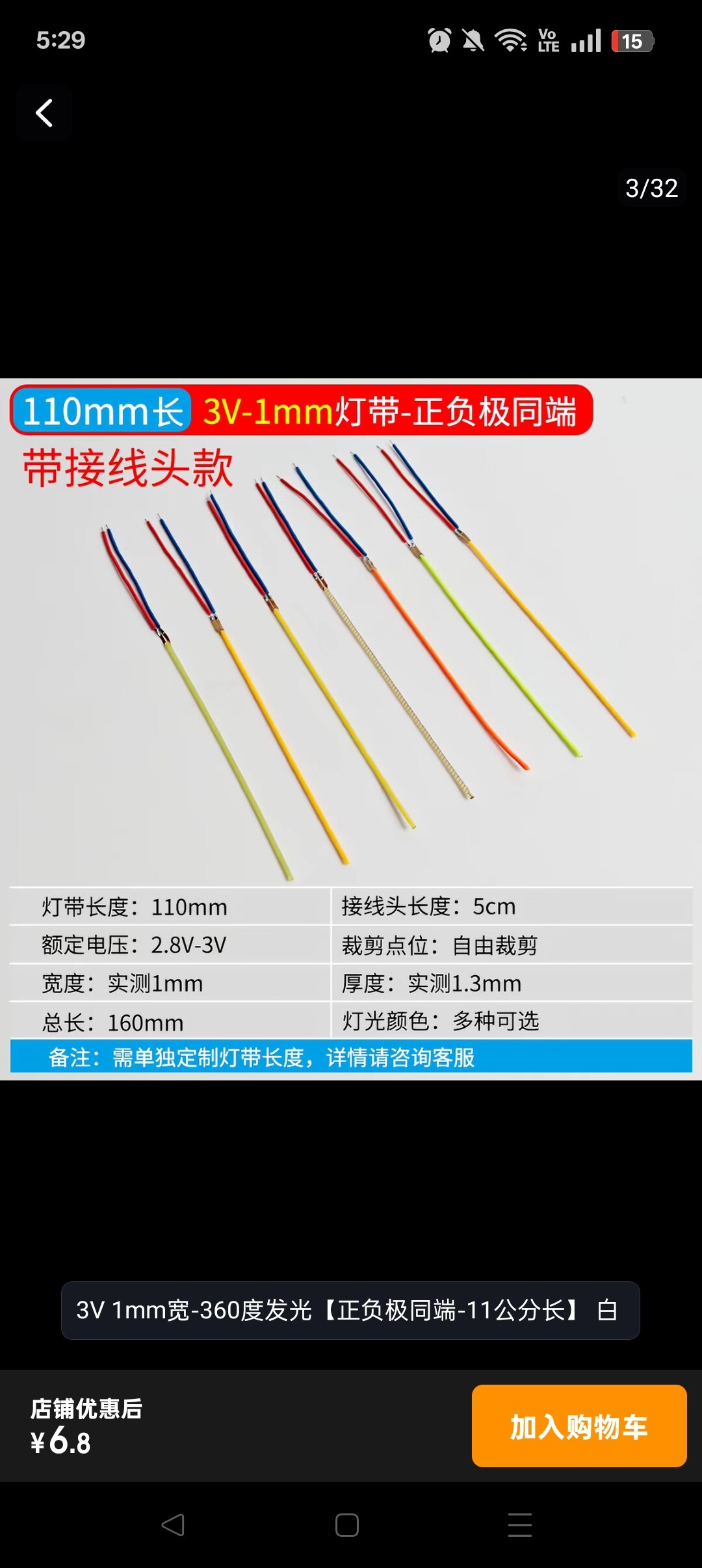

Which then I plan to connect to the end of the cob led that looks like this:
There are 3V and 5V options for these lights so I’m not sure which one is best to use.
Then the JST connectors like:
which I do not even know of they are the correct size for the Super Creator power switch.
Thank you! I think the 1mm lights would fit just fine as I have modelled this to fit 1.25mm strip inside with enough thickness in case a part of the led strip needs to go above each other on certain strokes of the font style. I do not have an extra wire or light that came with the Super Creator that’s why I am asking what the size of the JST is. I wanted to connect this at the power switch of the Super Creator (the aircon unit at the back) so it will be connected the same way as the official light that came with the kit.
