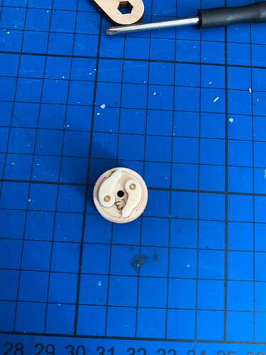

When building this part of the gramophone, I noticed the system does not work as ratchets tend to go towards the center. Has anyone experienced this issue? Thanks
[img]

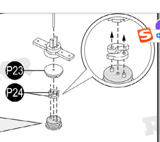

[img]

Without installing the P23 part, this position can’t be fully secured. Please align it with the pattern, install it in place, and then attach the P23 part on top.
Thanks a lot to all of you ! I indeed also installed P23, the thing is that the rachets will still go towards the center when the piece is held vertically. But I guess it acts as a clutch and the centrifugal (spin) force would push them out to engage? Thanks again and sorry for my late reply
