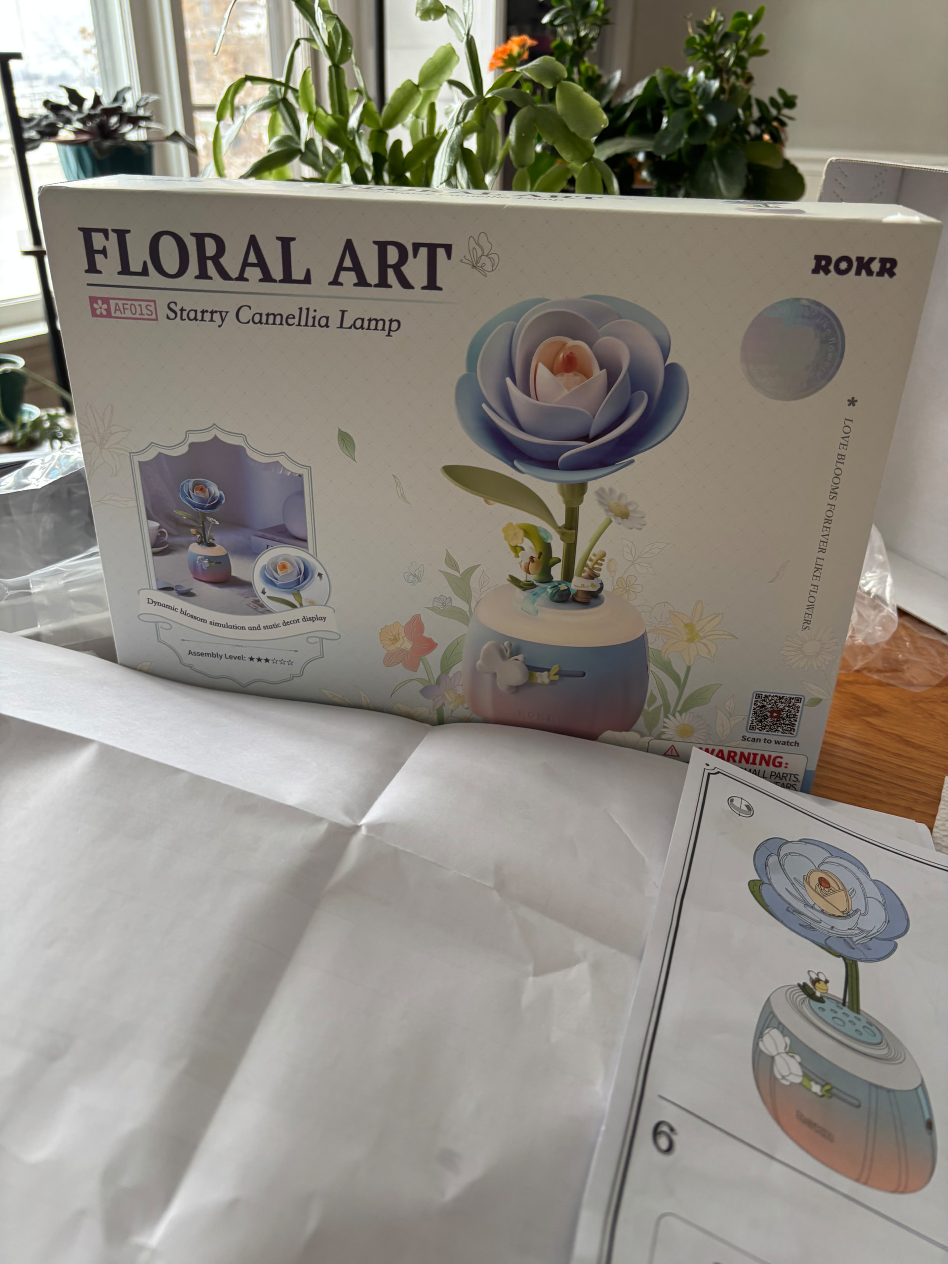

I really need help. We just put together both of these flowers and neither of the flowers has movement. We have followed the instructions and have torn them back apart and we just can’t figure it out. The bee moves up and down a little bit, but the flower doesn’t. The part inside is moving in a circle…just doesn’t open and close the flower.

Just took my instructions out, did you put in the white connectors in the right way and I think it may also have something to do with part P9/P14/P15 you have to adjust and how tight you screw them
Connectors are correct because light works and the disc inside is rotating. I’ll check the parts you mentioned
Those parts appear to be correct.

It seems like the set screw in the stem isn’t gripping the rod inside the stem. When I tighten the set screw, the flower can still be pulled off the rod.

I think is the connection part… I came across this happened… don’t tighten the set screw, it will make the flower stop blooming…
