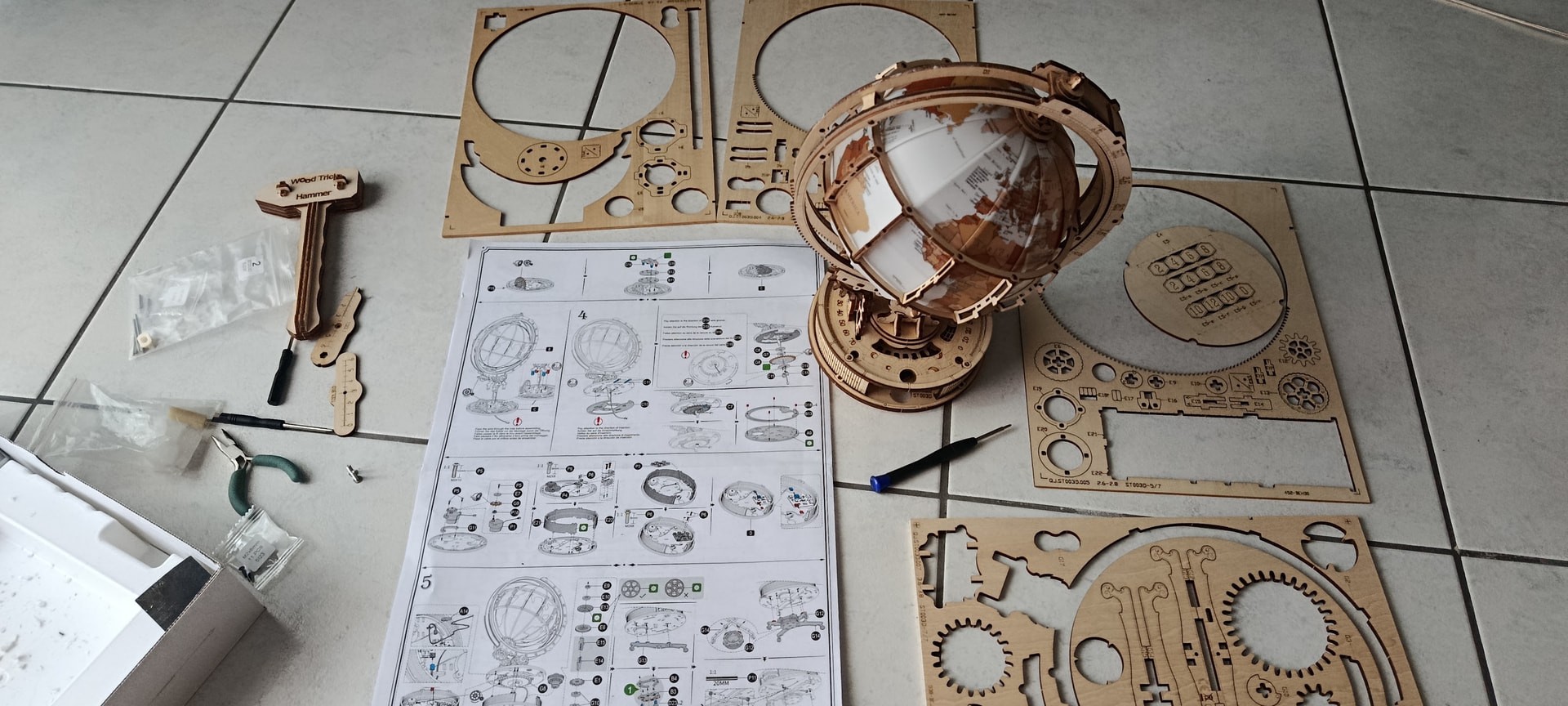

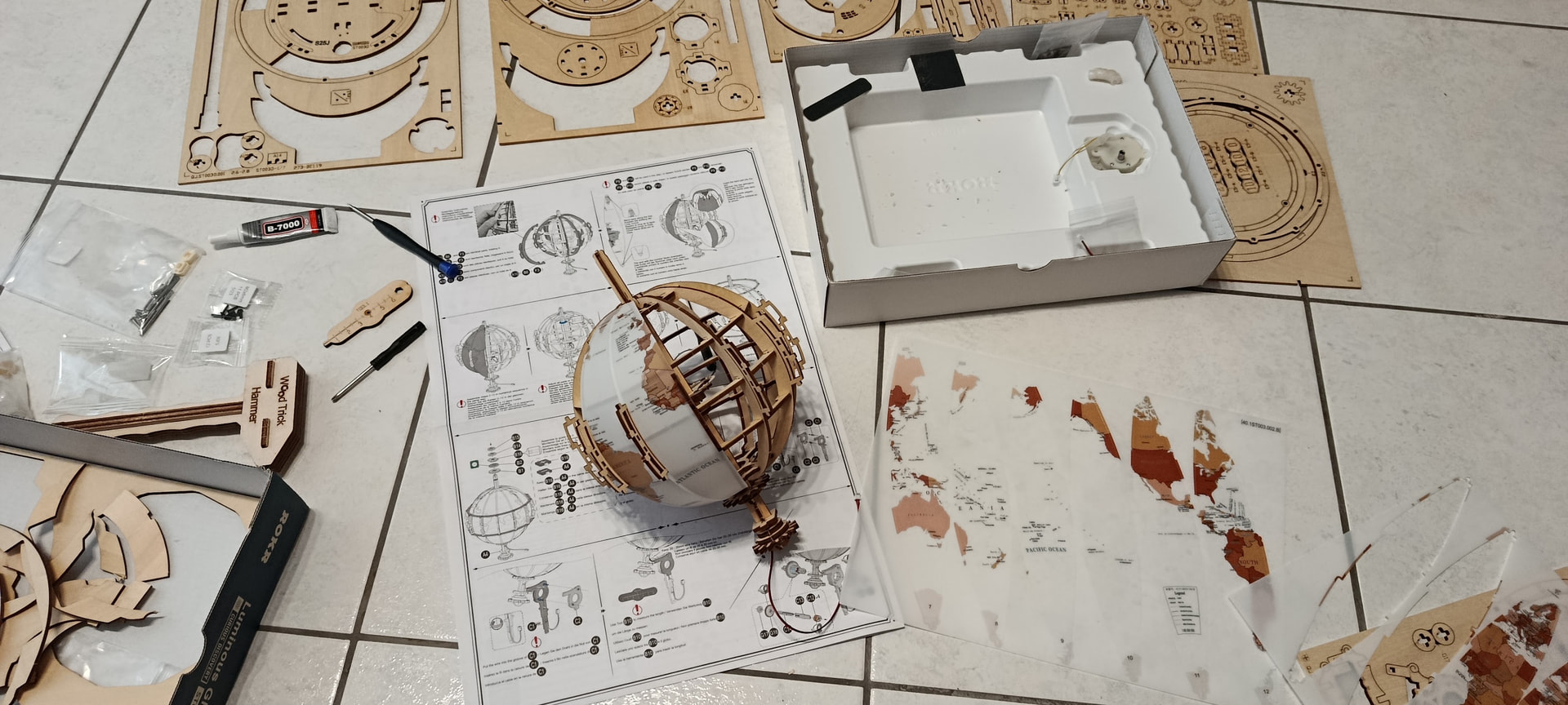

As usual, ground setup!

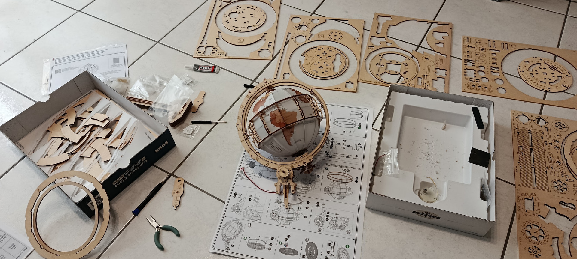

Progress was very fast, and there is something soooo satisfying seeing the sphere part take shape:
Also making it spin. So so so satisfying, weeeeee

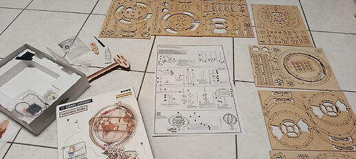

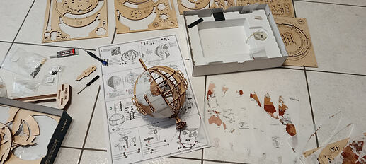

Ahem, assembling the… things. I don’t really know if they have a name, the arches?
The meridian lines?
Anyway, assembling those!

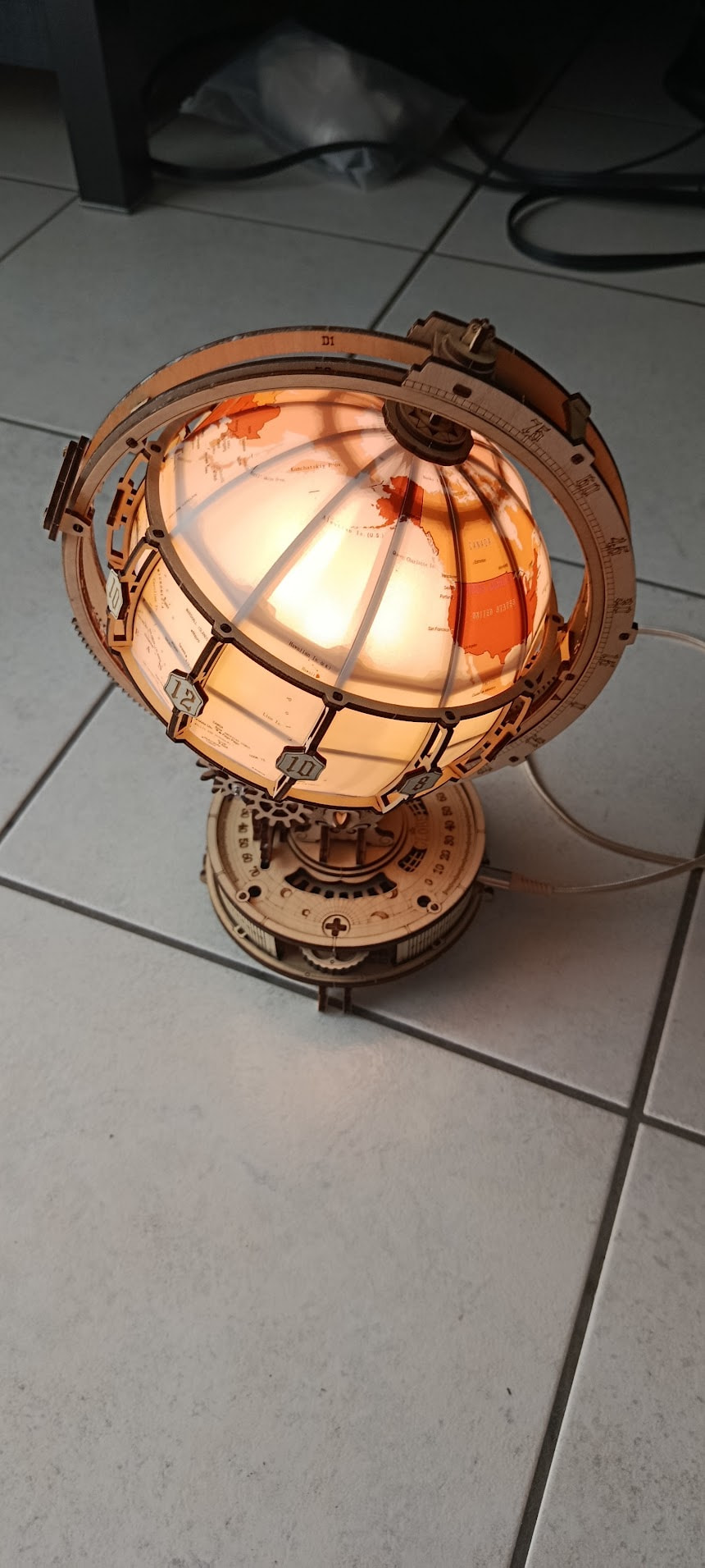

Nearly there, just need the finishing touches on the base
And we’re done!!! And there it is spinning as well!

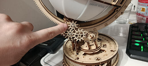

Now to the question: can it spin manually:
No. It’s not like the gramophone, the motor is connected with gears all the way to the globe itself, and the motor lock when not on and spinning. So it’s not made for manual spinning.
BUT! I never let ‘isn’t made for’ stop me before! And the solution for that one was incredibly simple!
This gear right there:
Is supposed to use a medium sized rod as an axis. I switched it for the longest sized rod of the kit (there’s more of it than necessary, love having backup pieces :sparkling_heart: ) which now allow me to push or pull the gear out or into the “system”.
If the gear is in, the motor can spin the globe when turned on. If the gear is out, I can manually spin the globe by hand, freely.
Ta-da! :face_savoring_food:
