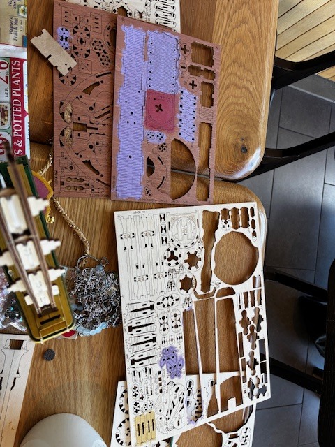

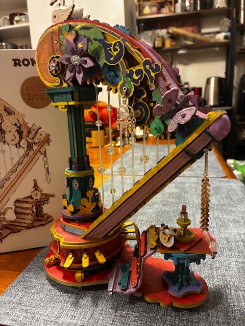

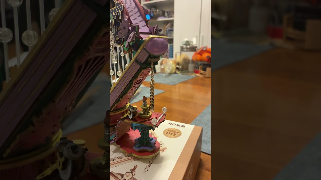

This was easily one of the smoothest and most satisfying builds I’ve completed, and it genuinely exceeded my expectations from start to finish. The ROKR Harp stands out as a thoughtfully engineered kit with an exceptional level of detail that becomes more impressive the deeper you get into the build. Every layer feels intentional, and nothing comes across as filler or unnecessary complexity.

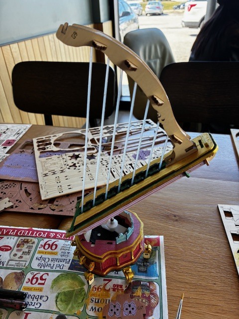

What truly elevates this piece is the ingenuity behind the mechanics. The use of O-rings to simulate harp strings is not only clever but also highly effective, and the addition of beads to visually represent the plucking action is a brilliant design choice. Watching it function after completion gives a real sense of life to the model—it’s not just decorative, it’s interactive in a way that feels meaningful and refined.
Compared to the ROKR Piano, this build felt significantly more straightforward and enjoyable. The instructions were clear, the sequencing made sense, and the parts fit together cleanly with minimal resistance. There were no frustrating bottlenecks or moments where I had to second-guess the design. It genuinely felt like a “flow state” build where everything just clicked into place.
A couple of practical tips for anyone planning to assemble it:

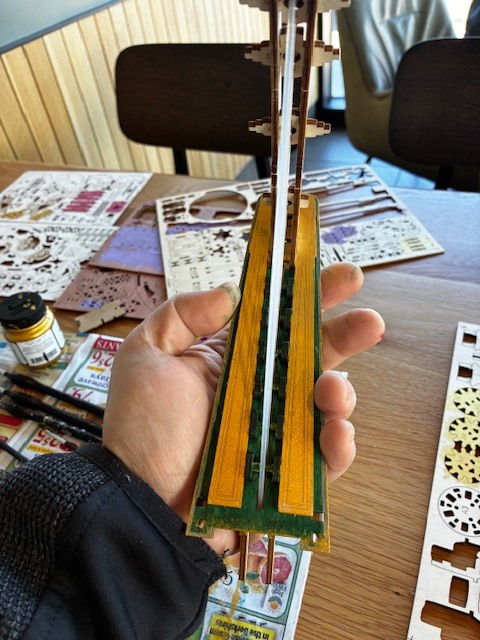

  • Lightly waxing the plastic components that interact with the strings (the plucking mechanism) noticeably improves performance and smoothness. It makes a bigger difference than expected.

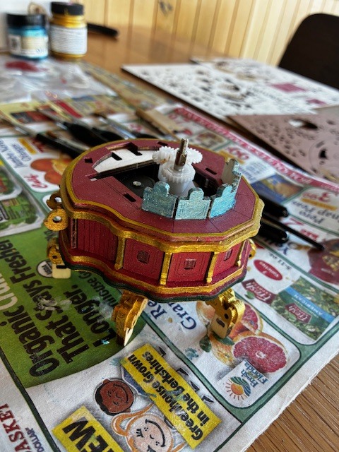

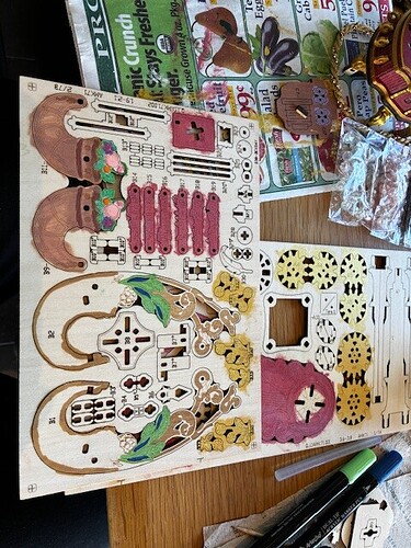

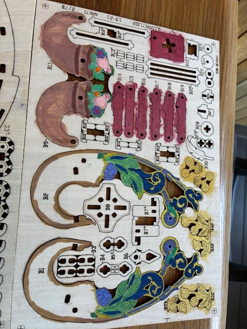

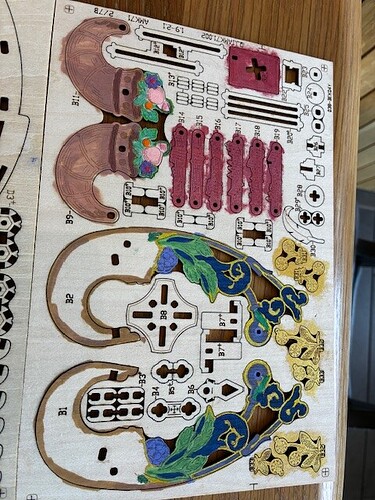

  • If you’re planning to customize with paint, many of the wooden panels can be painted before assembly. Looking at my version should give you a good sense of which parts are safe to prep in advance—it saves time and gives a cleaner finish.
  • The finished model is slightly back-heavy. I strongly recommend attaching it to the base early or adding a bit of weight toward the front to stabilize it and prevent any tipping.

I will be showcasing my instruments playing soon with their respective Nanci dolls.

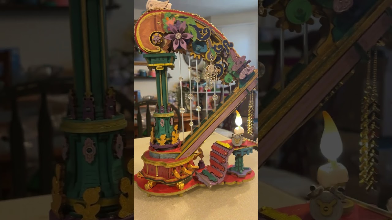

New VERSION with gold trim on top and candle light

Wow! Well done! I have been doing this one for the past week and am ready to throw it out the window! All the little plastic “stoppers” are breaking despite using the tool and gently putting them on. It’s almost like the rods are too thick and they are breaking them apart. I’m not sure what to do as the gears rely on the stoppers. I really love the colours you have used, absolutely stunning!
Just gorgeous! Seeing yours in action peaks my interest for sure.
DId you look at the mushroom directional part. It times the plucking and maybe causing your issue>?
Omg that is so beautiful. Glad to see it works perfectly for you. I’m so eager to get this now. :heart_eyes:
Oh yes…I had that right in the first place. When I disassembled because it was plucking too hard on the longest string, one of the plastic pieces was in the wrong direction. I’m afraid I wont be pulling it apart again…BUT I might decide to do another.
I’m sorry to hear that those are giving you a problem. I don’t think those have ANYTHING to do with the gears and/or movement. They are only there to provide the string movement once in a while. I am pretty sure it would function perfectly fine without them

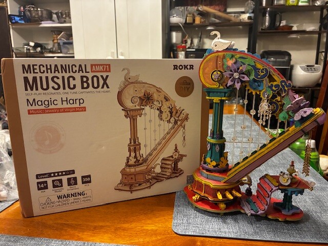

Yes, @Sasa . When Peter posted 3 or 4 AI images a while back, that photo was my inspiration. Some colors are similar and other details are very different. This was mine. Completion of Magic Harp
