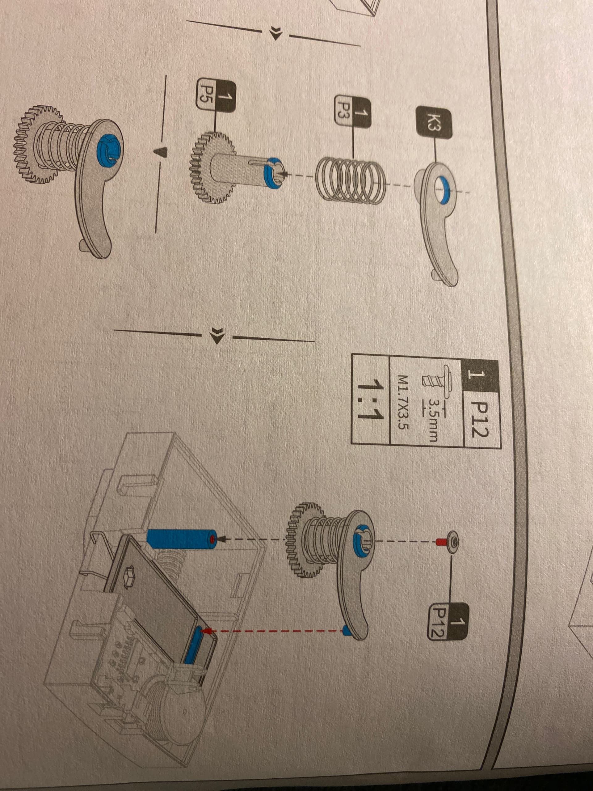

Check this part.
When installing the spring and the brown plastic part (K3) make sure you press it down showing the top part of (P5). It should move freely when you press it. Press it down all the way. And make sure it slide in the bottom little part of K3 slide into the tiny slot of K1.

Typically, this issue is caused by a malfunction in the K3 and P3 connection device; pressing down on K3 should resolve the problem.

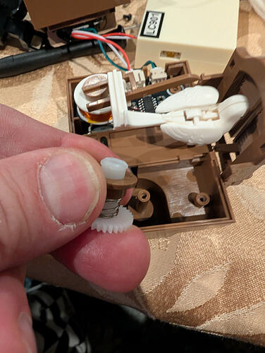

Hi. Just got the clock for Christmas. Just like the OP, my bird won’t come out during the test. I’m not sure what I’m missing with the k3 part. The motor moves but the arm doesn’t. I don’t see anywhere for it to catch on anything. The white cylinder moves but the brown arm is stationary.

I’ve just had this exact issue.
Make sure the two small metal wires that attach to the bottom of the doors are seated in their respective holes fully and correctly.
One of mine was not in fully and seemed to be putting some strain on the sliding tray mechanism, which in turn cause the brown plastic arm not to move.
Caused because that spring on the white cog shaft pushes up and causes friction between the collar of the white shaft and the brown arm therefore allowing the white shaft to turn the brown arm. If there is too much resistance (the metal wire on the door not seated properly, causing the sliding tray to be lifted slightly), then the white shaft just spins.
It’s designed this way such that if you held the doors shut and activated the cuckoo mechanism, the white shaft and brown arm will slip, thus not damaging the worm screw and cog.

I had exactly this issue. I see nothing I did different from the instructions, but K3 would not rotate with P5. I resorted to a small dab of glue to bind the parts together, that seemed to do the trick - hope it does not cause problems down the line. I am surprised more people did not run into this issue.
Here is an update. DO NOT use glue, that proved to be worse, it prevented it from turning in total. I had to sand/grind off the glue to get it free, and once I did that it worked, the cuckoo comes out. I think me adding and removing the glue added enough friction to help P5 catch with K3 and turn together an open the doors. In retrospect I think the issue was the spring was not providing enough tension to get the parts to spin together.
