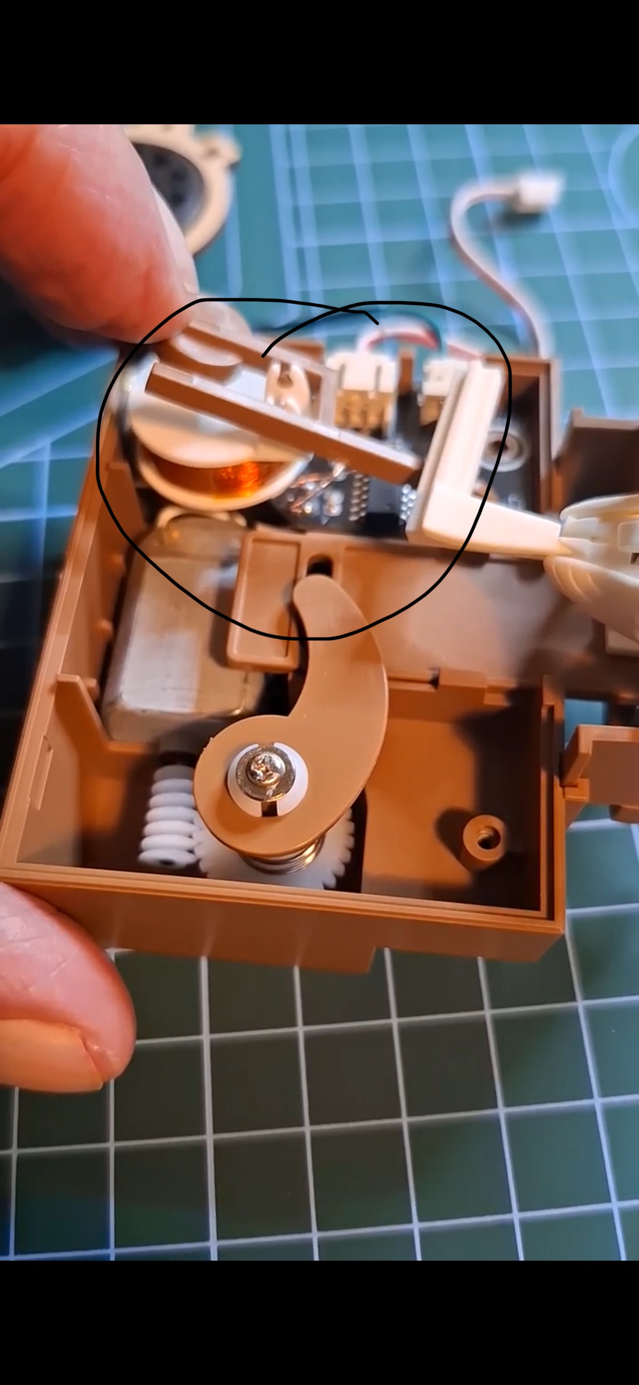

In my opinion, the problem lies in the area I’ve circled. This lever seems to be incorrectly installed.

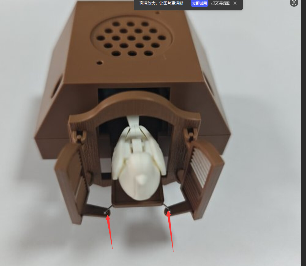

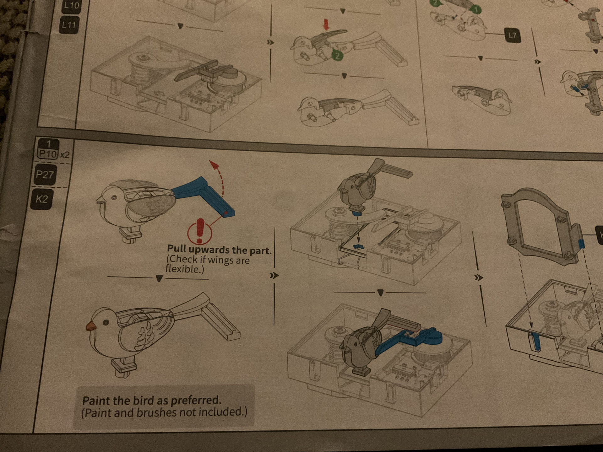

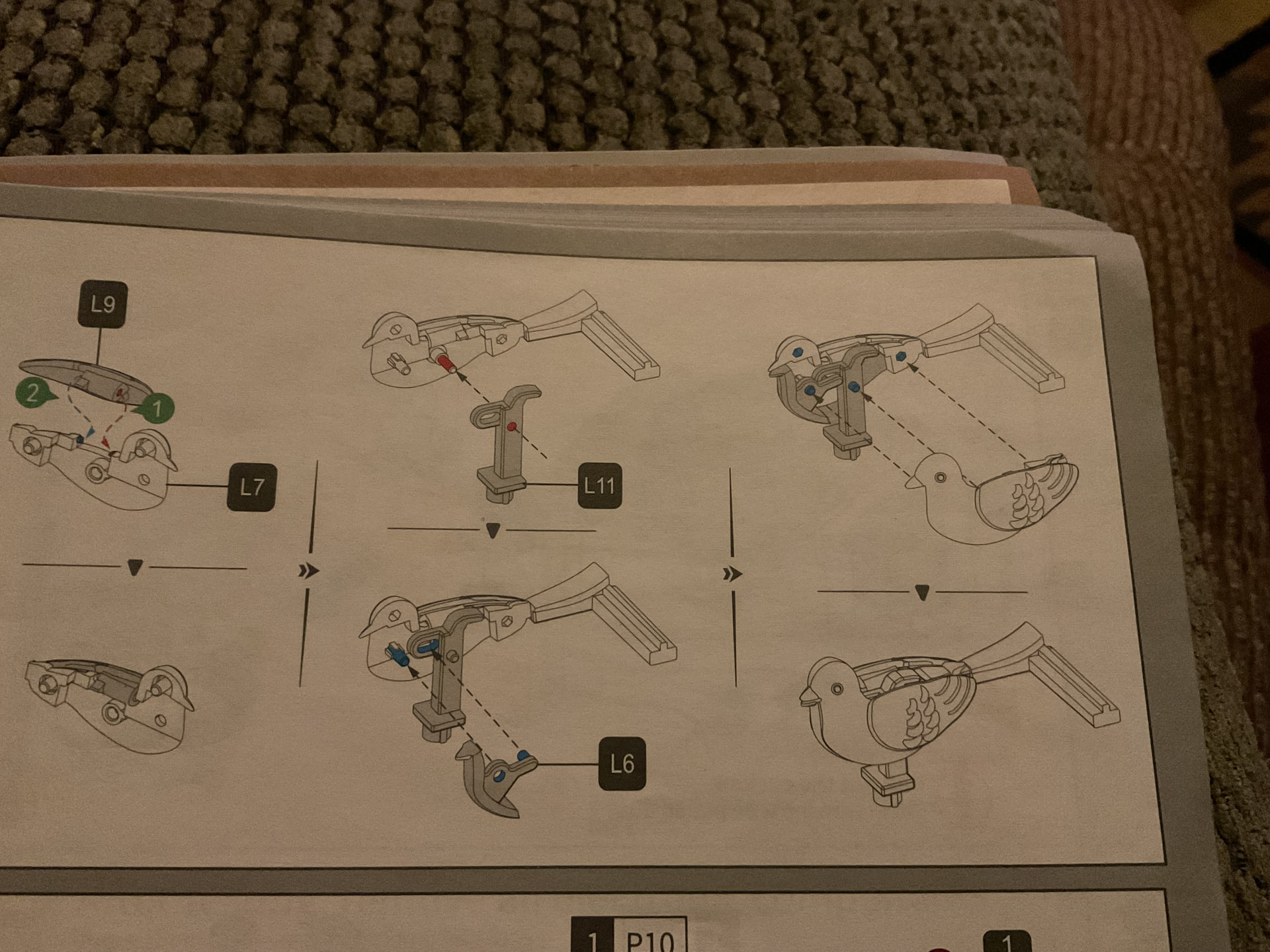

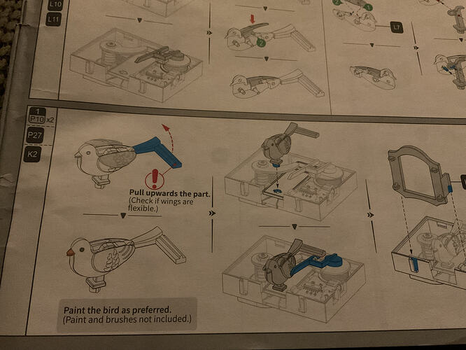

At first I thought it was that h piece not locked in but your cuckoo is set crooked and the wings do not look like they open. I would look at your cuckoo to make sure L6, L8, and L11 are all set properly. I will also let CS review!.

The jamming is most likely caused by the metal connecting rod. You can try removing the metal connecting rod to test if it can move in and out normally. Then reinstall it and push and pull repeatedly to locate where the jamming occurs.
