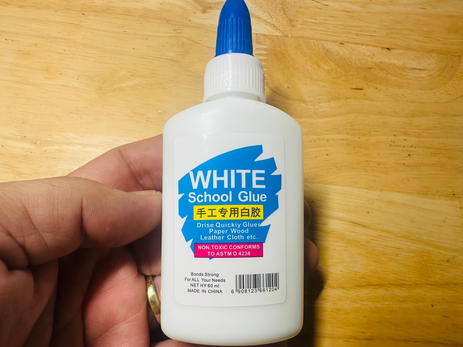

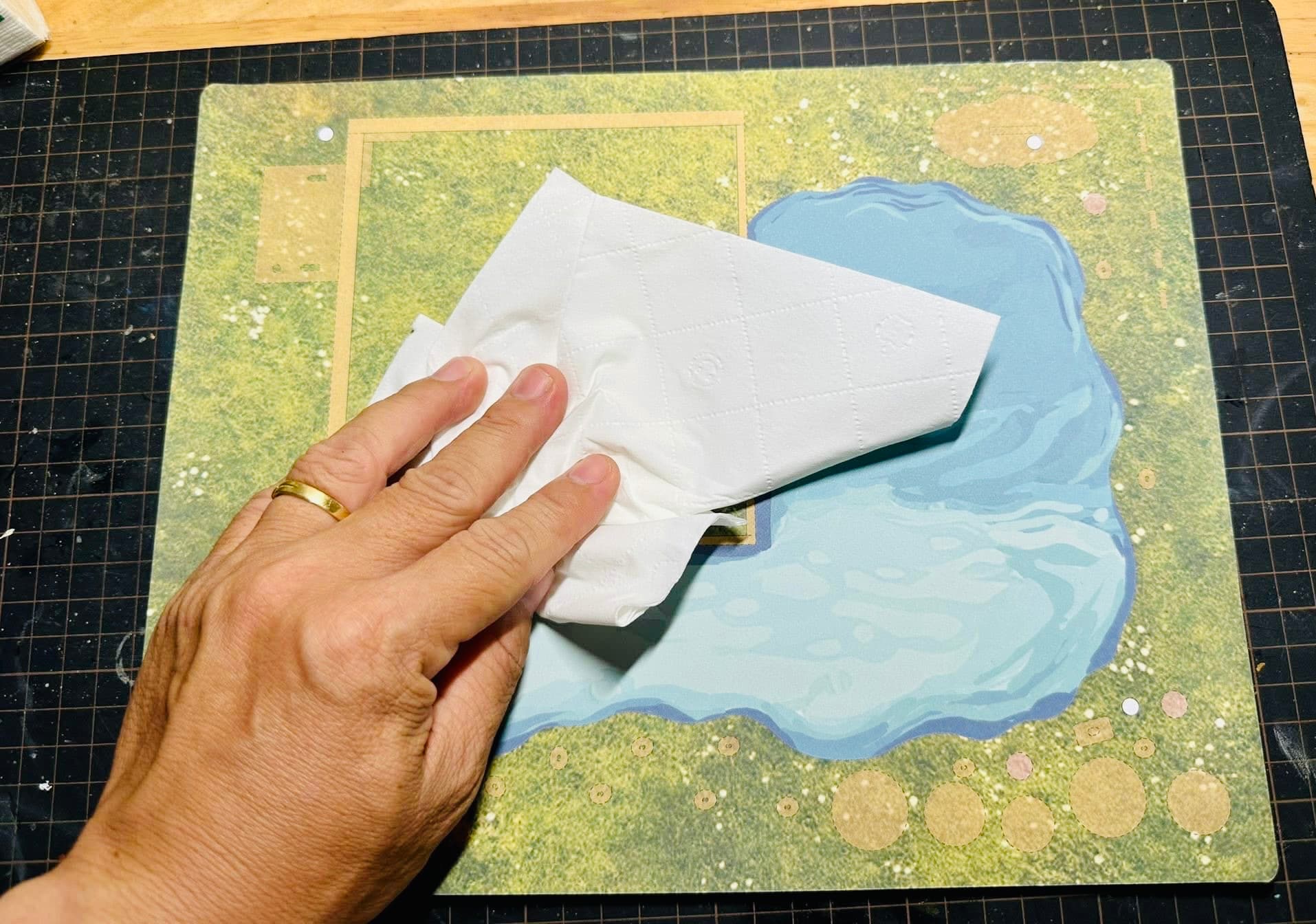

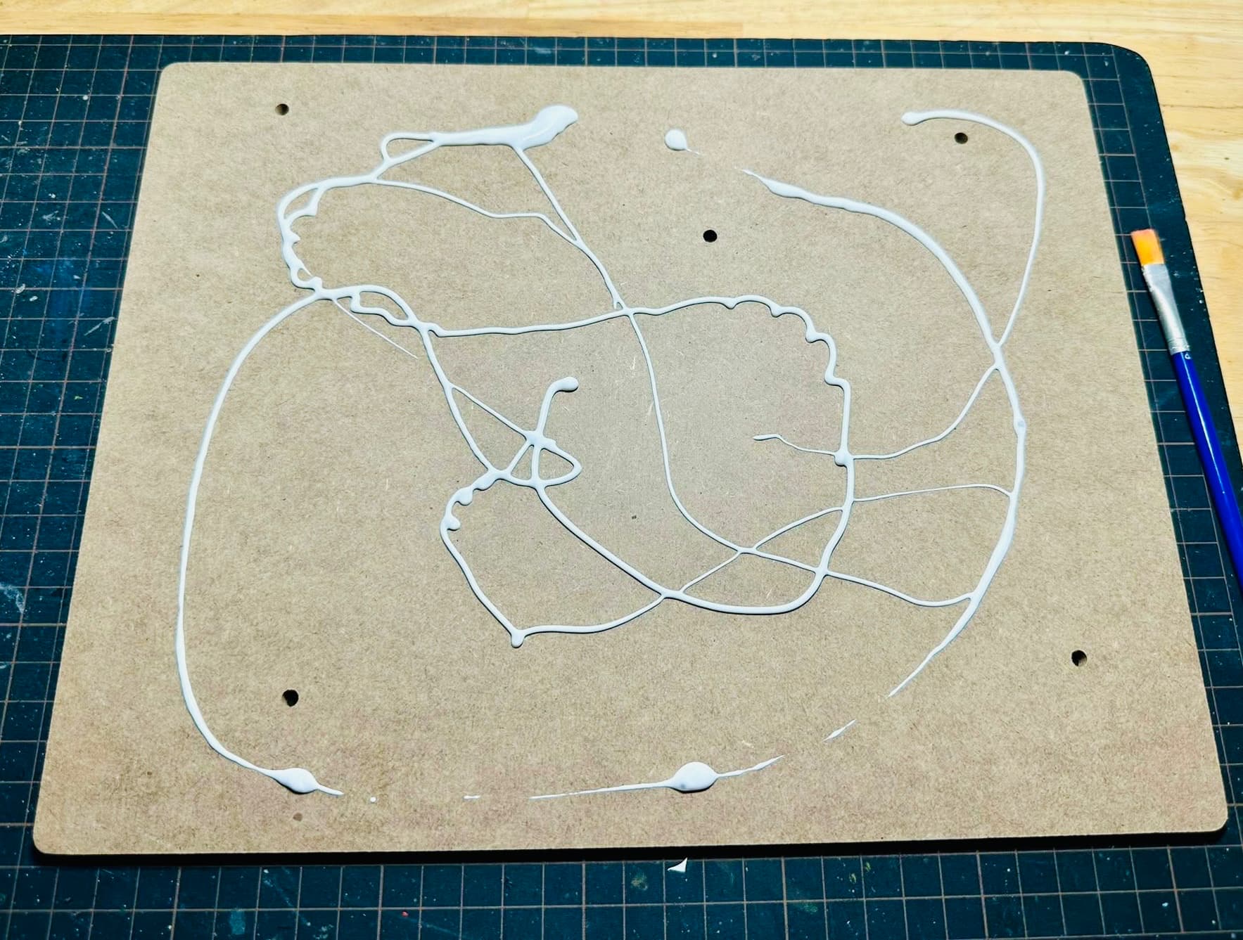

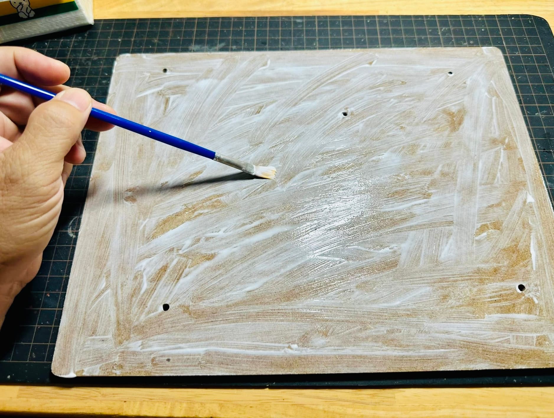

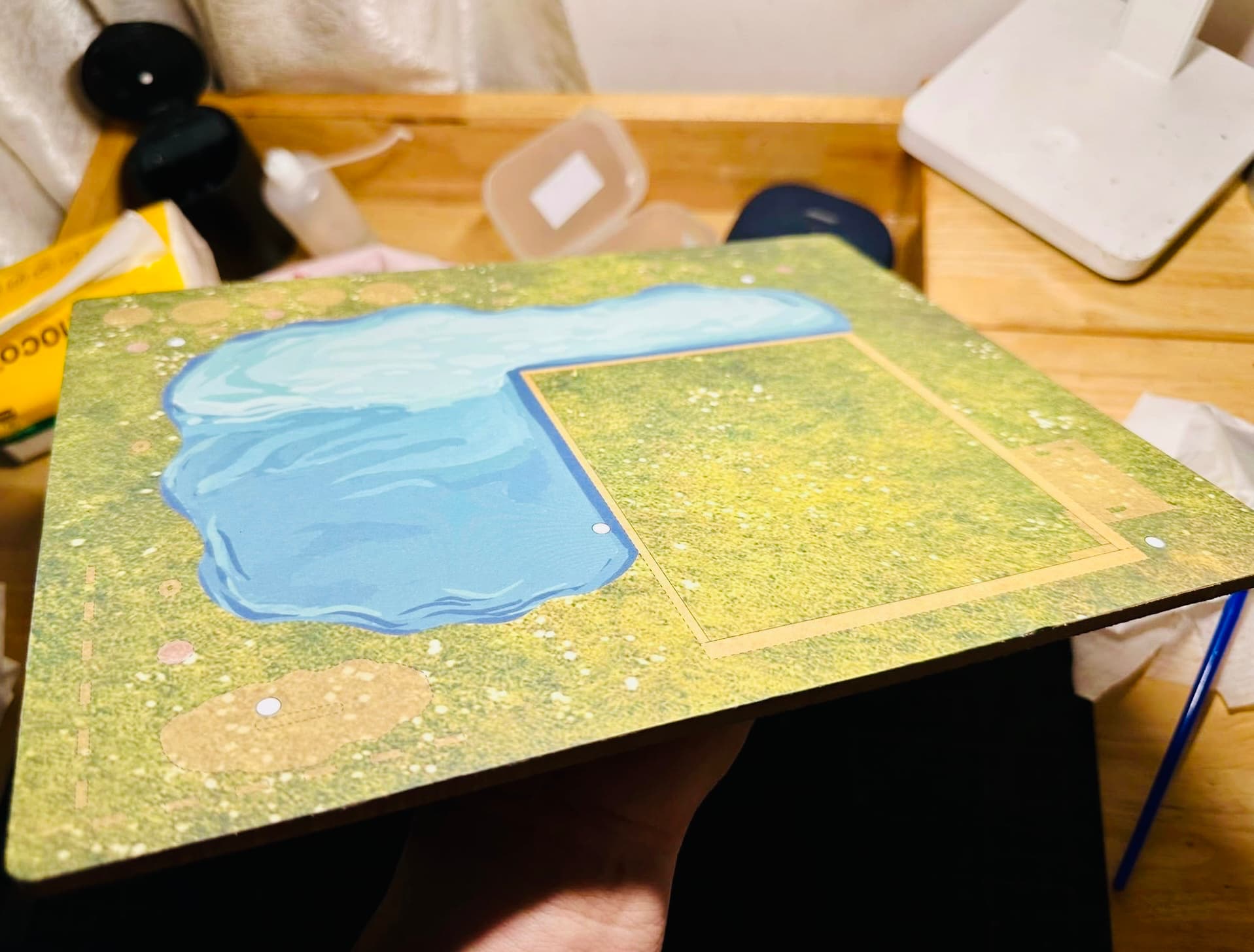

When sticking paper on walls, floors, yards or large areas. I use WHITE GLUE, use a brush to sweep the surface evenly, and carefully stick the paper on. Next, I use a dry paper towel to wipe and press hard on the paper so that there are no bubbles. The result is great.

School Glue :thinking:, Sounds super safe and not harsh at all?
just for example, i bought white glue but didn’t notice the word “school” :laughing:
I use either white glue or a glue stick, depending on the surface I’m sticking the paper to or its size. With a glue stick, you avoid the risk of bubbles and it works well too. (Can you tell I’m a teacher? I just stick to the materials I’m used to! :rofl:)
Thank you.I use many types of glue for many purposes, currently I am happy with mine :slight_smile:
